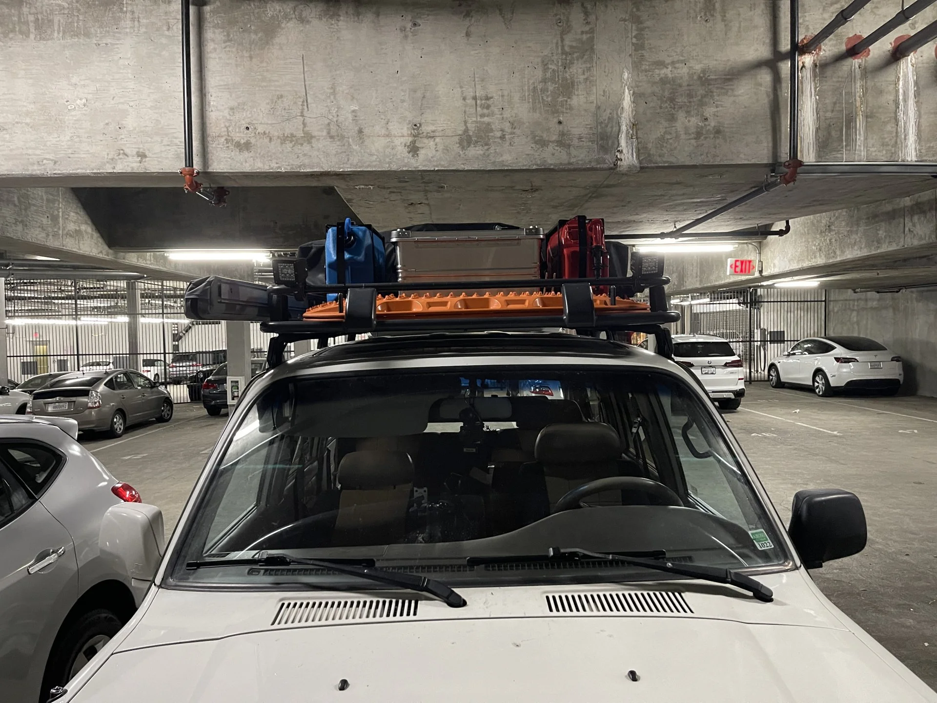

I went with one on each side just for symmetries sake. I tried a bunch of combos sketched out and for me this worked the best since I have the storage up there too. The double Jerry can holder was too large to place on either side of the box and it would have bothered me to have off centered accessories lol

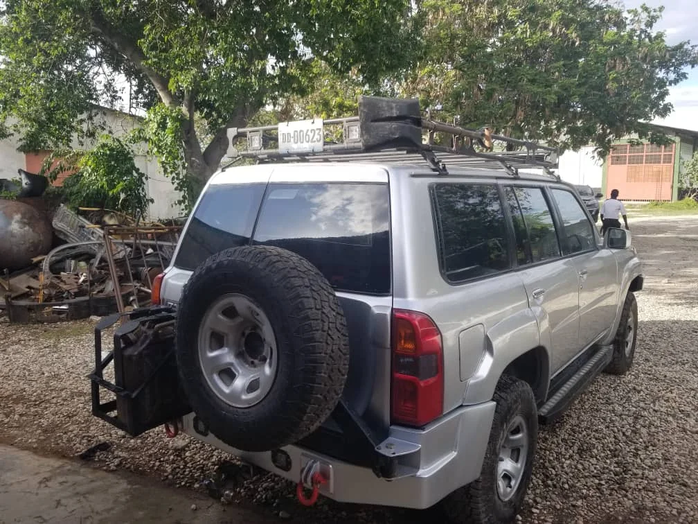

I kind of wondered how it would look up top . I guess looking at the pic it's not bad at all. I built one for a customer and it came out looking quite nice. The car it's on is not a Toyota so, I am not sure I can post it here. It also sits on the rear bumper. Here are 2 pics. Delete if not allowed
