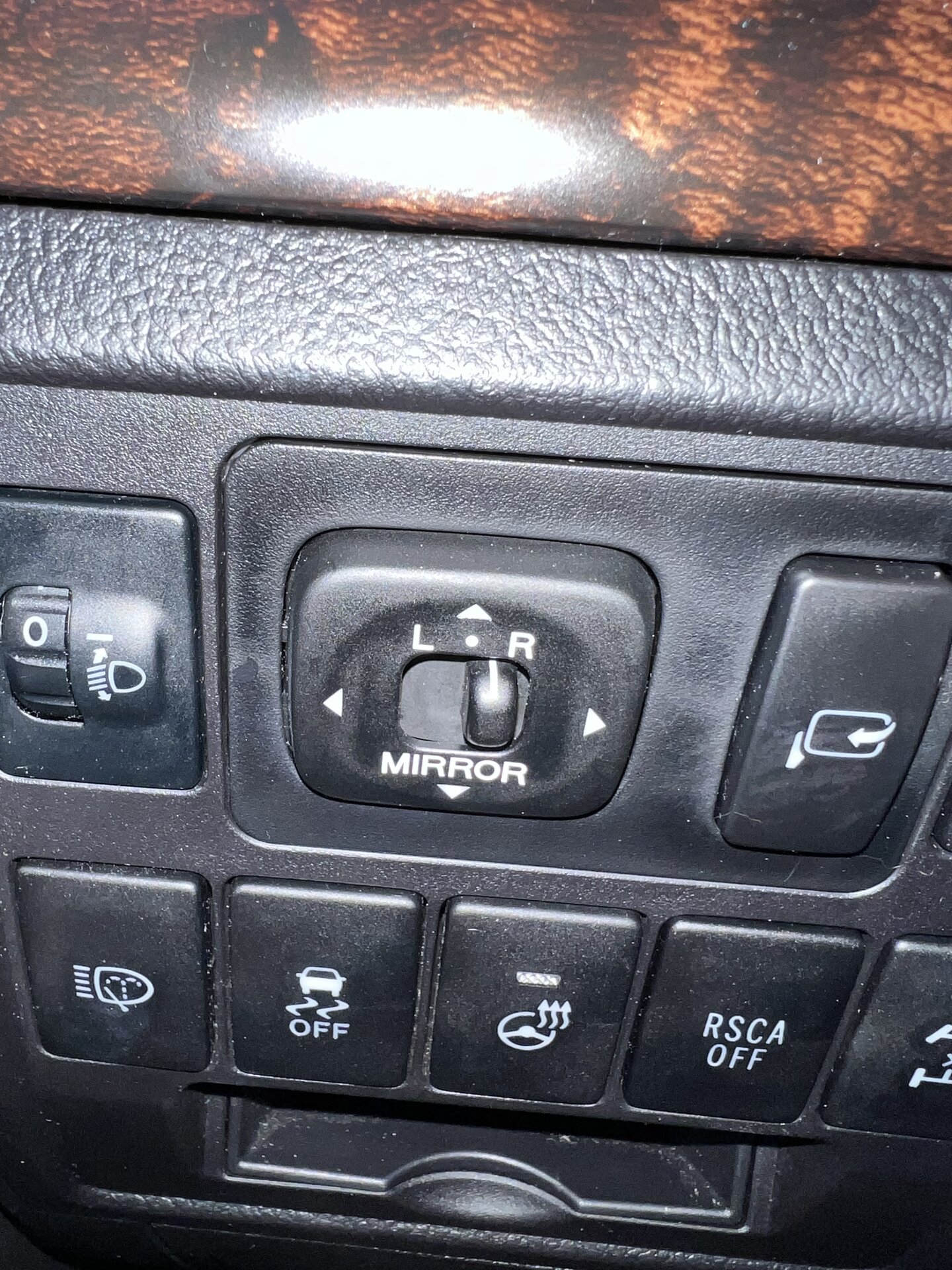

My wife drove my 200 yesterday and when i got in it this morning the side view mirrors no longer tilt down when i put it in reverse. I have turned the park assist on and off a couple of times and it still doesnt work. I really like this feature. Has anyone else had this issue. Is there something else I should check?
return the side view mirror switch to either the left or right side and the tilt down function should return.
