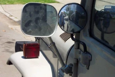

Move mirrors forward?
Hey, I just came across this pic...
attachment.php
Why don't people just move the mirrors forward like this?
Avoids the problem of the roll bar blocking, and you don't have to change anything when you swap out or remove the doors? What are the disadvantages of looking at the rear view mirrors thru the windshield? I can think only of 2 possible... first, pain in butt to adjust the angle of the mirrors, and second, is there more mirror image shake?
Doesn't seem like a bad solution? Anyone doing this? More pics please?!?!
