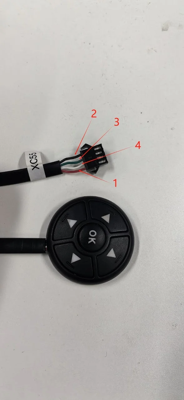

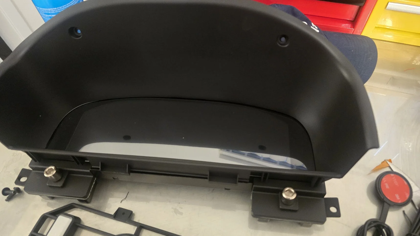

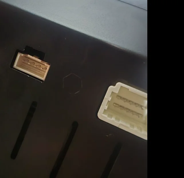

Installation was very simple and basically doing what you do to remove the original but in reverse. Two caveats. The controller for mine had no port and through back and forth on whatsapp, the engineer for their company helped me find the right wires to connect.

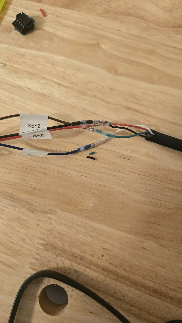

I spliced them up and connected both the USB port and control to the back of the head unit. I routed them out of the slot where the factory locker comes out of left of the steering wheel.
Sorry for the bad pic here but here's what it looks like. Plug and play.

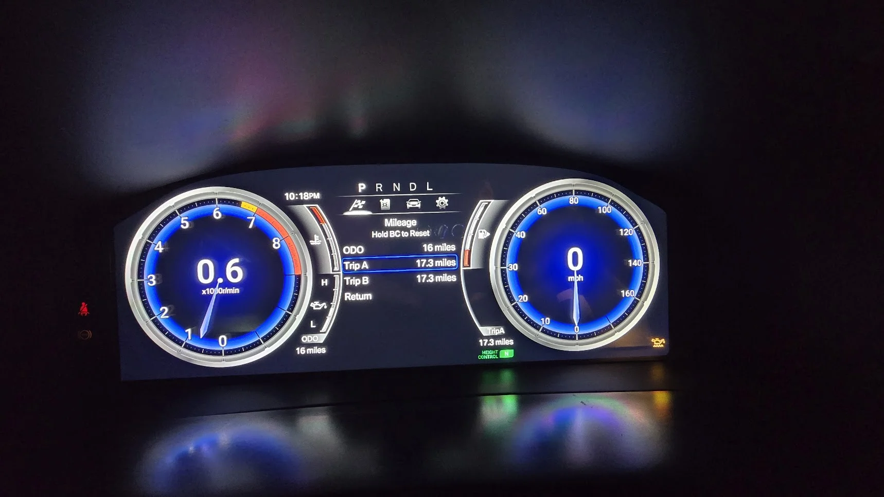

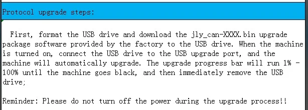

The screen booted up and looks gorgeous. Everything seems to work fine except for the VGRS light always being on and the coolant temperature gauge not working. I have some back and forth with their engineers and they create a patch file to address it. I can't attach the file but I do have it if someone needs it. The patch file resolves everything including the gear indicator
Continued. Here's the tape picture.

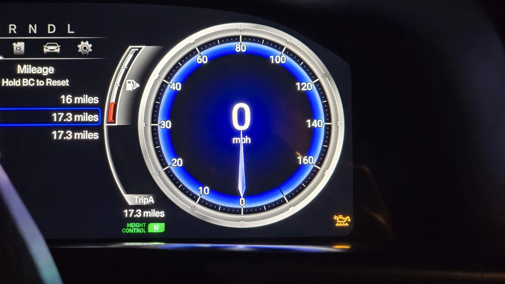

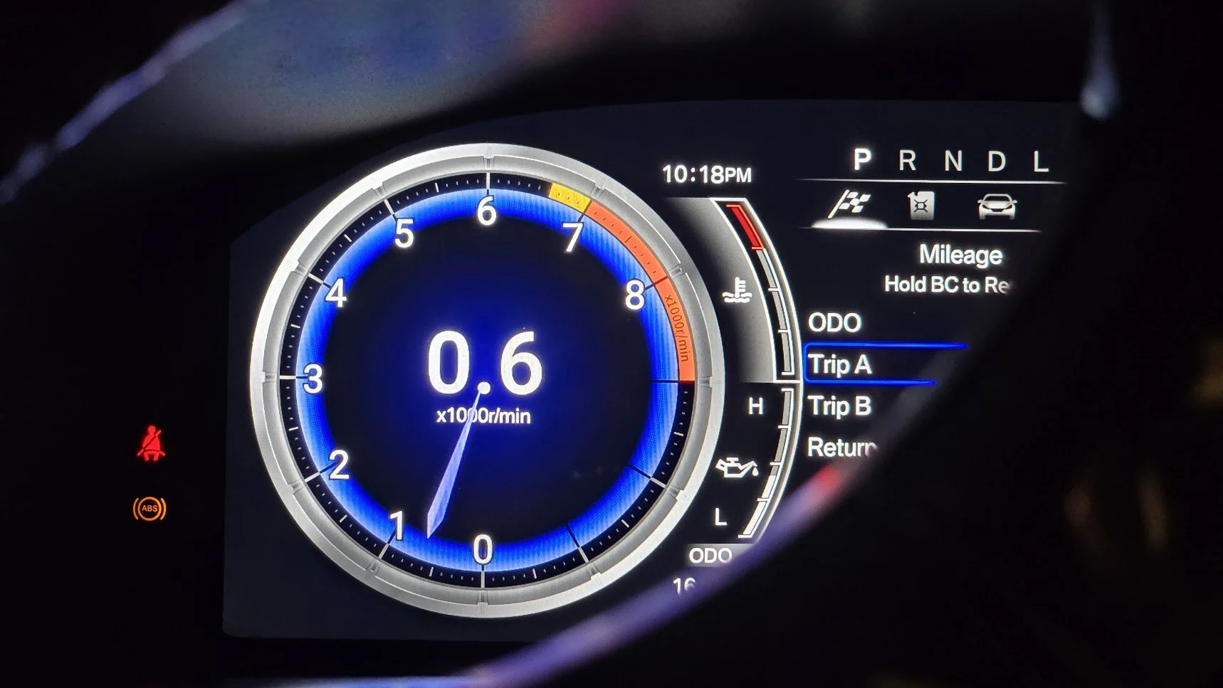

The cluster boots up and I think it looks amazing. I took these at night be warned.
I took a video if anyone wants it. The oil light is actually the light that comes on when you need to change your oil.
Some notes: To access the factory settings menu, the code for me was 0169 and I used this to change it from kilometers to miles per hour. I'm going to see if I can set the mileage tomorrow.
I love this thing and am very happy with it. Ask me anything.

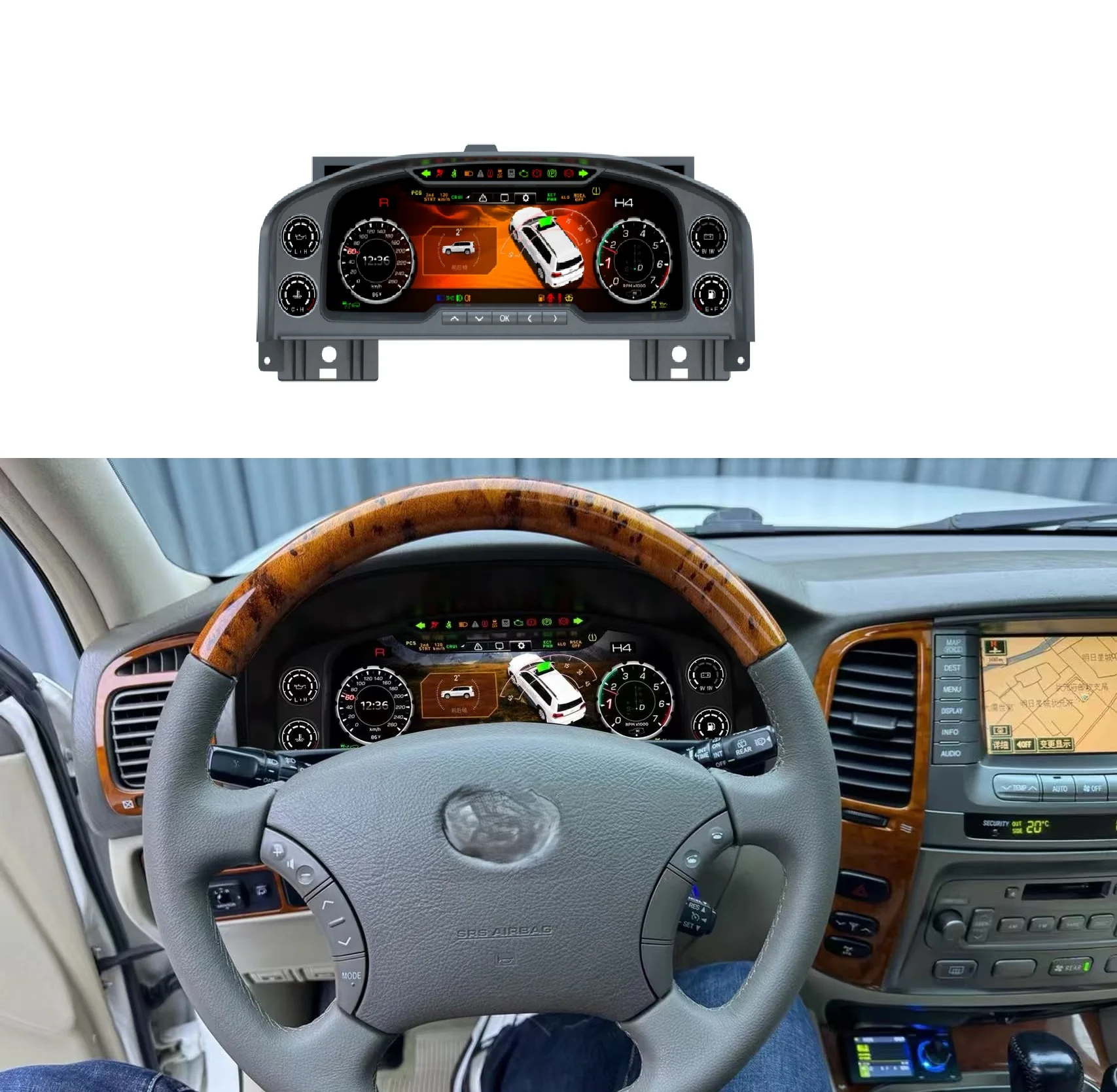

The link in the first post didn't work but I ran into this interesting cluster with map display capability.
Here's a new link. Someone asked me about it a while back but I forgot to update the post
That actually looks pretty cool
