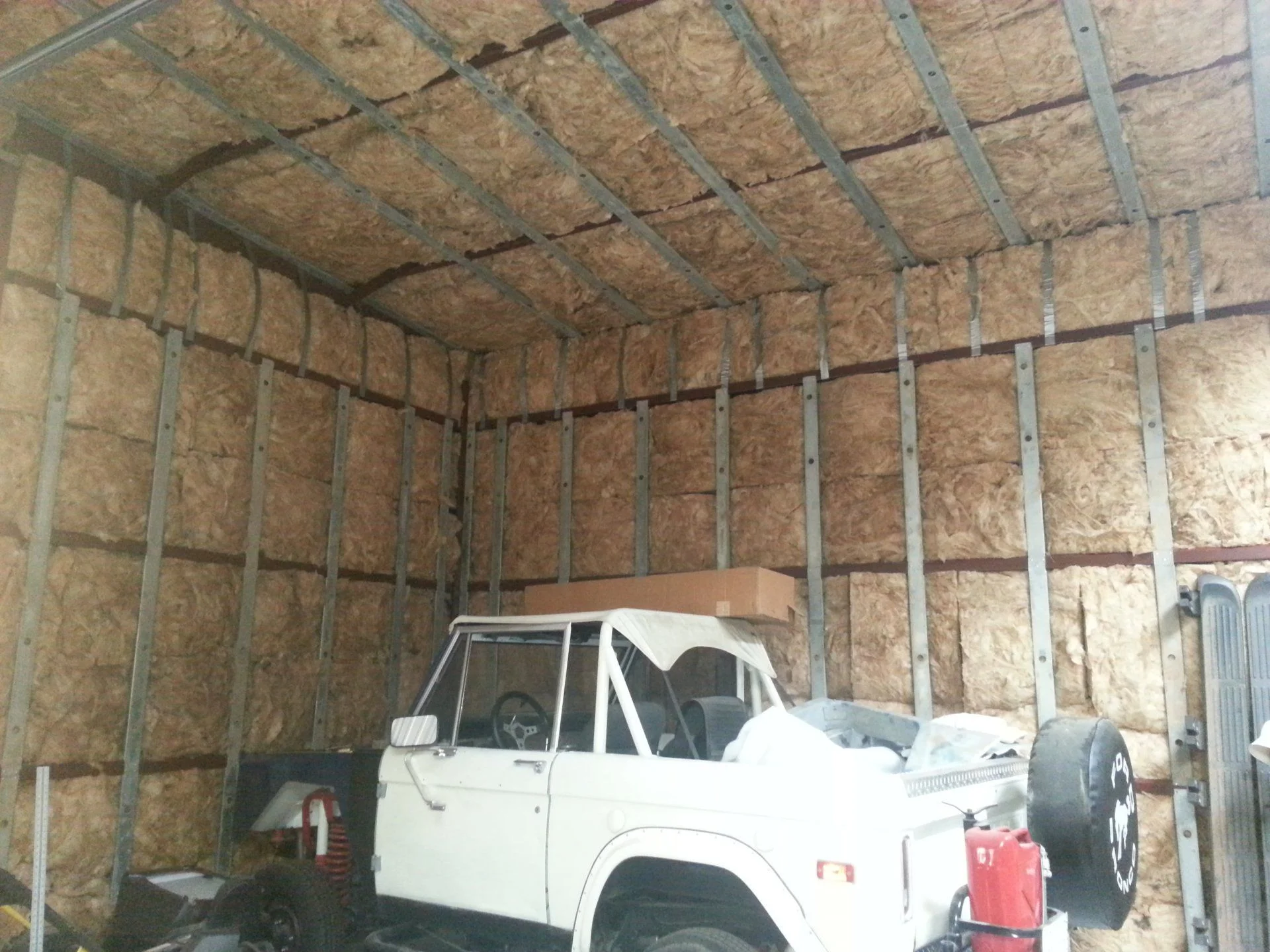

I looked at every metal building insulation option out there for mine and settled on R30 fiberglass bat.
None of the other options had any significant and proven performance other than sprayed in foam and that was just not in my budget.
My insulating project is nearly done, still have 3 roof sections to do and then the surface materials but the AZ summer just killed my functional work period. Should be back at it by the end of the month.

I have a buddy that used Prodex in his metal building, while its better than nothing, it does not come close to the comfort level of our metal building with R-30 (statically). The exterior color will also make a difference on how hot the building gets. Installation can be done done a couple of ways, we went with clips and wire 16" oc. with a scrim sheet cover. Being that your from AZ, I can tell you, this works very well whit the correct sized swamp cooler. We get 27-30 degree pull down most of the time during the summer months, slightly less during monsoon. Mild winters in Tucson, but it still drops down in the high 20's low 30's with the inside temps around 42-45 degrees. A 85K BTU propane salamander heater running for 10-15 min with the doors closed at the start of the day is all it takes to make it comfy for me. (I don't like to work with layers of clothes). Spend as much as you can afford to achieve your comfort zone. Don't forget your garage doors as they will transfer heat if not insulated as well.
