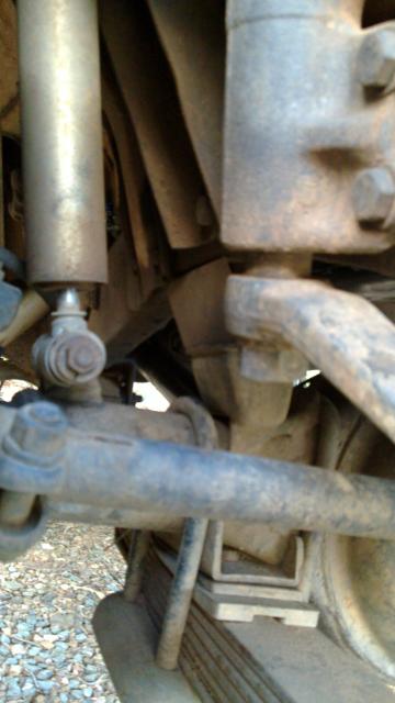

Ok so I checked my flex today for measuring the front shock length. Completely compressed is 18" and completely extended is 25.5"
I bought Bilstein 5125s without checking the travel the correct way and so i bought shocks that were too long and are easily bottomed out. So now that I have checked my travel the correct way, i have to choose my shocks. These are my two options:
10.17" Travel: 25.93 ext; 15.91 collapsed
11.00" Travel: 28.01 ext; 17.00 collapsed

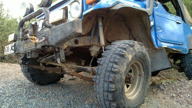

So the way I checked the travel was by putting one of the back wheels up on a lift and jacking it up until the opposite front tire was rubbing on the fender. So thats max compression, but i never got to test for max extended because the other front wheel never lifted up off the ground. (hopefully that made sense).
I am tempted to get the 11.00" travel shocks because it gives me more room on the high end because I didn't reach the max extended. On the other hand, I don't want to buy shocks that I will bottom out. I bought the 11.94" travel ones before (17.91" col) and they bottomed out pretty easily.
I feel like .91" won't make too much of a difference which makes me want to get the 10.17" travel ones so i have more room on the collapsed end...
Any suggestions? Advice?
Thanks
