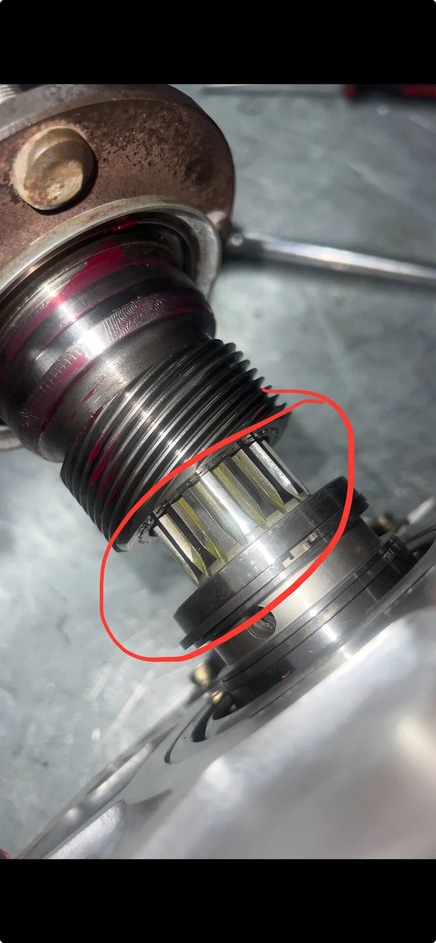

Shim set for transfer output shaft
Received the next two sizes up. Installed the bigger shim and it didn’t help nor did it have significant effect on preload. Weird.
After SAS I’ll rebuild the TC. But before I will take a sneak at the thrust washer on the idle gear. Make sure it’s not spinning on me.

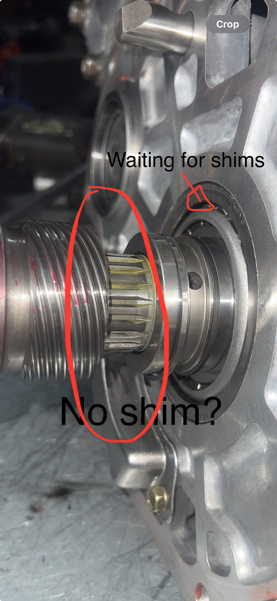

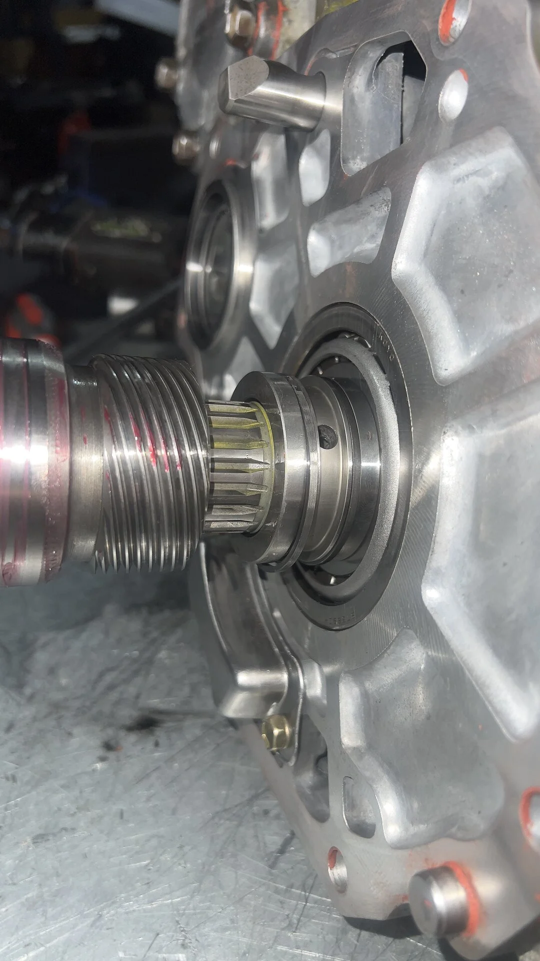

Any update on this? I just started rebuilding my part time transfer but the preload with new bearings is way too tight, even old bearings it was still tight but waiting to see if the local Toyota have any.

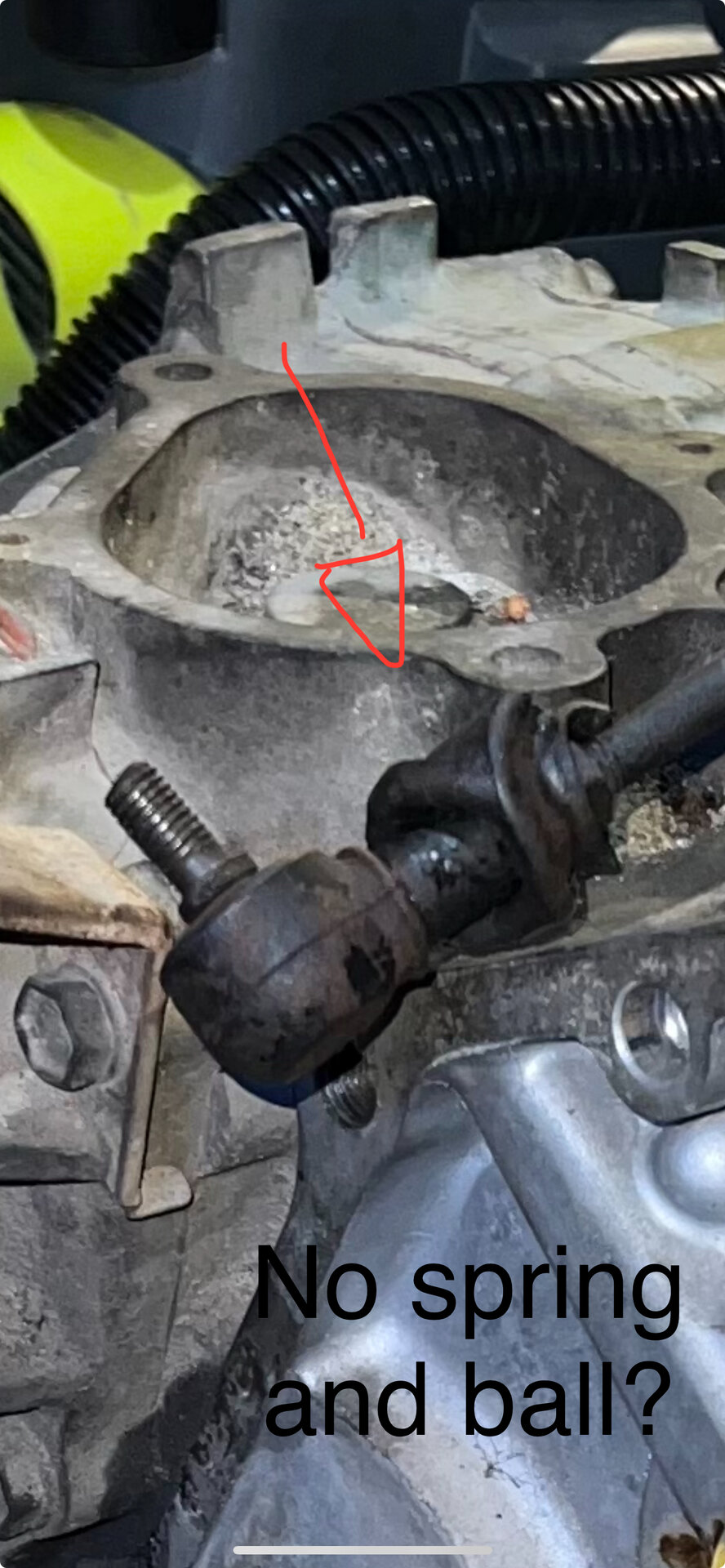

Also didn’t find a spring and ball in the top part and didn’t have a shim behind the speedo gear? 🤔

I got the part numbers from amayama diagram and ordered nearly half the set, every second size, from both amayama and local toyota dealer. The things you are missing are needed.

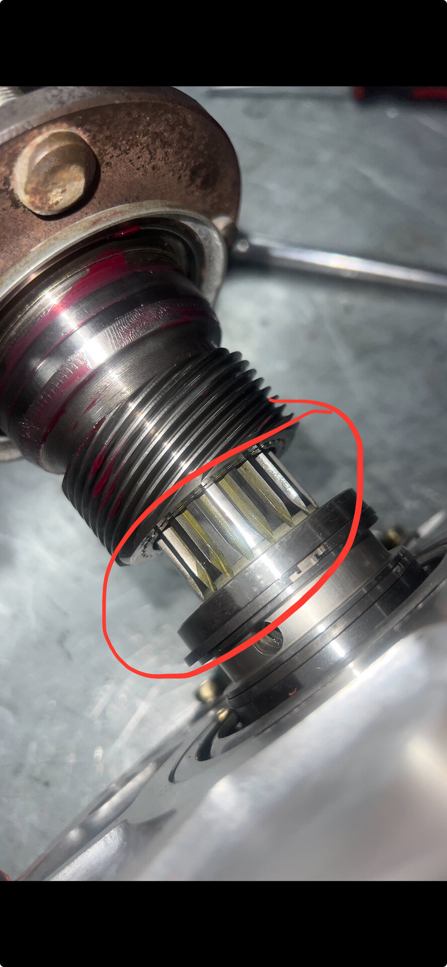

I can’t seem to find this shim?
Managed to find the output shaft bearing shims, non available in Aus so going to try source elsewhere before ex Japan
