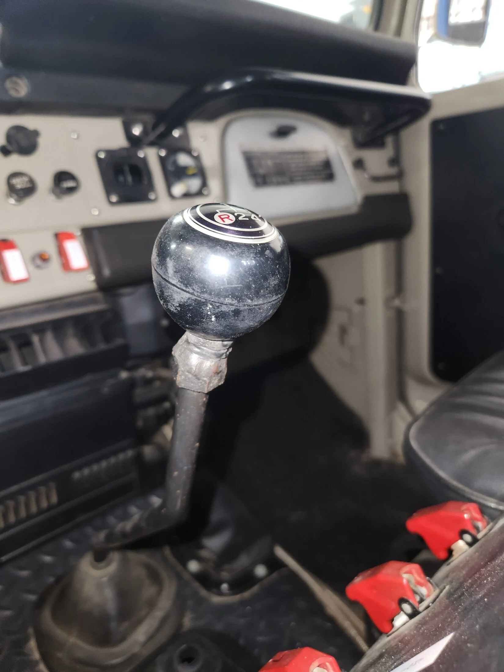

Okay, I feel like an idiot and searched to no avail. I need to install a new shifter boot in my 77. How does the knob come off? Is a compression fit or threaded? Mine looks like this. It will spin but it doesn't raise off of the lever. The knob looks like a replacement and the bits below look somewhat buggered up.
Looks to me that the ball is JB Welded to a fitting. Use a wrench that fits the fitting and unscrew the fitting lefty loosely. Or try and pry up the shift pattern plate with a little screwdriver under the edge, then un screw what is under it.
Looks like a bend outwards to clear switches on a aftermarket console. The piece below the knob looks hex shape. I would use a wrench on that and install a new knob.

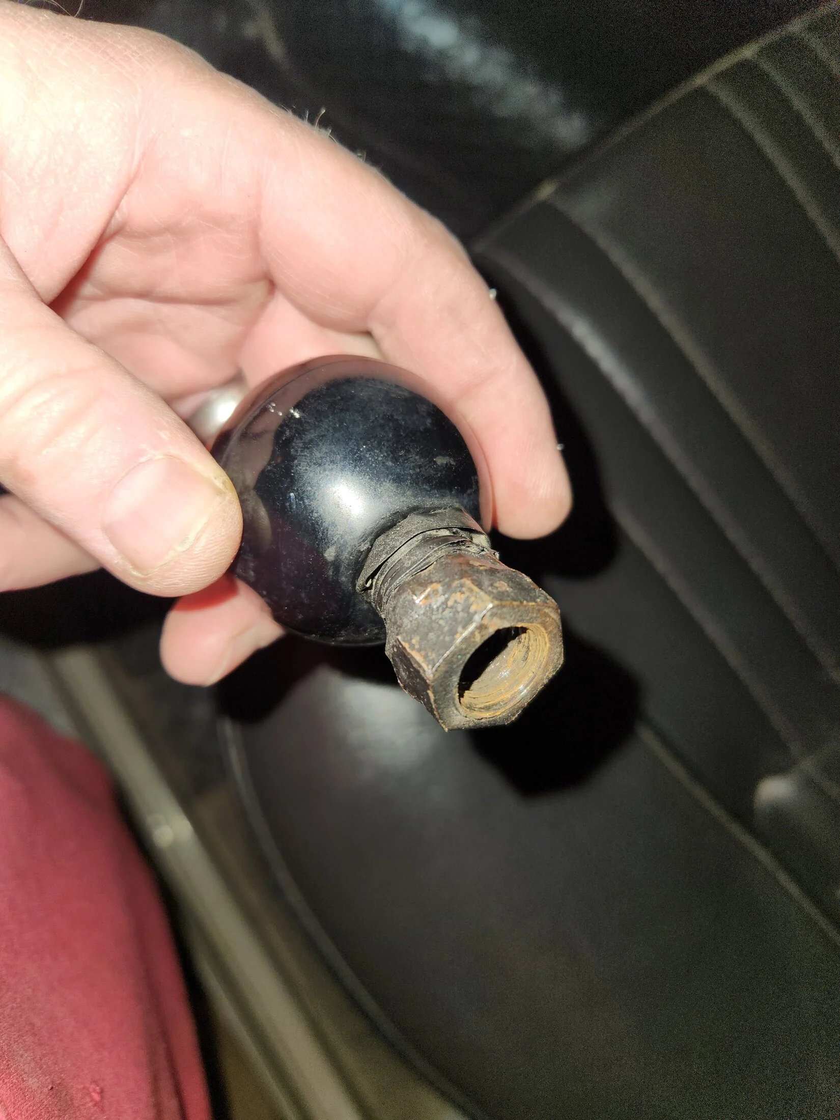

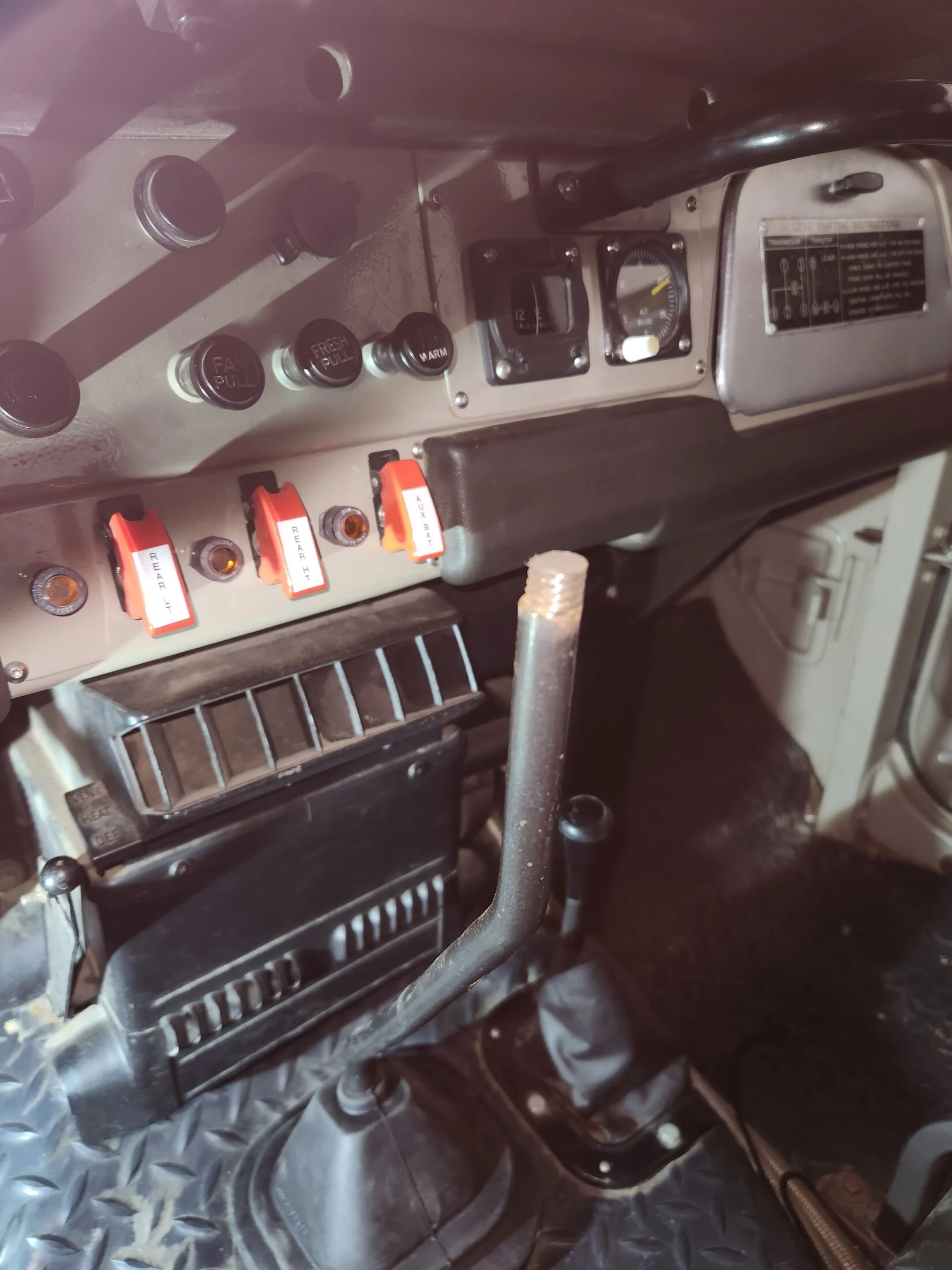

I was able to loosen the nut, the rod is threaded. New boot and all is well.
is that electrical tape wrapped into the head of the ball for interference?
I think so. As long as it doesn't come off in my hand, I'm going to call it good for now :rofl:
