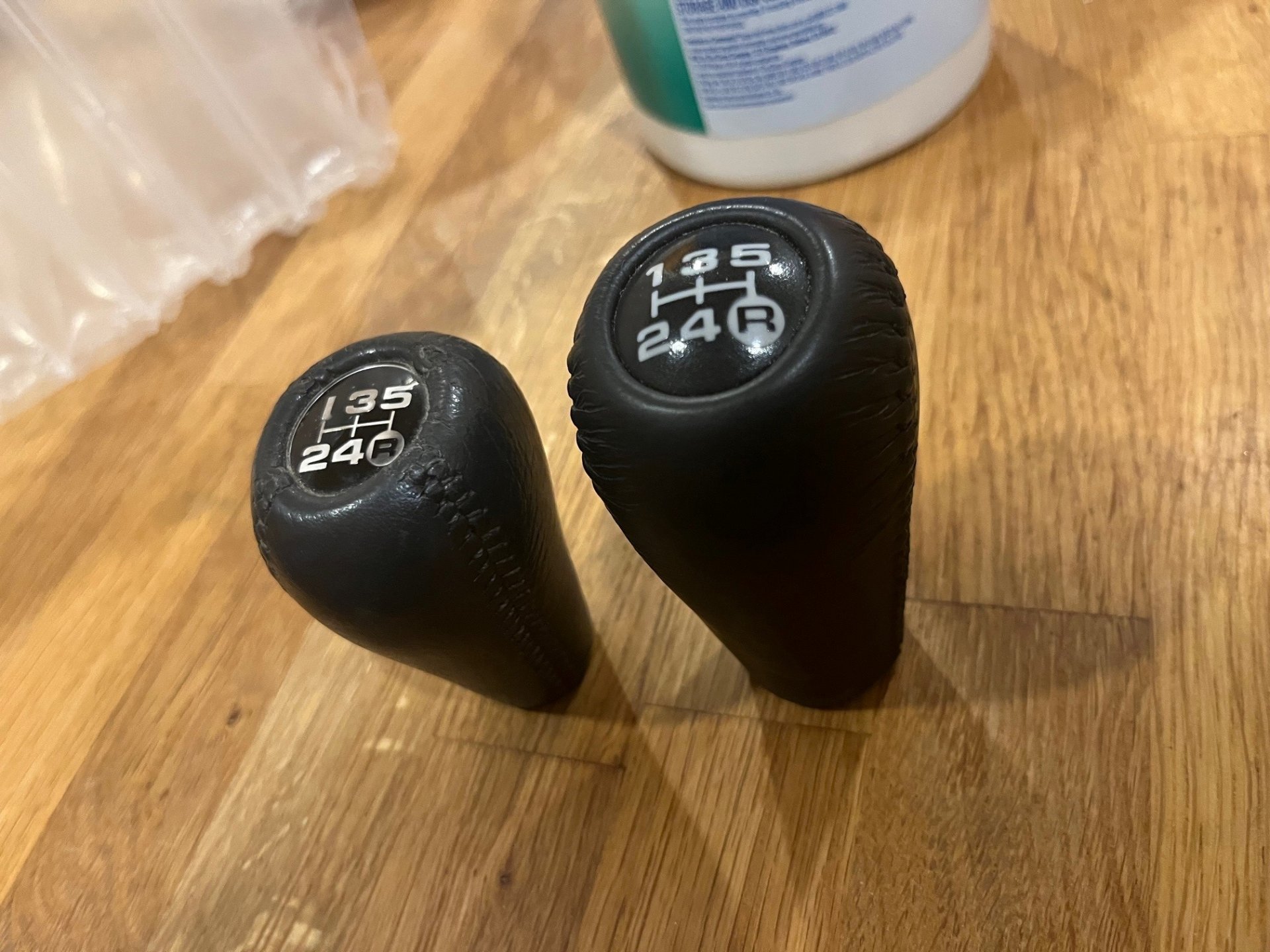

Not sure which one you are looking for but the 80 series version easily replaced my original version. H55F here. (HZJ77)
Mine came from this ebay listing. NEW Genuine OEM Toyota Leather 5 speed gear shift knob Land Cruiser 1990-2007 | eBay - https://www.ebay.com/itm/272048885523
Original vs. New comparison. I kept the old one and put it away but honestly don't think I will ever return back to it as long I own the cruiser because the new one is way better.
