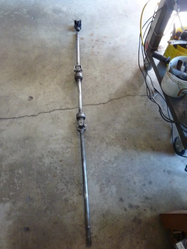

I also believe that it’s the same seal for the PTO front and back shaft. If my memory is correct 🤷‍♂️.
I used 90311-35004 for both ends of the PTO gearbox, which does not cross reference to the 90311-28003 for the winch The seals may be interchangeable.
