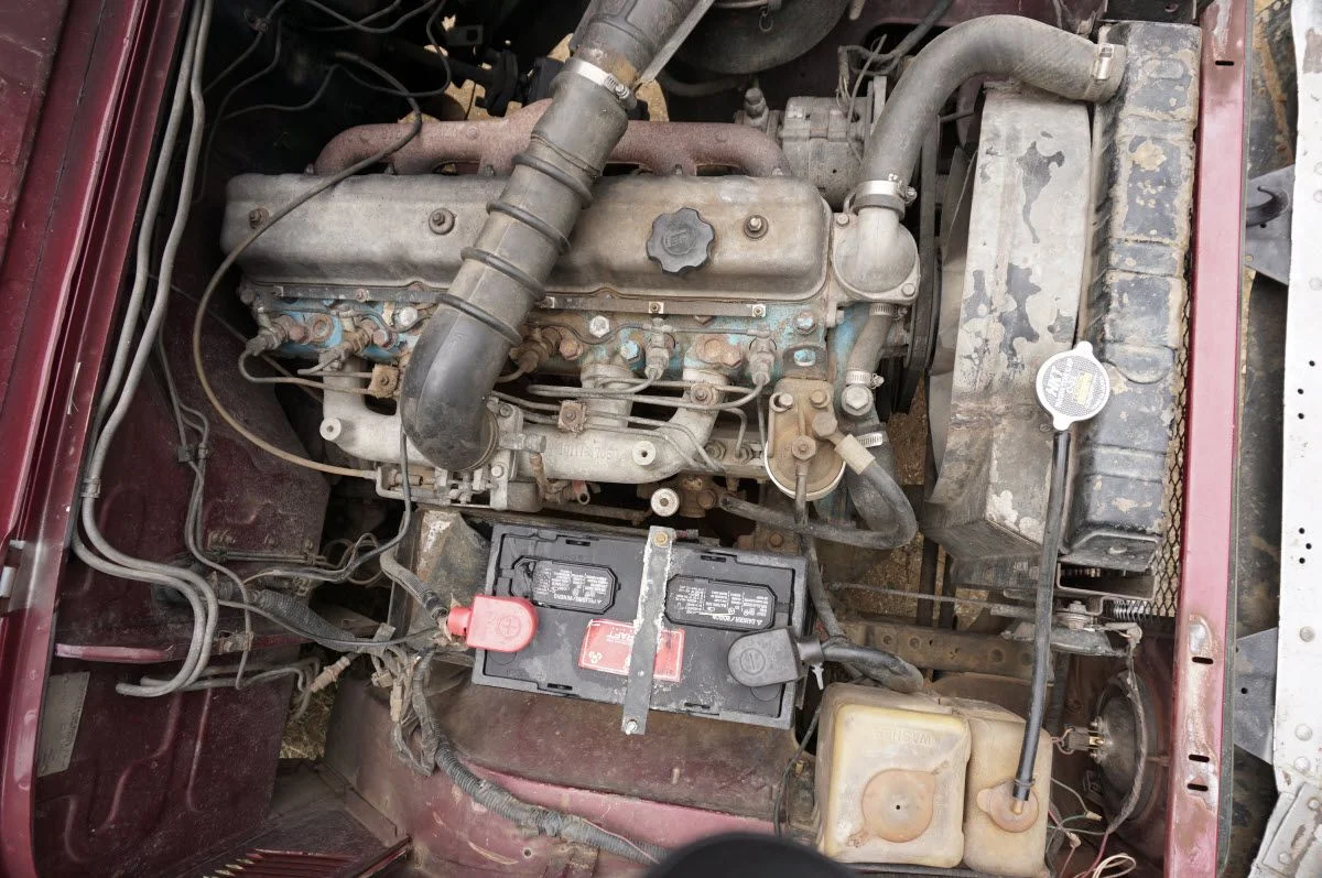

Here is one that I snapped the other day. I would love to know which engine this is.
Also, another engine I saw has a "B" on it with no numbers in front of it. I know that there are engines that could say 13B, etc. Anyway, help is much appreciated.
In Land Cruisers, Toyota put the B, 2B, 3B, 13B-T, and a couple others from that line (4 cyl)
The one pictured looks like either an H or 2H. There is also the 12H-T, 1HZ and HD variants in later models (6 cyl).

Here is one that I snapped the other day. I would love to know which engine this is....
Looks like a 2H to me. Edit: No. More probably an earlier H -engine on second thoughts.

I edited my earlier post towards thinking that other engine is an H diesel (rather than the later-model 2H) .... but I could still be wrong there.
As for the second engine ..... Same deal... I think it is another H (which is an early six-cylinder Toyota diesel as used in Land Cruiser HJ45 models).
The B-series engines have their injector pumps on the left whereas the H-series have theirs on the right.
And I'm saying H rather than 2H based on the design of the leakage piping connecting to the injectors.
