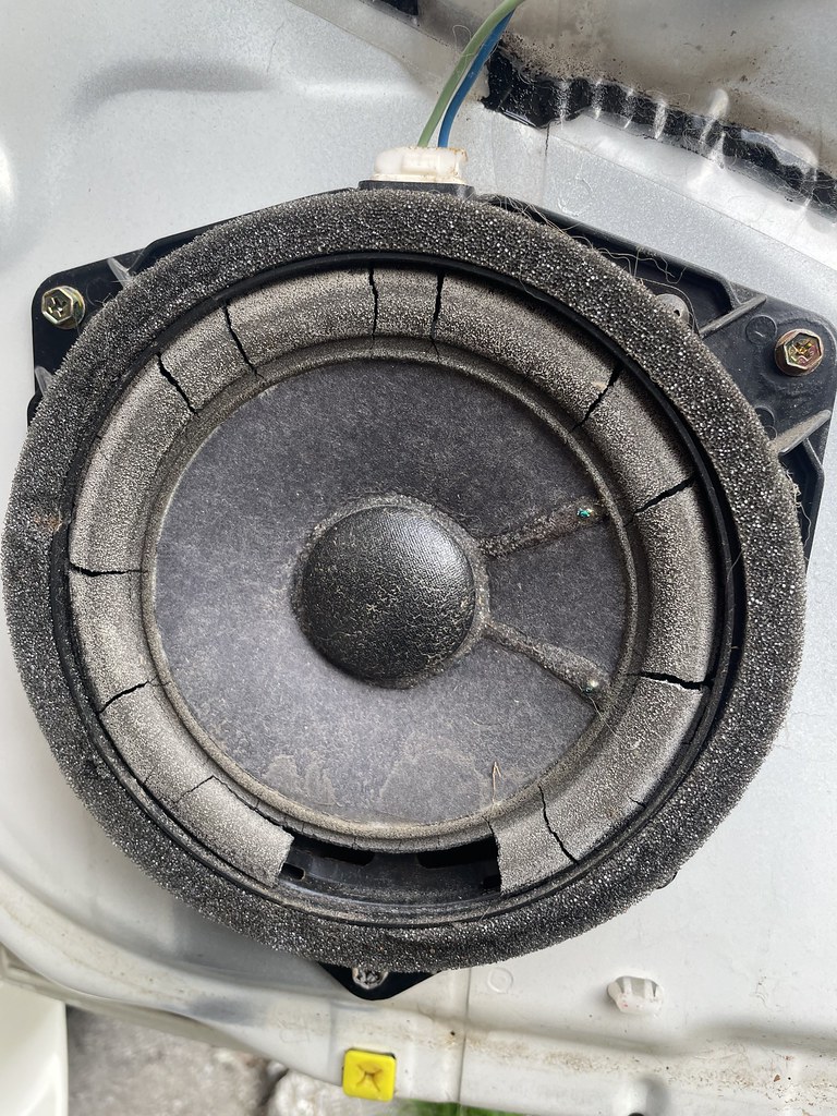

I went though this on my GX470 with ML speakers. All the rear sub needed was a Simply Speakers re-foam, which was quite easy to do. I had purchased a SKAR sub and but returned it as IMO it's a downgrade from the OEM ML sub.
However the front lower door speakers (which are 6x9s in the GX) were trashed. Foam was totally gone and they just looked rough. They got replaced with Power Bass 8 ohm speakers. I also replaced one front tweeter with a new OEM ML tweeter from Lexus. All other speakers are stock. The system sounds great.

The SKAR is a Chinese sub. Here is my OEM sub at 19 years of age. Other than the two small tears, it was in perfect condition. On a GX you have to spend hours modifying the sub enclosure to fit a SKAR, so re-foaming the ML sub was much easier. If the SKAR is a plug-and-play replacement on a LX, it would be more attractive.
I'd suggest having returnable speakers on hand and the Simply Speakers kit. That worked pretty well for me as I was able to pick-and-choose what got re-foamed vs. replaced.

I did the simply speakers repair. Sounds perfectly new again. Each speaker including sub had varying degrees of being blown.

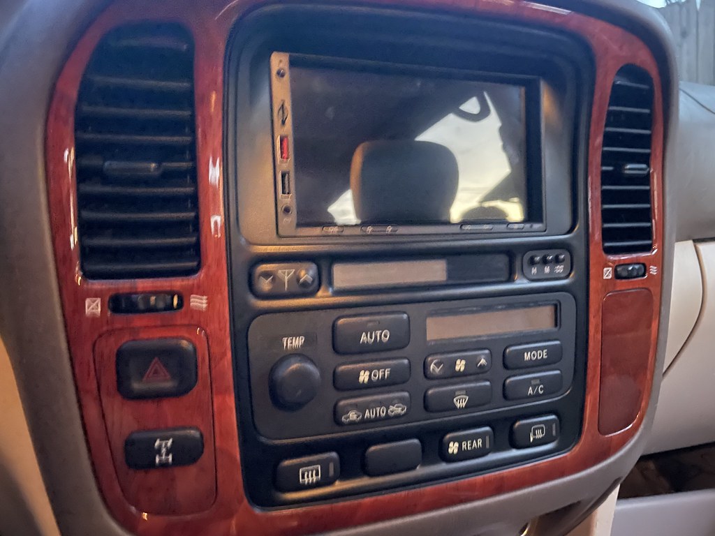

I have yet to install the speakers (so many projects; so little time), but after a lot of reading/research I purchased the following for my '01 LX with Levinson system. Big magnets on those replacement door speakers. It's quite possible that I'll need to do some minor mods to optimally secure them in the doors. Head unit and bezel installed and works and looks great. I did start the speaker replacement job and all the speakers are toast. Only pic of the head unit I found on my phone is awful (out of focus) but, while having a relatively small screen, it looks great.
2 @ 4" DA RS100P
2 @ 6.5" DA DS175-8
Skar 6.5" sub referenced within this thread
DSP (brand?) head unit
Bezel
Metra TYTO-01 harness
Antenna adapter
I also installed an antenna Y splitter (don't recall where I sourced that)
Untitled by ColonelJLloyd, on Flickr
PowerBass makes 8-ohm speakers as well, as does DS18. The actual speaker re-foam itself is not hard at all, but it is more work than a true plug-and-play replacement, and you need to let the speakers dry overnight before re-installing. I'd budget about 30 minutes per speaker of scraping off the old foam with a razor blade, cleaning the cone and plastic surround with some rubbing alcohol, and gluing on the new foam.
I’ve always reinstalled the speakers after an hour per the instructions. I do let them sit overnight before using them though. Since I’ve done it a few times and have a proper X-Acto kit to make scraping very easy, I find that removing the door panelis actually the longest part for me. When I bought the kit, it was about $50 and took care of five of the seven speakers (for some reason it doesn’t include the drivers in the front door, but those can be ordered separately). It really does sound like new again.
I let the sub sit overnight as it's a PITA to get it out (as I have drawers that need to come out), but perhaps it was a bit overkill based on your experience :). Glad to hear it's doable with only an hour. Overall, super-happy with my re-foam as well. I really think the ML speakers are top notch with how well they sound at 20+ years old after putting a few dollars of foam on them. I've had aftermarket speakers crap out after only a few years before (Kicker and Polk speakers), so I'm not sure many of them will last as long as the MLs do.
