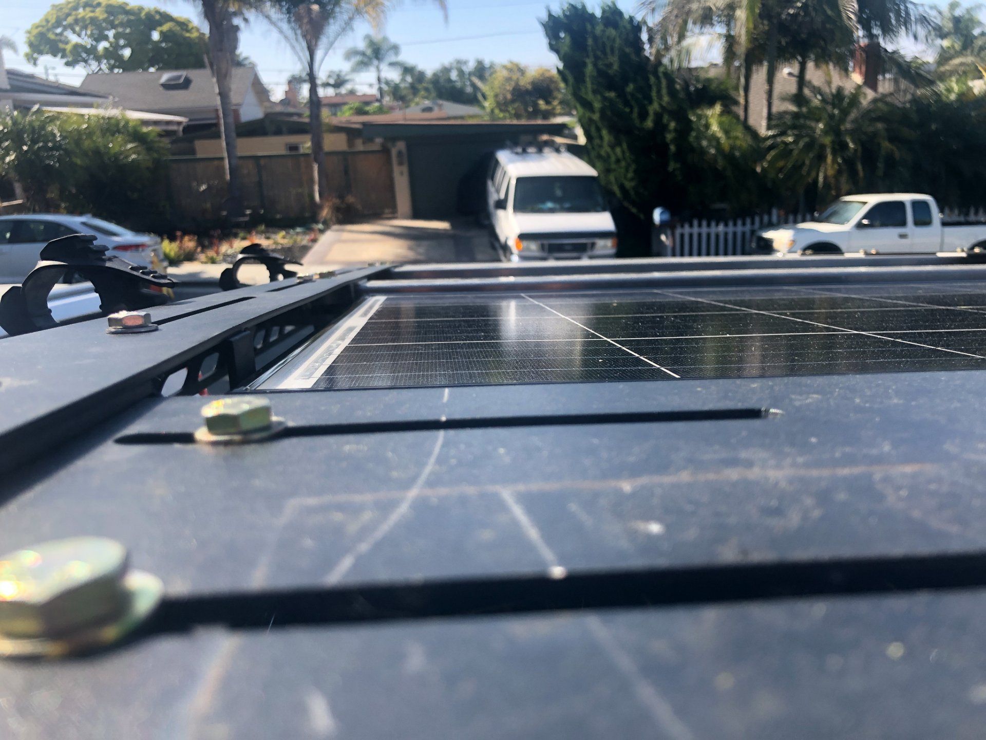

Theres a lot of info on this site, and discussions tat ultimately go in circles. What has worked for me is upgrading my main battery to an odyssey extreme which gives 100 ah and changing the fuse for a higher charge voltage. Additionally, I added a 100 watt panel on the roof to give the battery a higher voltage charge experience which the agms like.
Like you, main use is dometic fridge and cell phones.
I like that its one battery, dont have to balance two. The charge voltage is a problem, but thats the problem I've chosen to deal with instead of the others. Bonus is the solar will pretty much run the fridge indefinitely, so longer stays in one location and sitting in the driveway for long periods are no problem.

I think those portable ones are really prone to failure. You aren't the first person I have heard have such experiences. I have had and helped with probably 6 or so Renogy panel setups and all have stood the test of time. Obviously permanently mounted solar is a committment that probably many don't want to make for a variety of reasons. But for this application it serves its purpose.
