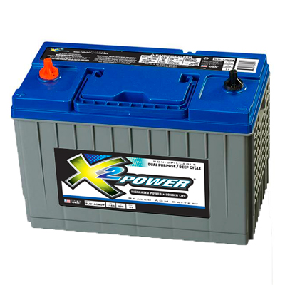

I considered just doing a single battery setup also. I already carry a jump pack. When it warms up a bit I'm going to make up a cardboard box with the same dimensions as this battery SLI31AGMDP - X2Power Premium AGM Car and Truck Battery at Batteries Plus Bulbs.
