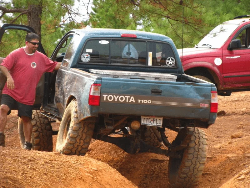

Looking for guys who have done the swap and not gone huge. My daily driver is in need of a lot of front end work and considering just doin the swap but I’m not into ladders to get in the cab and tailgates too high to use. Any pics and info is appreciated, thanks guys.

From Google:
1904382
I’m picking up an fj80 axle this weekend for a hopeful future swap from what I’ve found most of the guys that have done this did it long ago and don’t reply anymore. I’m hoping I can keep it low but big enough to run 35s.
From what I have read the Chevy Dana 44 is much simpler to swap but I’m definitely interested in how it works for you. Why did you choose the 80 axle?
I had a line on one for cheap but decided against it for now because of to many projects already and a baby on the way so moneys tight. The reason I had picked the 80 axle is the availability of parts, it's a passenger side diff just like the t100, I already have a set of springs from an 80 I was hoping to use to keep it low and seems like in stock form they are a bit more beefy than the 44. If I don't end up with a SAS then I'll eventually go to LT. Either way eventually the front end will be receiving major upgrades right now im not happy with how much it wanders for how much I've replaced and the ride is really pretty rough for no TB cranking with BJ spacers.
