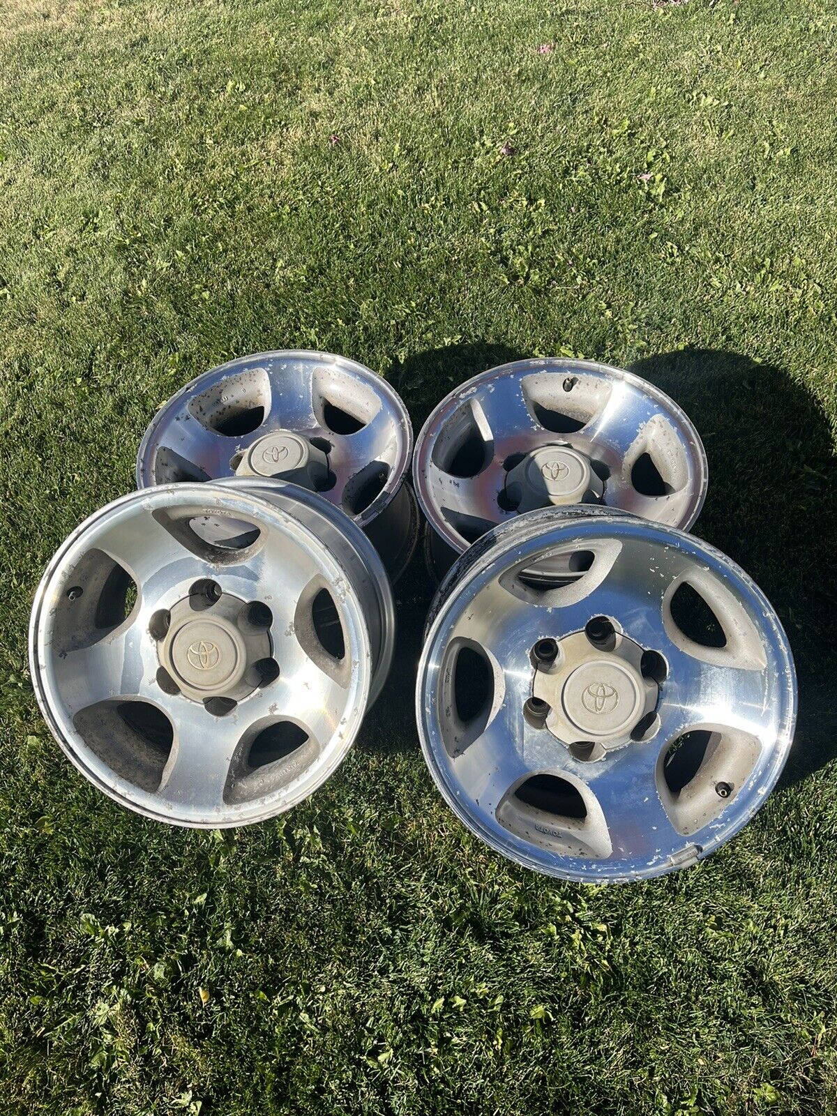

Hello everyone. I'm looking for Hub caps that fit these wheels. They are on a 4runner and I don't know what year landcruiser they came from. They use acorn style lug nuts. Just from a basic Google, factory caps are pretty expensive from what I have found so I will probably try and find an off-brand if I can?

If they have the acorn style lug nut (tapered seat) then they are from 1993-mid-1996 Land Cruiser.
Most 1996+ have the shank style lug nuts with flat seats.
The hub caps will work from all 1993-1997 Land Cruisers on those wheels. Or, if you really want to dress it up, you can get Lexus LX450 hub caps.

From what others have said, the caps you actually get aren't black. Instead they're like the ones in the post above.
