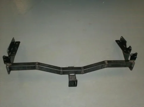

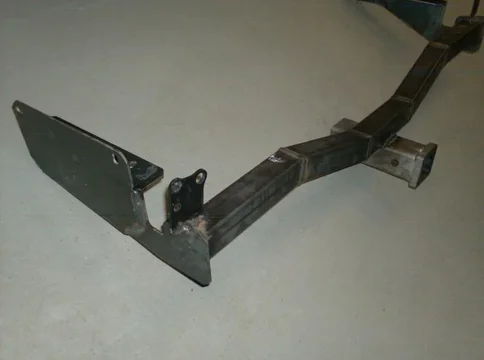

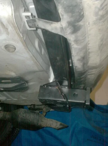

Here is the finished hitch minus a couple of gussets and some holes to hook the safety chains to. I don't have any material here at home to make the gussets so I'll wait till monday after work to add them. I've also decided to throw another $30 or $40 bucks at it and get it powder coated - no sense in having a rusty old hitch on a new vehicle.
A few more...

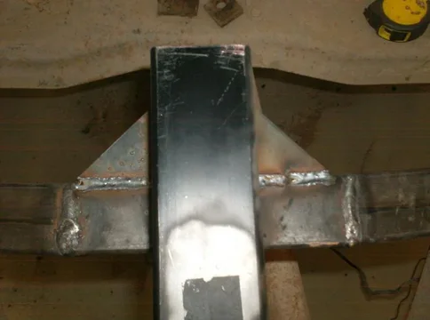

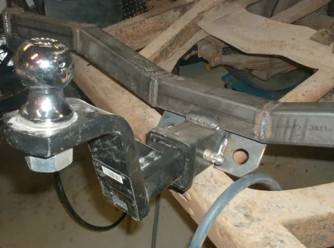

I made some gussets at work to help firm things up a bit...
And a couple with holes for the safety chains....
The safety chain gussets are too large (I made them from memory) so I took them back to work and sheared them down a bit.
And back at home welded them in place...
I'm going to take the whole thing to work tomorrow and clean it up a little before sending it out for powder coating.

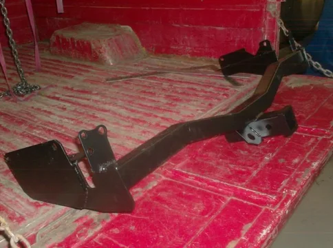

Powder done. Black is in this season....

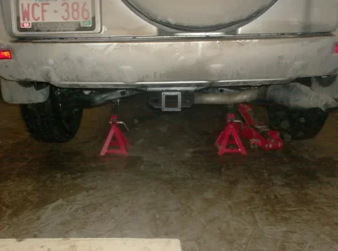

And some installed pics.
more...
The M8 bolts in the rear on the "black brackets" that I chopped were very difficult to install. I knew this going in and had every combination of driver, extension, socket and universal I own at the ready - still tough. In fact, I couldn't get the left side ones in at all, I ran out of time tonight. I'll have to loosen all of them and mess with it on the weekend. It's not falling off with nine M12 and three M8 bolts in tight! The muffler hanger is disconnected in this shot - it mounts higher than shown here.
The hitch is fairly well hidden

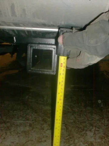

Center of the receiver is at just over 12" off the ground
