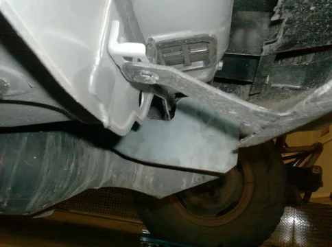

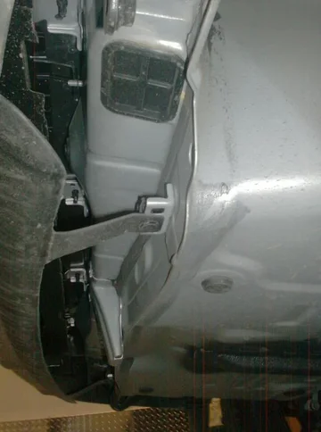

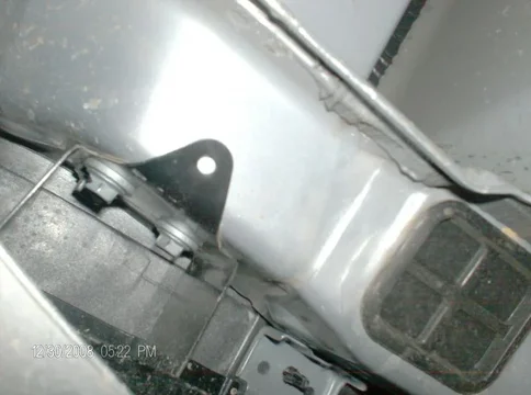

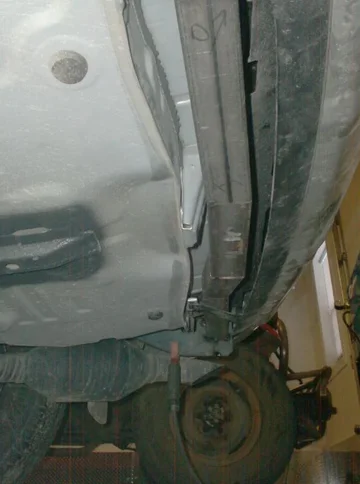

Another point of attachment is this black bracket with two nuts welded on it. It holds a steel energy absorption inner bumper that sits behind the painted facia. The three bolts holding it on are going to be used to anchor my setup. You are looking at the left side of the vehicle from underneath and the three bolts go into the end of the frame rail.

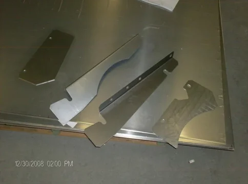

So the other day I dropped by work (the shop is shut down for the holidays) and made some test pieces to fine tune my design. I made them out of 14 Ga. steel because it is easier to work with than the 3/16" plate the final brackets will be fabbed from.

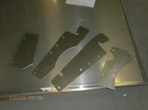

After a ton of measuring and a couple of cardboard templates I sat down and drew a CAD copy of the cardboard templates. Then I used SMP/IS software to write a G code CNC punch program....et Voila, steel copies of my cardboard. You can see now why I'd just as soon make it myself as buy it - the projects floating around in my head are endless, it's really a curse having all these tools and material at my fingertips, really........:o
Shaken out of the blank...

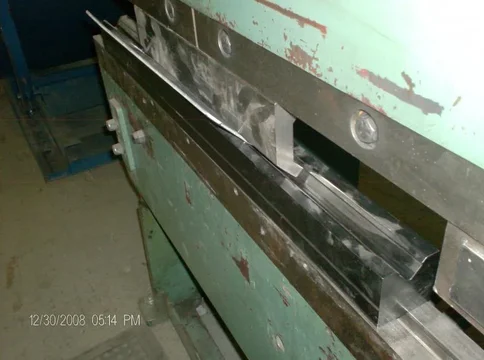

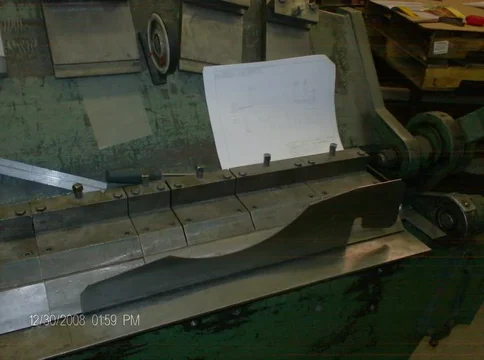

A quick bend on the hand brake
More pictures...

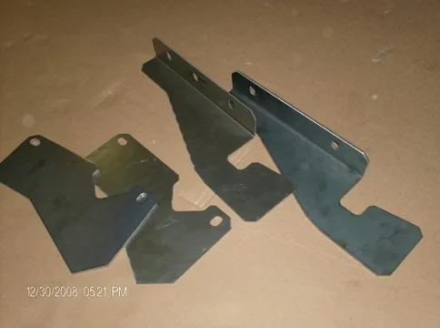

Here they are bent.....

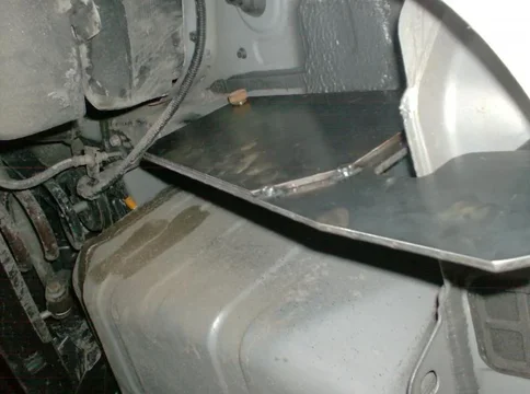

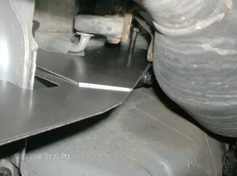

The left bracket test fit...
The side plate... bolt holes not quite right
The right bracket test fit... loosely fitted
The right hand side plate... a bit awkward

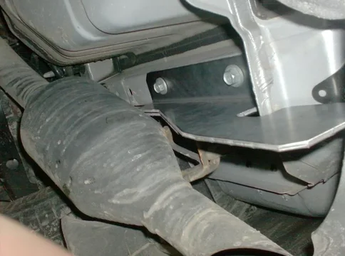

I changed the main brackets by shortening them and dropping the hole furthest forward on the frame rails. Here are the re-punched test pieces. I also tweaked the hole spacings and got rid of the radius cut to go over the muffler. A large radius is hard on the tools when punching the 3/16" thick material.
The reason I feel comfortable in shortening the main bracket and dropping the hole is this hitch. It came off of our Sienna van. I bought it from U-Haul, though they didn't make it. It fastened to the frame rails on the van with just three M12 bolts per side and had no auxiliary bracketry. My Rav hitch will have nine M12 and six M8 bolts and be spread over a larger area. I am not an engineer but I also won't be pulling a 40' trailer. :meh:
And another test fit
Left side...
Left side side...
Right side...

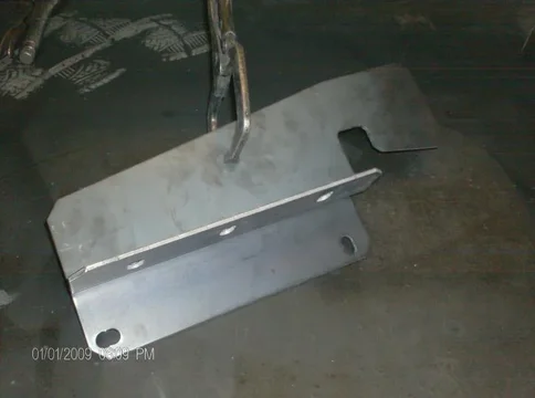

This new layout fit great so I altered the stretch-out of the formed brackets to work with 3/16" thick material and punched them out...
And bent them up... no hand brake here ;)
Test fit the final pieces

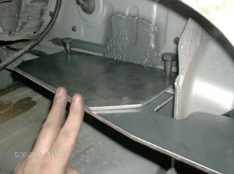

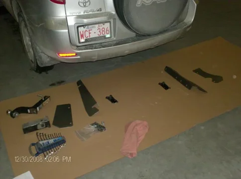

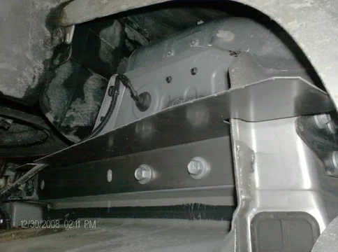

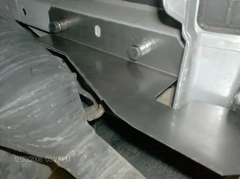

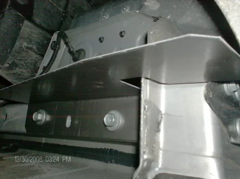

Test fit of the 3/16 parts - left side
I had to remove both of the black brackets because they interfered with the 3/16" parts as they were thicker - they didn't interfere with the thinner test parts.

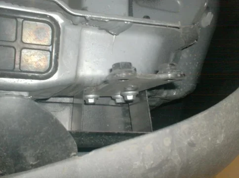

And I had to bend this tab that was attached to the black brackets to clear as well. The black brackets I believe are part of the mounting of the factory hitch. I think the nuts welded on them bolt to one of the many bits that come with the kit. I am going to use the three bolts that attach them to the frame to anchor my mounts as well. I may even chop off the end of them and weld them to my cross bar.

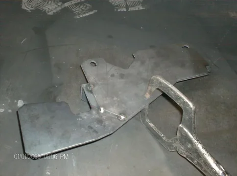

So today I tacked together the 2 piece main brackets...
And bolted them in place in order to plan the next move.

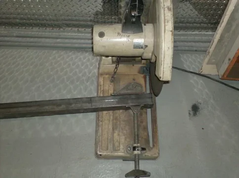

I'd rather use a horizontal band saw, but as I haven't got one.....

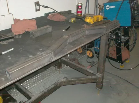

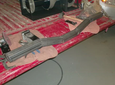

The two main brackets are 45" apart (inside to inside) when mounted. I will come in towards center 10" on each side. At the center I will have an 8" bit of tube to mount the sleeve to. That 8" piece will need to drop by 2 1/4" and move toward the rear 3/4" to clear the sunken floor and rearward bow of said floor.
I started by cutting two 10" tubes at an angle such that they will come off the main brackets straight and level across the vehicle. The other (towards center) end of those 10" tubes was cut at a slight angle to start the down and rearward bow of the drawbar. I tack welded those two lengths of tube to the straight edge of my work bench, 45" OD apart and the front side (with respect to the vehicle) down on the table. I then tacked an 8" length 2 1/4" back from the edge of the bench and spaced 3/4" up off the table surface. Now all I had to do was join the three pieces with two carefully cut lengths of tube.
Can't do a compound angle cut with a simple chop saw, so after a bit of grinding I tacked in the angled pieces good and solid so they won't snap apart...
Then cut the draw bar loose from the table.....

Removed from the "trucklet" I welded everything solid... and added the sleeve.
