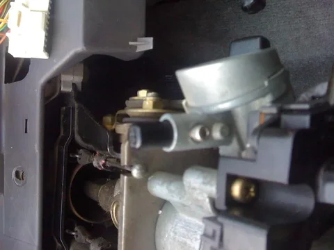

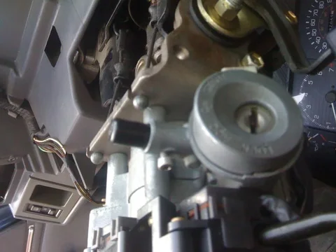

Here's what i did to hold the button down after removing the steering wheel's plastic cover:
While holding the button down, i drilled a hole small enough to self tap a 4/40 set screw into the metal casting and then the plastic button. I didn't drill it all the way through because it didnt seem necessary.
