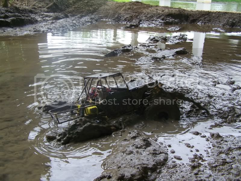

I ran the Traxxas 2075 Servo for about a week, since it is plastic internally I manaaged to destroy it. I have put the stock axial servo back in and all it good. They say it isn't waterproof, nonsense. I have ran that thing through so much mud and water it's silly.
Brushless to my knowledge is not waterproof, and for a crawler it's unnecessary. You'll be better off spending your money else where and putting a 55T Tekin motor in there with a nice ESC with a good drag brake. I'm not to familiar with the different types of ESC's out there, but from what I have read online Tekin makes some of the best stuff. If you throw more grunt in it. You need to upgrade the plastic driveshafts. They will snap and pop quickly. MIPS makes excellent stuff, I am running $7 Traxxas shafts and have not had one break since. Very tough.
Here is mine:
As for the Honcho, it's pretty much stock. Metal links, 4 link in the back (must do!)
