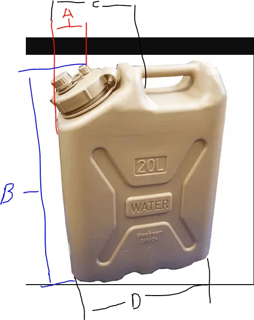

I'm making up some racks and my can is delayed in shipping. Does anyone have a scepter 20L water can they can measure to get me the below dims? I'm trying to make my bracket a relatively tight fit so when they are racked the water cap can't be removed.
I measured A=3" B=19" C=7 1/4" D= 14"

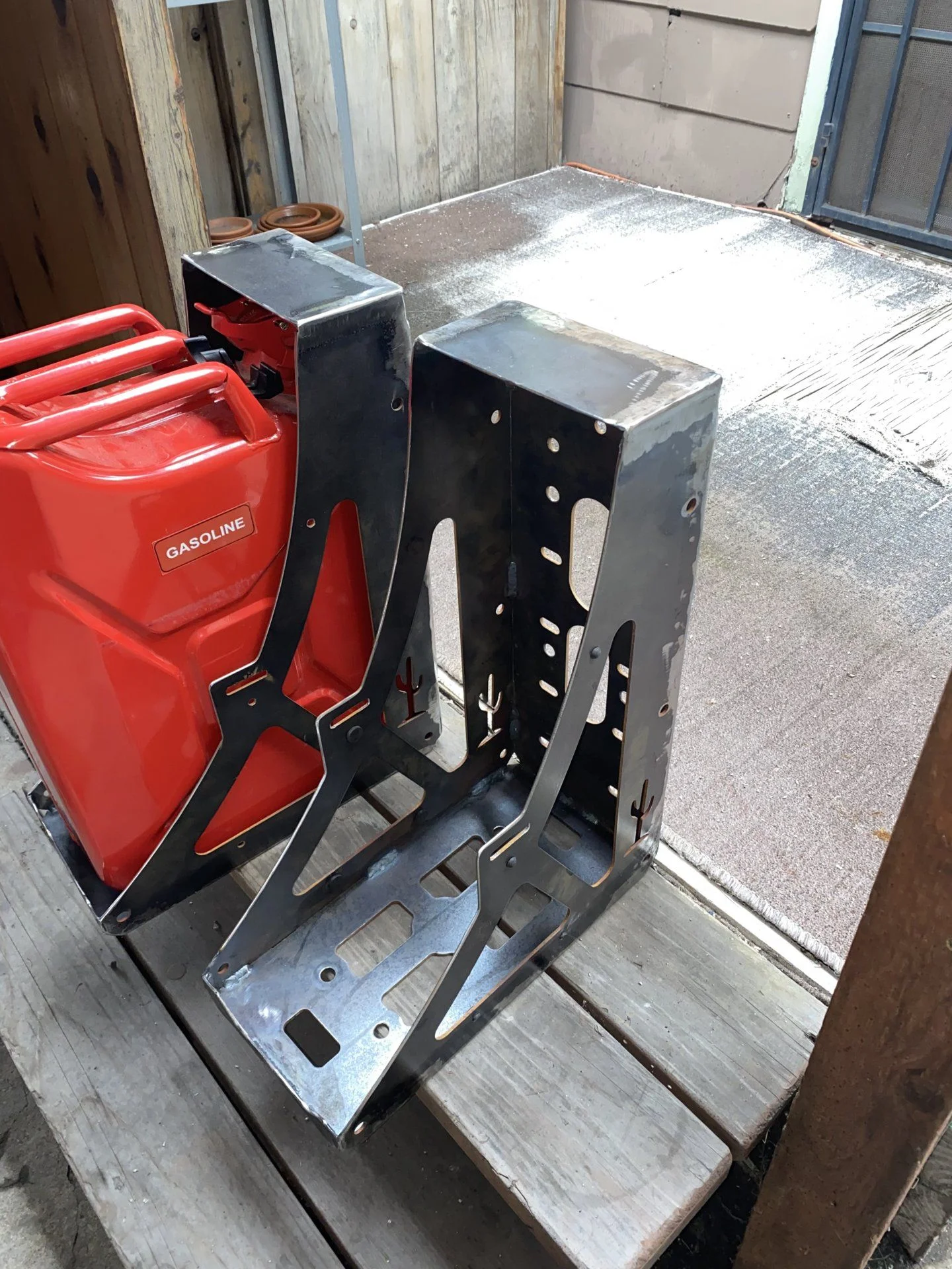

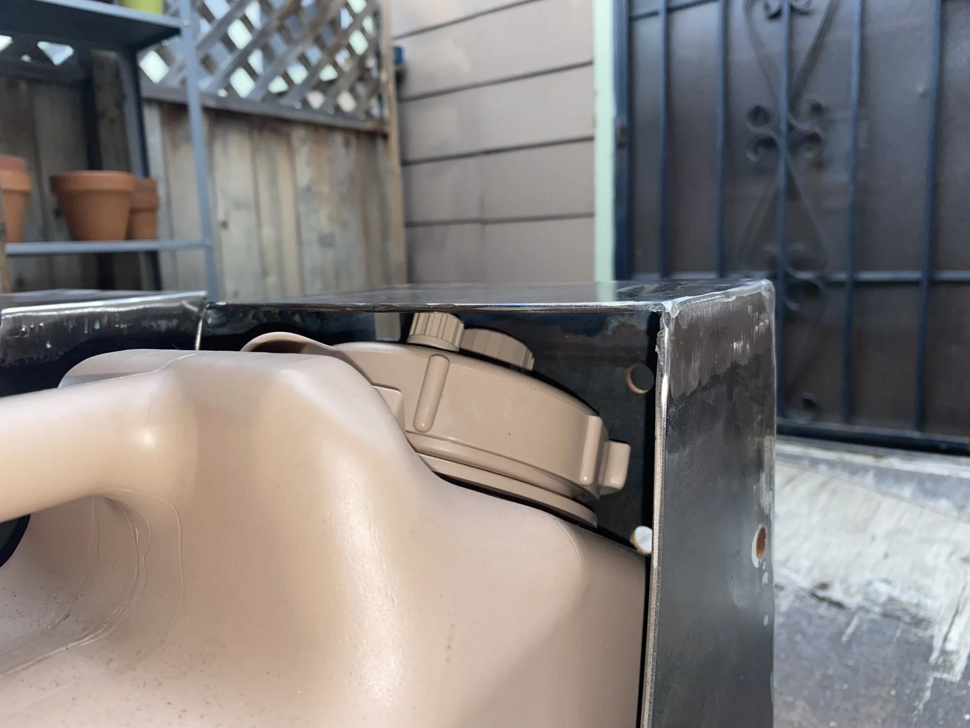

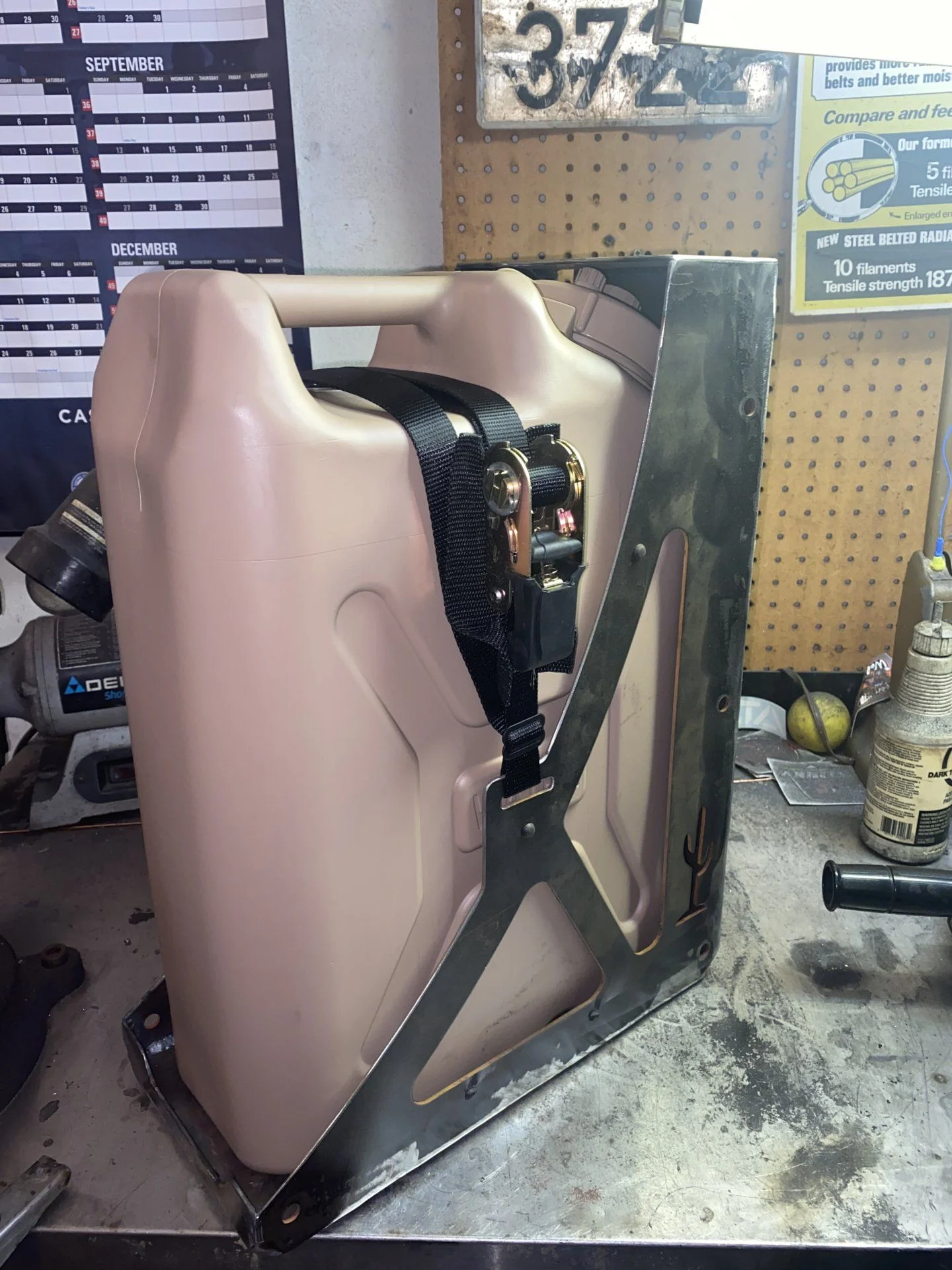

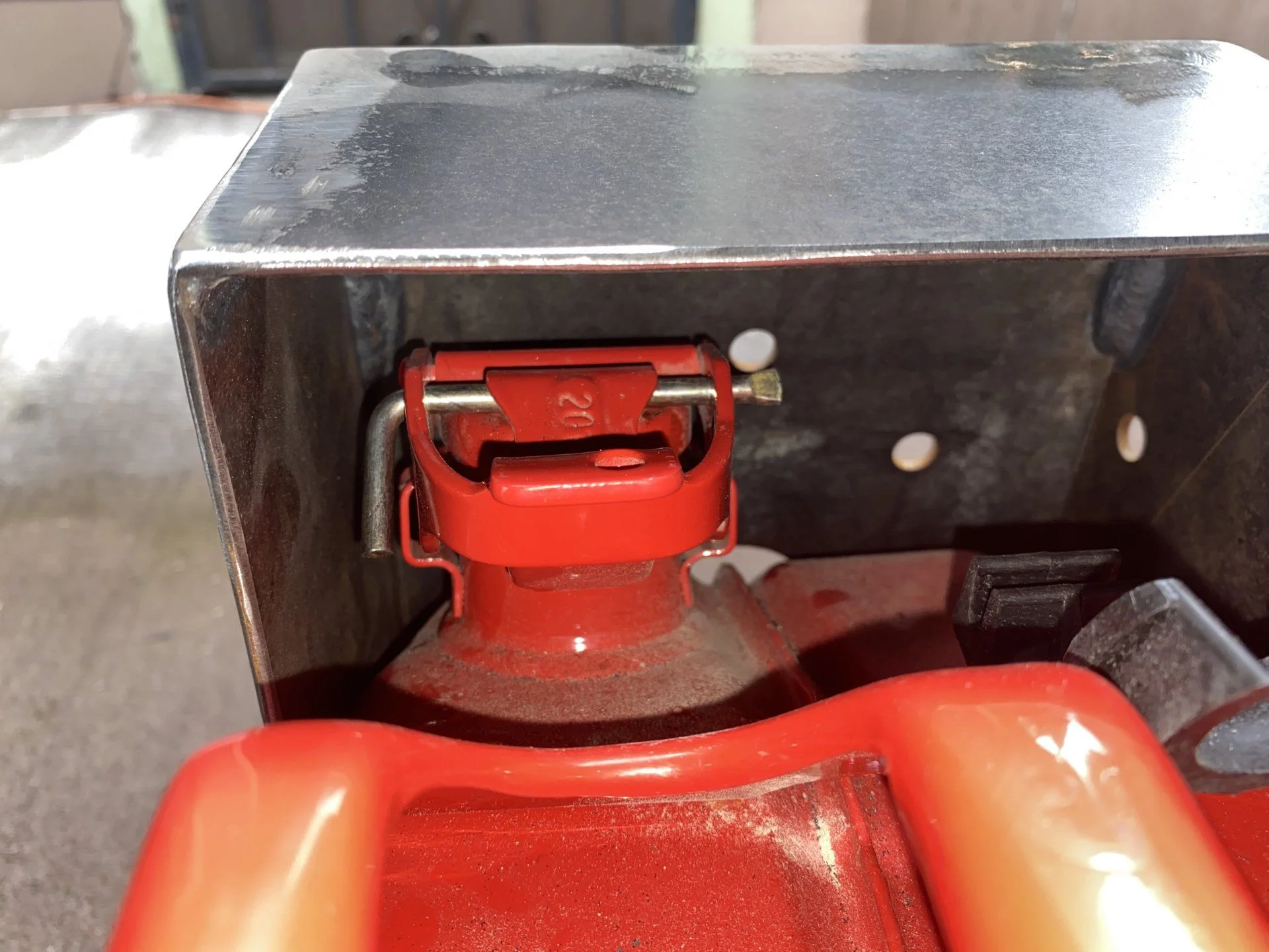

Well here is the finished product minus paint (my least favorite part). Since a lot of the off the shelf can mounts were expensive I figured I'd make my own, but spend some of the $$ saved to make them just how I wanted. As roalco mentioned I wanted to keep the fit tight enough that no one could steal or mess with the water jugs. If they drill a hole in the can...they can have it at that point. These fit the scepter as well as the wavian fuel cans. The boxed section up top is tight enough that when the cans are in place the top and ports on the scepter can't be removed and the pin wont come out of the fuel cans. The plan is to run a cable lock though the can handle and the mount so the cans are locked in when needed.
