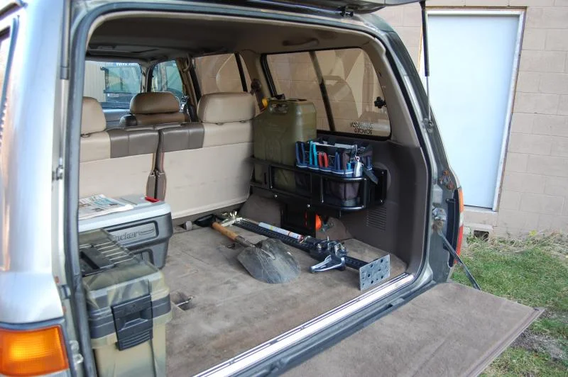

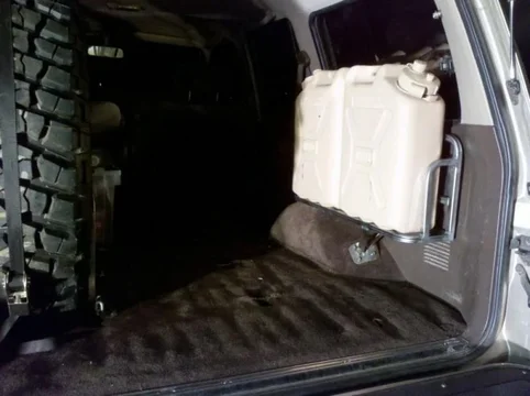

check out these pics..
this is what others are doing....

Those racks are genius! Where do I get my hands on something like that?
From that thread
Ok guys, I’ve received a lot of emails lately requesting the interior carriers and I can make more of the carriers however:
• I need at least 20 pair (1 driver and 1 passenger side) pre-orders with deposits
• The cost will be $649 a pair (I sold the first 20 at a loss)
Please post up what you guys think. I realize some will not be happy with the increased cost however quality and design isn’t cheap.
My feelings will not be hurt if the cheaper version is the popular choice.
