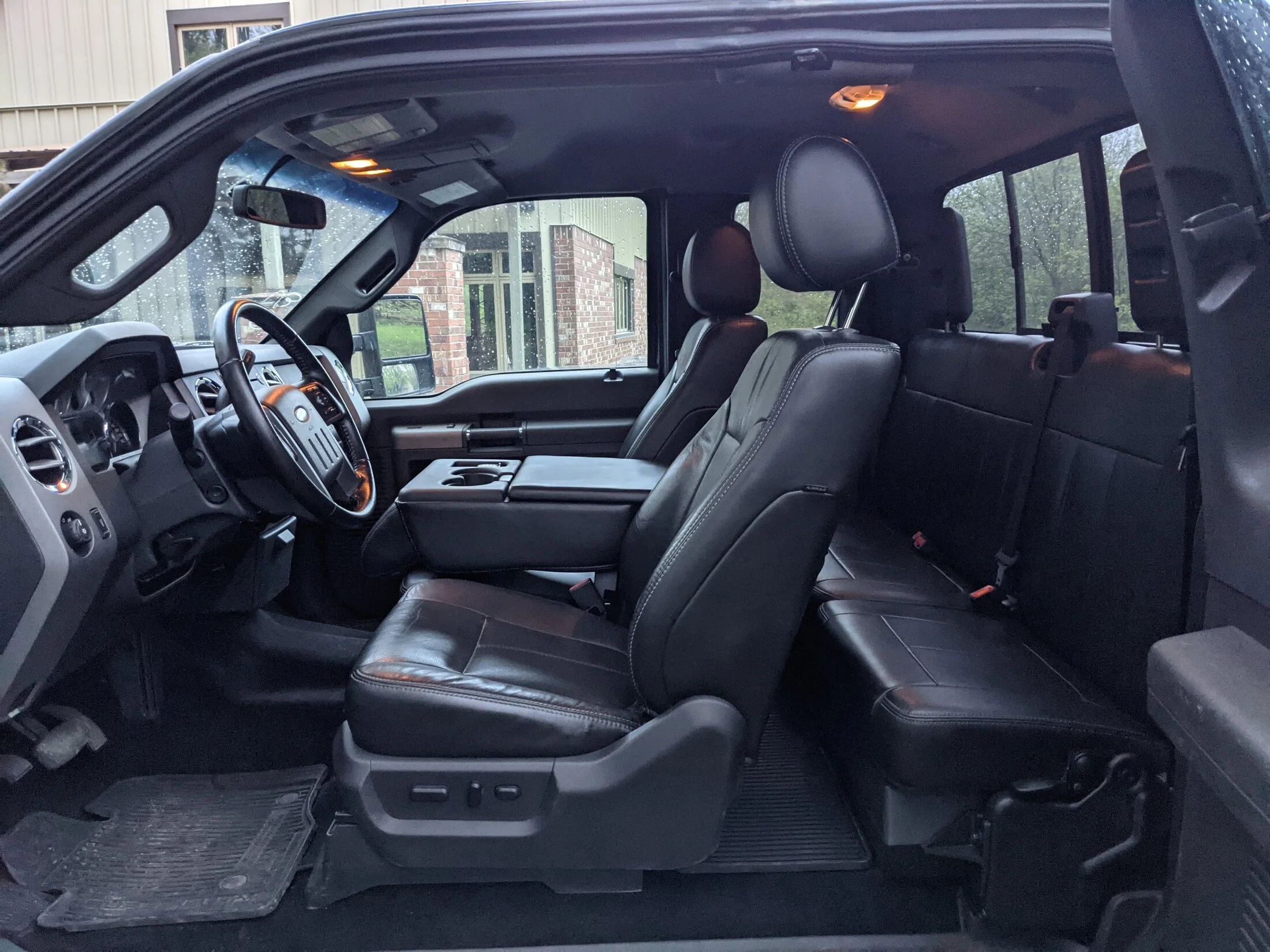

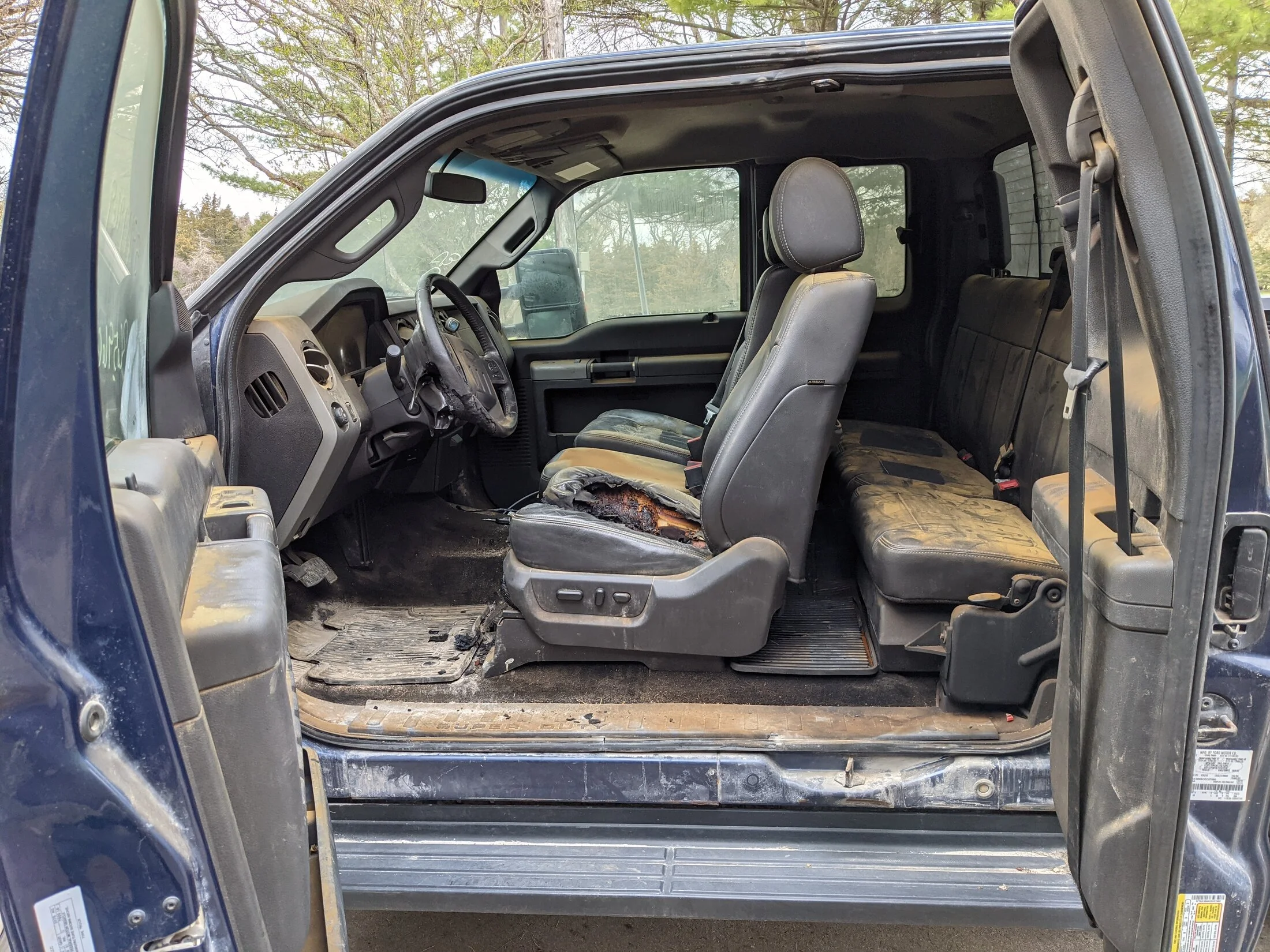

A few years ago I bought a wrecked F350 Lariat that had a burnt driver's seat. I think the same thing happened. I pulled the entire interior including the dash, headliner, everything. I had to clean every inch. I cleaned out the vent pipes, cleaned the needles in the gauges... Crazy.
Here's the before and after...
I wouldn't want to do it again but it can be done. Very labor intensive!
