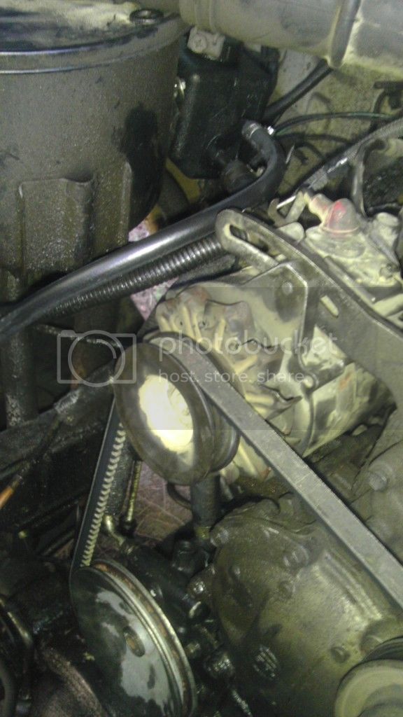

I pulled a late 80s early 90s pump from a volvo 740 it had remote res and I installed it on sunday. I works great and had the same fitting.
I was really going to a remote res for the space saving it provides. I pulled out my fabed bracket for my 3b and barely had to tweak it to get this one to fit. I wouldnt be surprised if it was almost a drop in replacement for those with stock brackets.
Its so nice having power steering back, one to have a pump that never lets you down is amazing.

So, you put this Volvo remote res pump on your 3B? I'm in a similar situation and would like some pics on this setup.
In parking lots the steering effort is increased and on the trail it just gives up sometimes.

I had the same experience minus the steering box seals (knock on wood). Pulled mine from a 1984 Volvo 240
Been running this way with the stock pump for some time now , belt never slips and I haven't wore one out yet surprisingly. It's not my preference but until I sorce a double crankshaft pulley or weld one up it works. My plan is to have the alternator on its own belt.
Sorry I don't have any specs on it, it looks smaller but it sure cranks way better then the stock pump even with the low idle of the 3b. Also the pulley on the pump is larger then stock. Was planning on putting a smaller pulley on but so far havbt needed it
