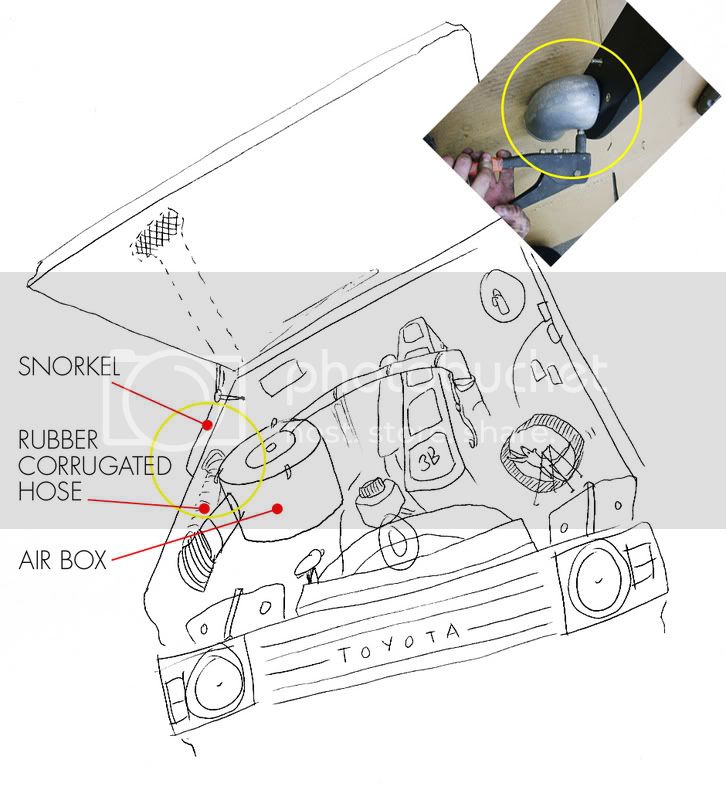

how is the inside plumbed?
That's my question as well...what kind of "chambering" does it use to keep stuff out of your intake? (ie:rain, snow, debris)?
Just curious!
The kit comes with a rubber corrugated hose and hose clamps which, once the snorkel was mounted to the truck's outer fender, the mentioned hose was hose-clamped to the elbow (see photo) and fed through the inner fender to the factory air box, which will filter out natures elements.
I hope that answers your questions.

Rig of Mortis --- can you post a pic or 2 of a shot under the hood? how does the hose get from the left side of the stock air box to the right fender elbow??
PERFECT explanation. Could you also bless us with some additional photos of the whole thing? I'm still kinda suprised that the snorkel intake isnt pointing backwards.

I always wondered about the snorkel pionting forward too, seems prone to catching stuff...
I think I read that the snorkel has a mild ram air effect, though I bet it is negligible. I believe they can be turned around without a problem for when there is a risk of mud being thrown in, and that there are 'vents' for the water to exit the system in the rain.
Only snorkel I ever drove was homemade, and it seemed to limit the intake a bit, but never a problem with it pointing forward

and yeah, whenever you get some under hood shots it'd be appreciated.
I believe his is a diesel so his airbox is in a different spot than our 60s. When I did mine I cut the snout off the factory air cleaner and flipped it oover and welded it onto the other side pointing toward the passenger fender. I'll try to remember to post some pics when I get home.
Brian
Currently, Jim from SROR is reversing the air intake on my 60’s air filter housing to the passenger side so I could mount up my snorkel. Perhaps he could post some photos of his work for the group? ;)
