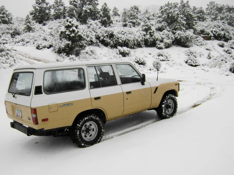

No need for POR-15 first either. Just do a good prep and topcoat with a quality bedliner product. Mine is quite practical in that there is no pinstriping in the liner from trailside branches, it stands up to anything smaller than a fist sized rock chucked at it, and it shines up nicely with Armor-All. It's bumpy as hell with texture, but the actual material is just as smooth and hard as automotive paint, so no attracting dirt, here.
What I used was called Rattleguard, and being a true 2-part epoxy means that prep is just as extensive a regular auto paint, but it has it's advantages.

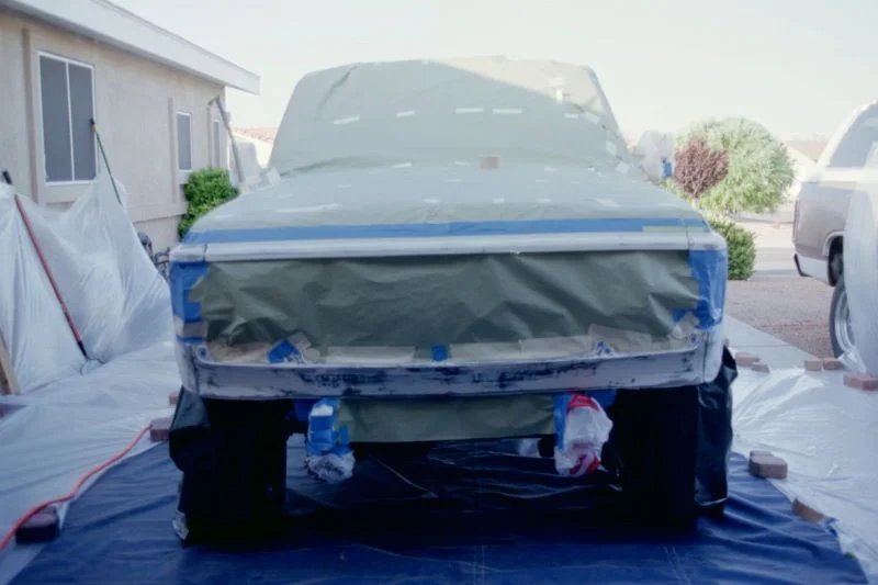

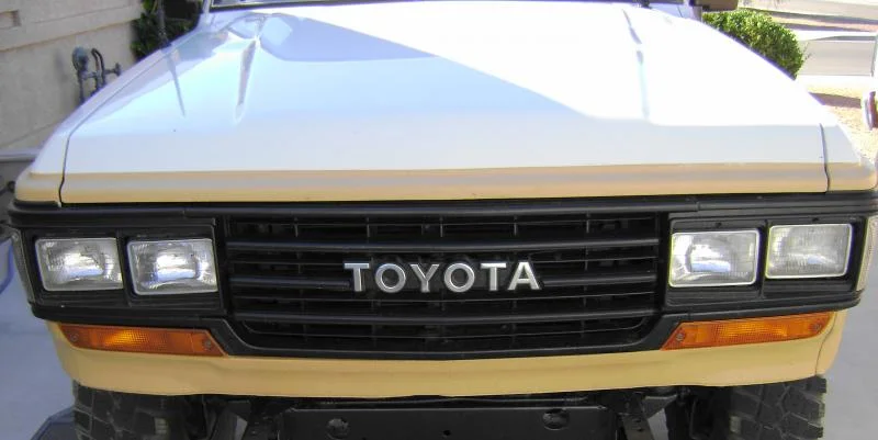

Wow, I really like the colors, and lines of that layout. A nice throwback to the 55s. Absolutely gorgeous!! :cool:
Do you have a pic to show what line was taken across the front?
Jeez, thanks. Here's the front as of this morning, along with another showing just before spraying it.
