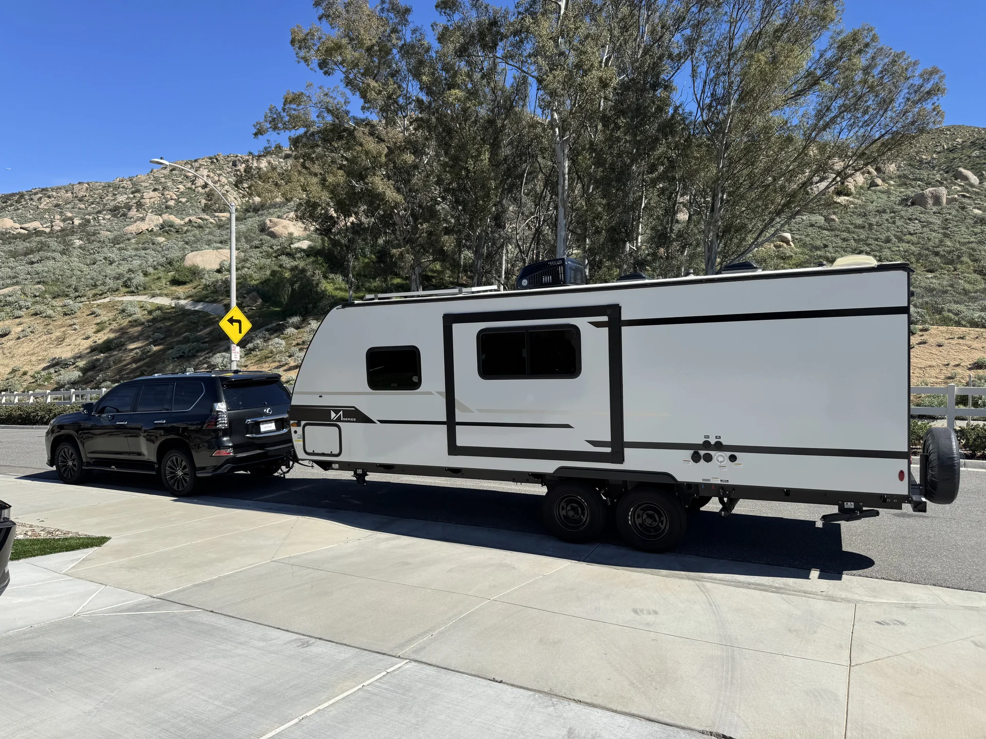

We have a 2326MBBH 6K lbs GVWR that’s 26.7’ x 7’. With all the camping stuff and 30 gallons of water it weighs 5500lbs. Due to payload we can only carry 3 adults and a dog inside of the GX while towing. Using a Blue Ox Sway Pro WDH and Rearc Tow Pro Elite. Dual axle was a must for my anxiety.
Good luck.
Good luck.
That's a LOT of trailer! I think that's the most I've ever seen a GX tow.
