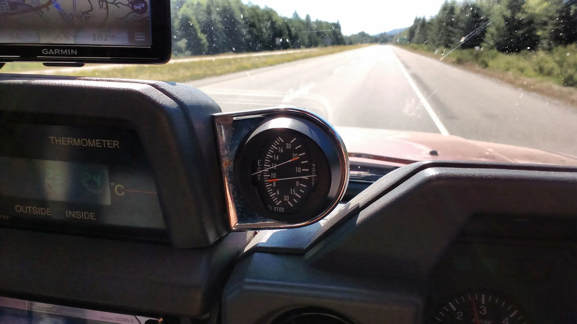

I've been running my 2LTE like this for 8 years now and haven't had a problem. If a 'fragile POS' motor can take it, then the mighty 13BT shouldn't have a problem!
Typical speed up on highway high boost and pre-turbo egt while towing 3500lb 16' camper:
img_20180722_105600351-jpg.2590648
Cresting the Malahat. This is a typical temp on factory gauge at the top of that hill on hot day with A/C on towing my 16' trailer. Engine has seen this about 12 times a year for the past 8 years. Amazingly I've had no cylinder head issues. I chalk it up to the Evans Coolant and intercooler/tuning. I never bothered getting an aftermarket coolant gauge - as I don't want to know how hot I'm really getting it. :lol:
img_20200614_144610604-jpg.2590647
I agree with Nick, your motor is pretty durable. My guess with the head gasket would be lack of coolant, poor maintenance clogged radiator, water pump on its way out.?They rarely for no reason go south.
Paul, without gauges you are just guessing. With gauges, you can tune it stress-free. If you turn it up and add an intercooler you can see the differences in egt's.... but you need a gauge. See a theme here?
Watching boost gauges is fun... but you need one first.
I loved dialing in my 3B turbo. After I added the intercooler and set the wastegate to 12psi I could happily do the speed limit up the steep side of the Malahat, it was a truly rewarding experience. All with EGT's at a safe 1100 degrees no matter what. The sound of a whistling 4cy diesel is music to my ears, I just love it.
