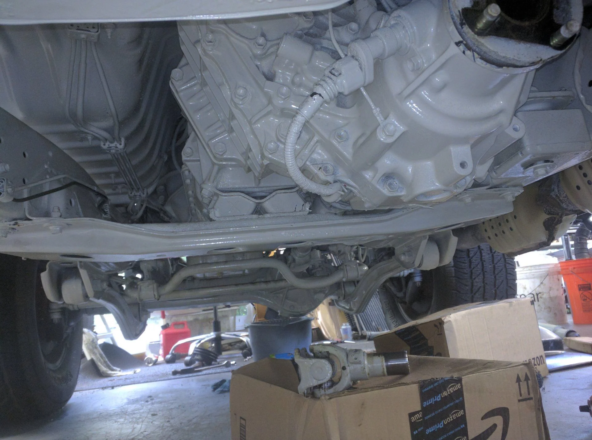

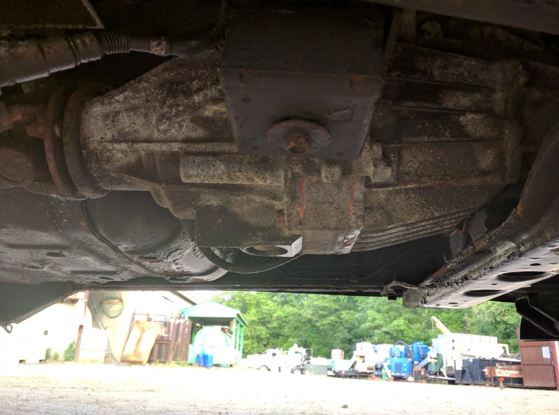

I had my underbody blasted and painted. Starburst sand, I believe was the product. Epoxy primer, polyurethane top coat.
Before:
After:
Obviously, t-case won't rust but you get the idea.

So did you have it blasted? What did they use? I am nervous about hiring one of those dust free guys because while it seems like they do a great job of blasting, I am worried it might be too aggressive.
I am leaning more towards the route Linus has. I like the idea of owning the blaster, as I am sure I could find plenty of uses for it.
Your truck looks great though!

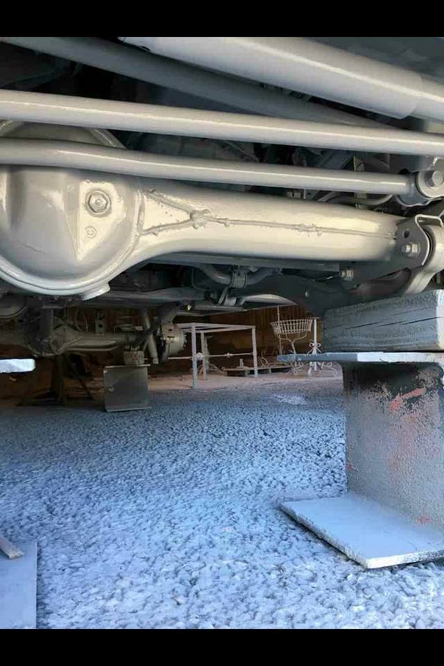

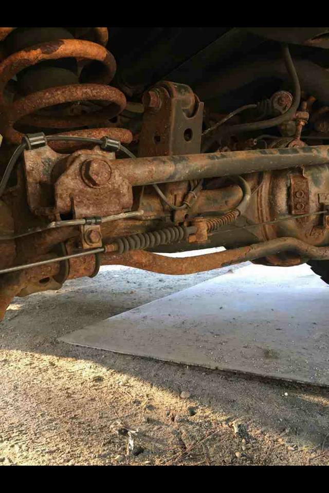

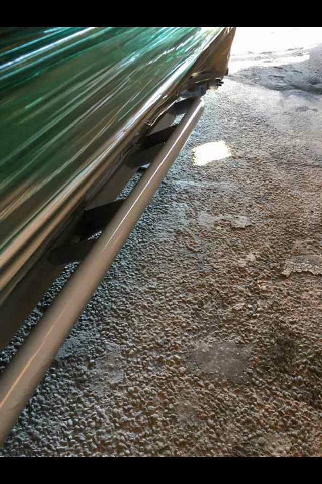

Soda is good for paint but will not take off rust as it is too soft. A siphon blaster will work fine just a bit slow if your compressor is small. There are siphon blasters that work with a power washer too, not sure how they work though. I used my small pressure blaster (like 40ish cfm) at my shop and blasted the back half of my 80 (still have to do the front). Big sandy mess but worked great. For paint, try Chassis Saver brand. It works as well as POR 15 at much lower cost. As far as keeping it nice, just spray the bottom with your favorite oil and hit the car wash a lot in the winter. My white 80 is really nice underneath after a Michigan life, just taken care of from day one.

Looks like I was mistaken; its Starblast not Starburst. Starblast™ and Starblast™ XL Blasting Abrasives
I had the entire underbody blasted. Guy did a good job; I did have to replace a hard brake line due to a leak but I'm in New England, YMMV
I also had it painted white and the difference it makes being able to see under there is non-trivial.

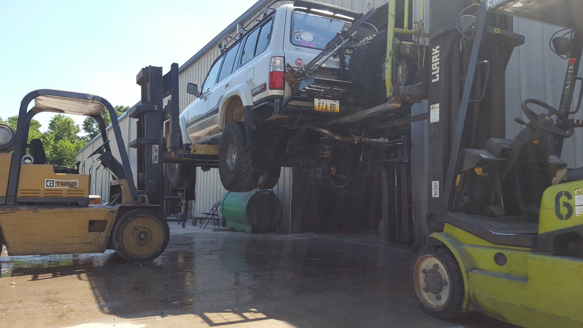

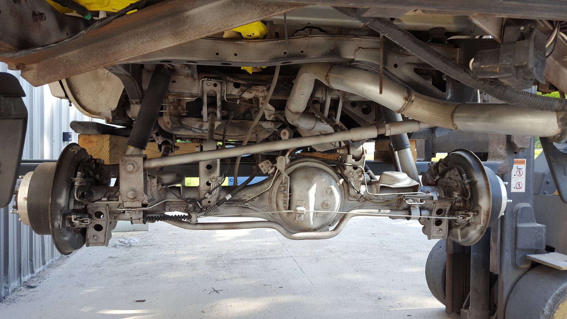

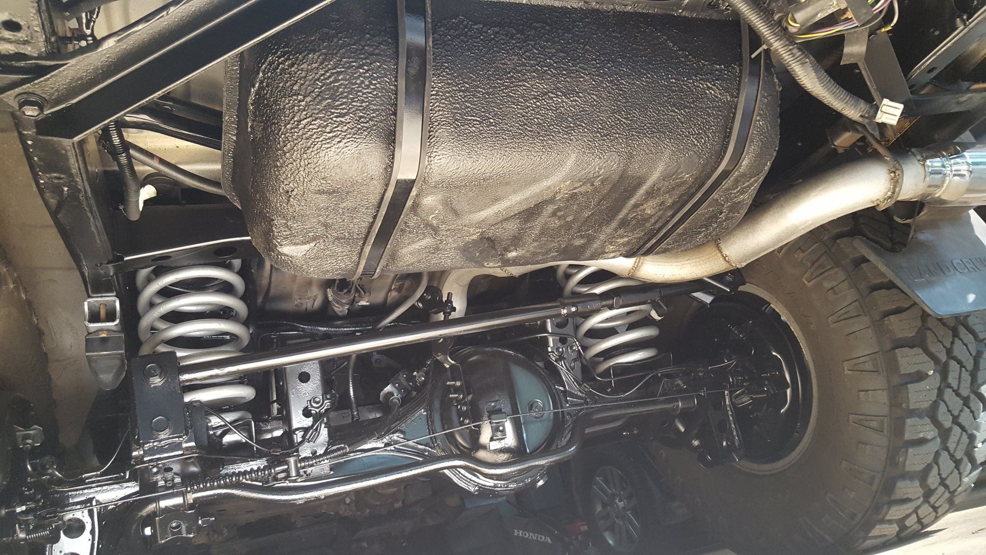

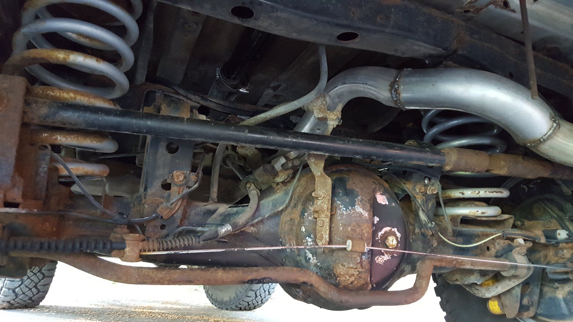

Thank you. I pulled the springs out and powder coated those, and just used a small paint gun (jamb gun) with a little masking and using a piece of cardboard in my other hand to mask my way along as I sprayed. I did do a little follow up with a brush.
Being up in the air was a huge help.
I power washed it on Friday afternoon, blasted Saturday morning, powerwashed it with cleaner/iron phosphate (how we pretreat metal in the powder coat shop), air chucked the drippyness off and let it air dry, painted two coats on Sunday.
Killer truck lift
That was a little wierd but worked great. I picked it up with a 12,500lb capacity lift then backed it up with two 5000lb lifts since i was standing under there.

But seriously, did you dismantle everything under there to paint it?

Not too much really, pretty much just took out the springs. A mid size blaster is really good for this, like a small pressure pot type. I did use my big 185cfm diesel compressor but not the big blaster, it was too much. A decent sized smaller unit would get it done.
Paint was just minimal taping, and using a cardboard guide with one hand and a jamb gun in the other (I painted the crap out of my hand).
I agree with the other guys- that lift system is awesome. I need to buy a couple of forklifts.... just for s***s and giggles.

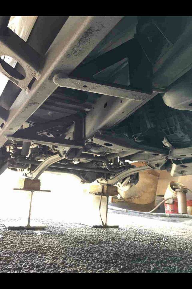

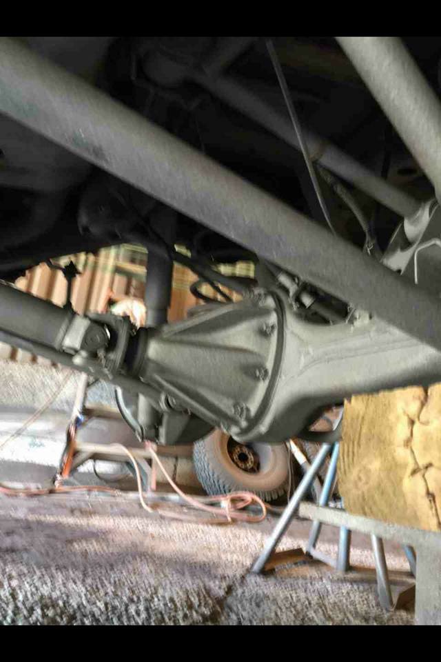

Here are 1st 5 pix after BlastAll got a hold of SGTPEP
