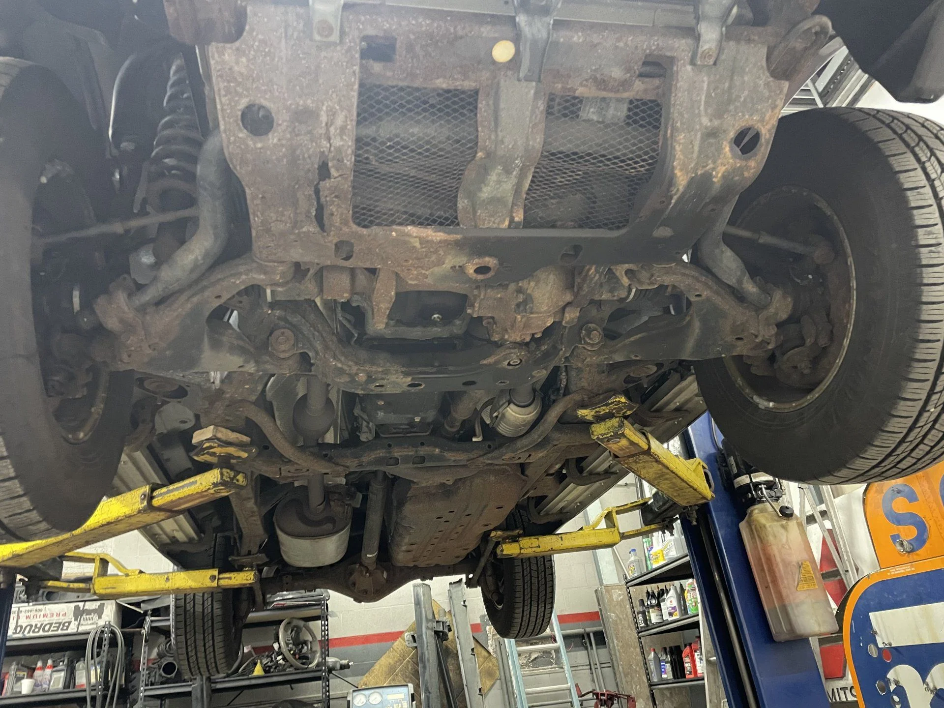

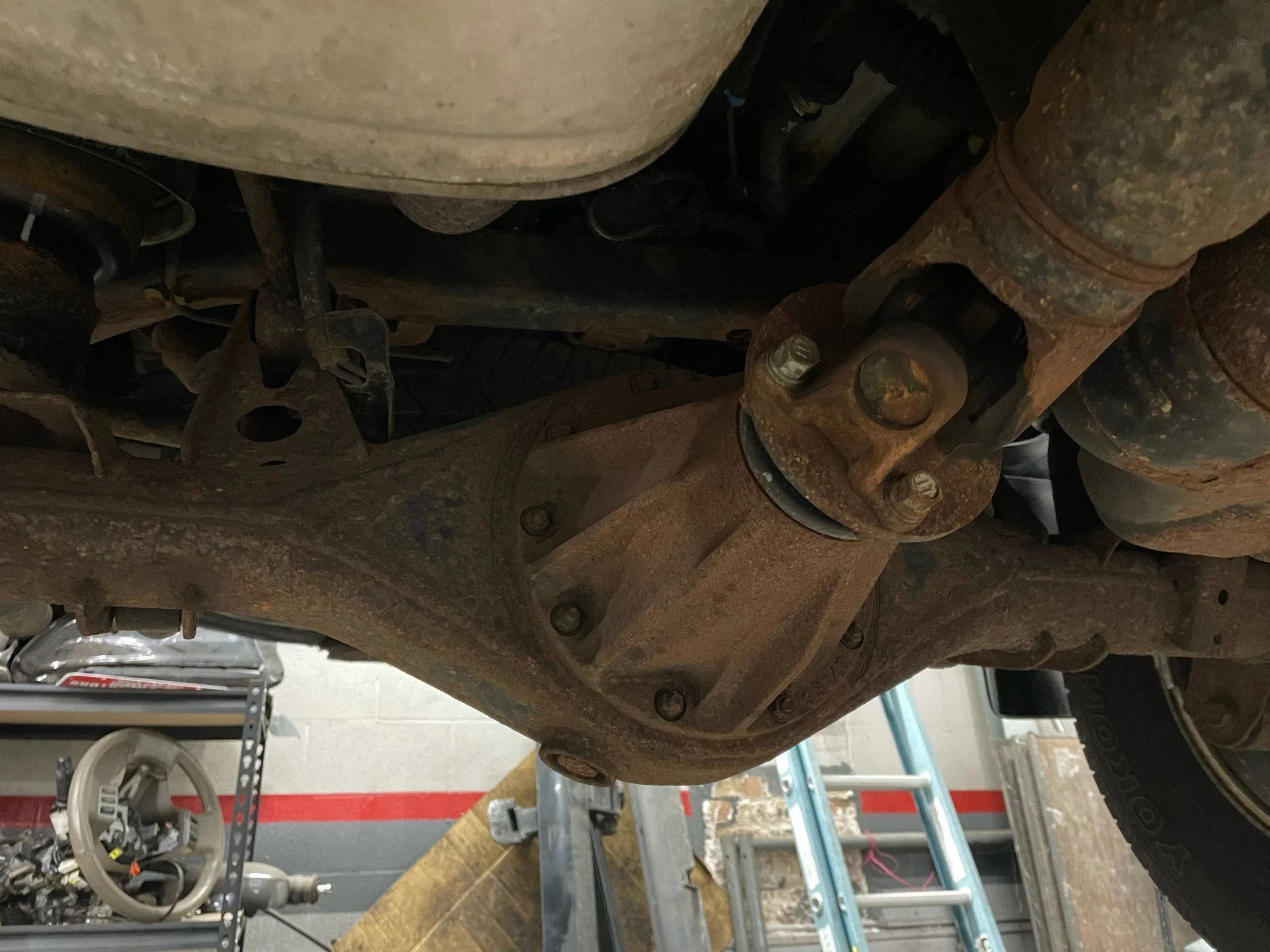

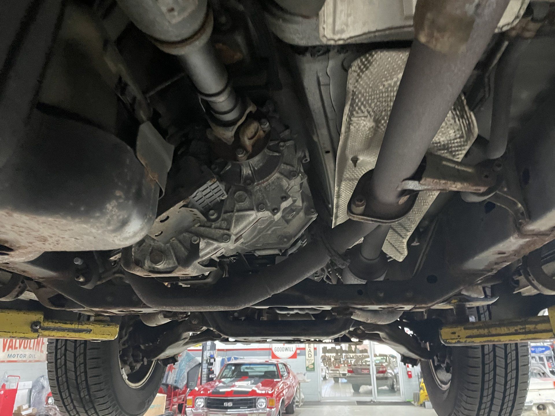

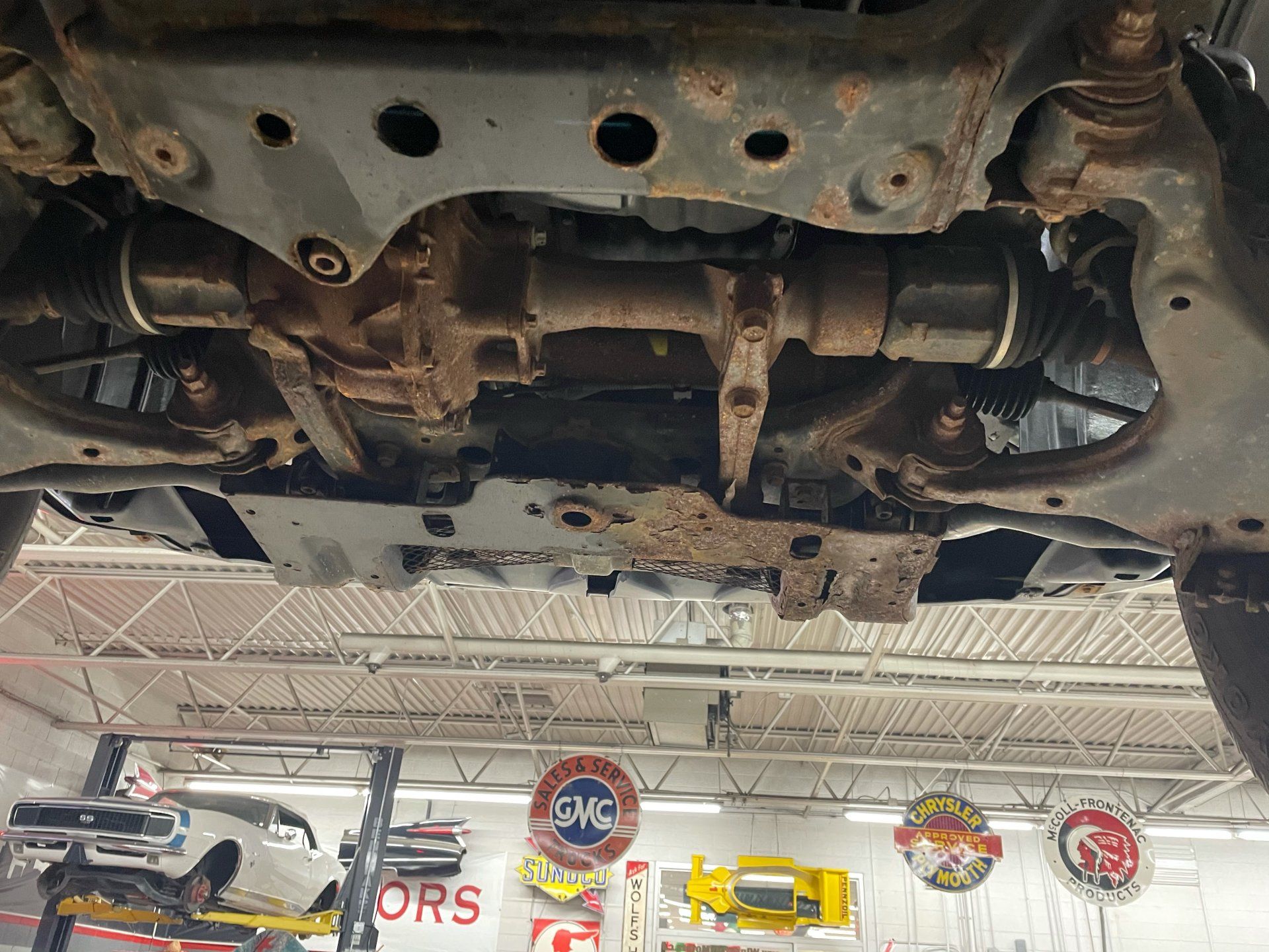

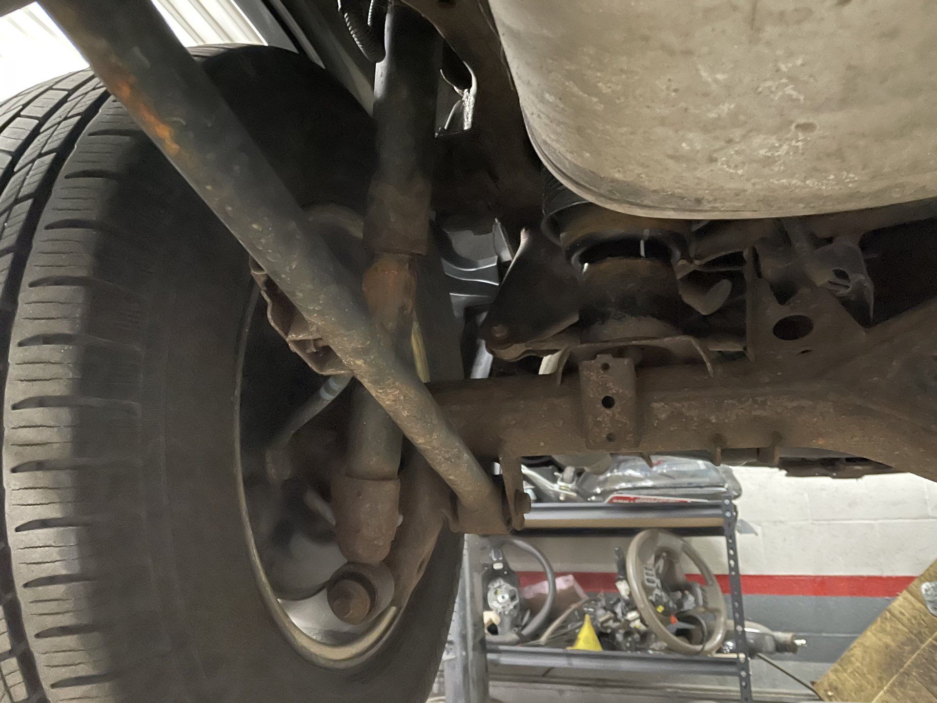

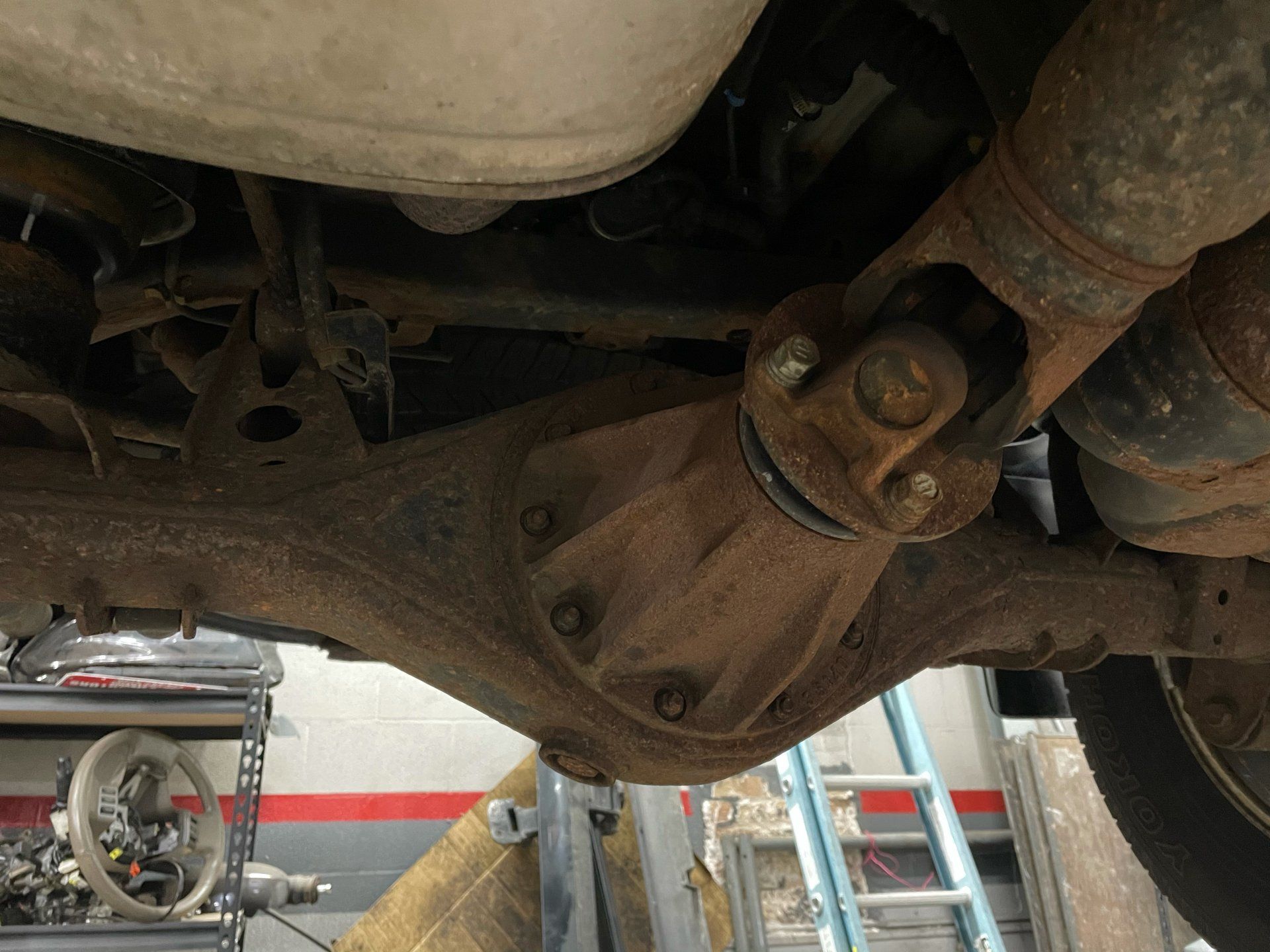

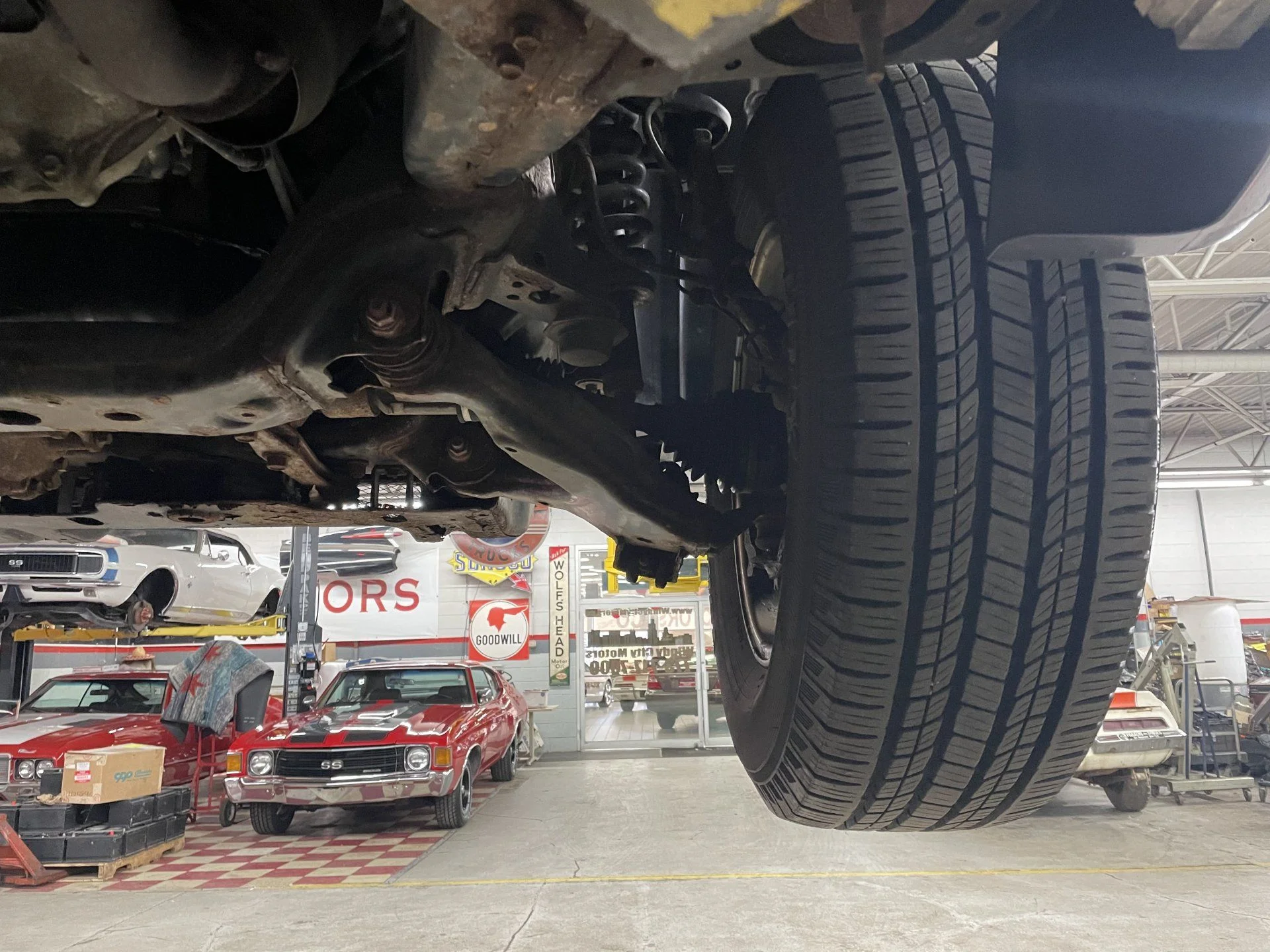

Hi! New member here and realizing how tough it is to find one of these. I think I found one for a good price but I asked for pictures and they concern me. In the interest of not hijacking anyone's thread can anyone see these pics below to comment. I know the front skid is rusted out but that will be replaced anyway as I plan to wheel it. Can you look and comment? Thank you!
Also, does anyone know is it expensive to fix frame damage? Thanks!

None of that looks particularly horrific IMO... No rust holes in the frame that I can see, would be cool to have a shot of the lower rad support, they always seem to go there.
Rust on the axles/frame surface rust can be wire brushed/converted/Fluid film'd for many years of service. Depending on how sweet the price is I'd grab it.

That looks pretty similar to my '07 GX470 (which spent most of it's life here in Missouri). I agree that if there are no holes, it's not a big deal. My spring project will be to put the GX up on jackstands, thorughouly pressure wash the entire underside, wire-wheel the rust, paint, and then apply a coat of Fluid Film black.
You can always use it as a bargaining chip and get the price down. However I would NOT buy it sight unseen with rust like that - you definitely need to inspect for holes as rust always seems to be worse in person than in pictures.
I've seen worst. It's mostly surface rust from what I can see in your photos. Check rear cross member behind rear bumper and body mounts. The under body behind the rear alex is the area that sems to be most affected. Over here 120s only have rust protection outside the chassis rails and just paint on the under body inside the rails.

Thanks everyone for your replies. I’ll have them take more pics of the rear but it doesn’t sound too bad. And thank you for the link with instructions for cleanup. Thank you!
Is grinding the rust off then coating preferred? What about something like rust converter then painting? Same result/ different approach? Easier for me to spray rust converter than grind in the driveway. Can always rent lift time if grinding is better.
