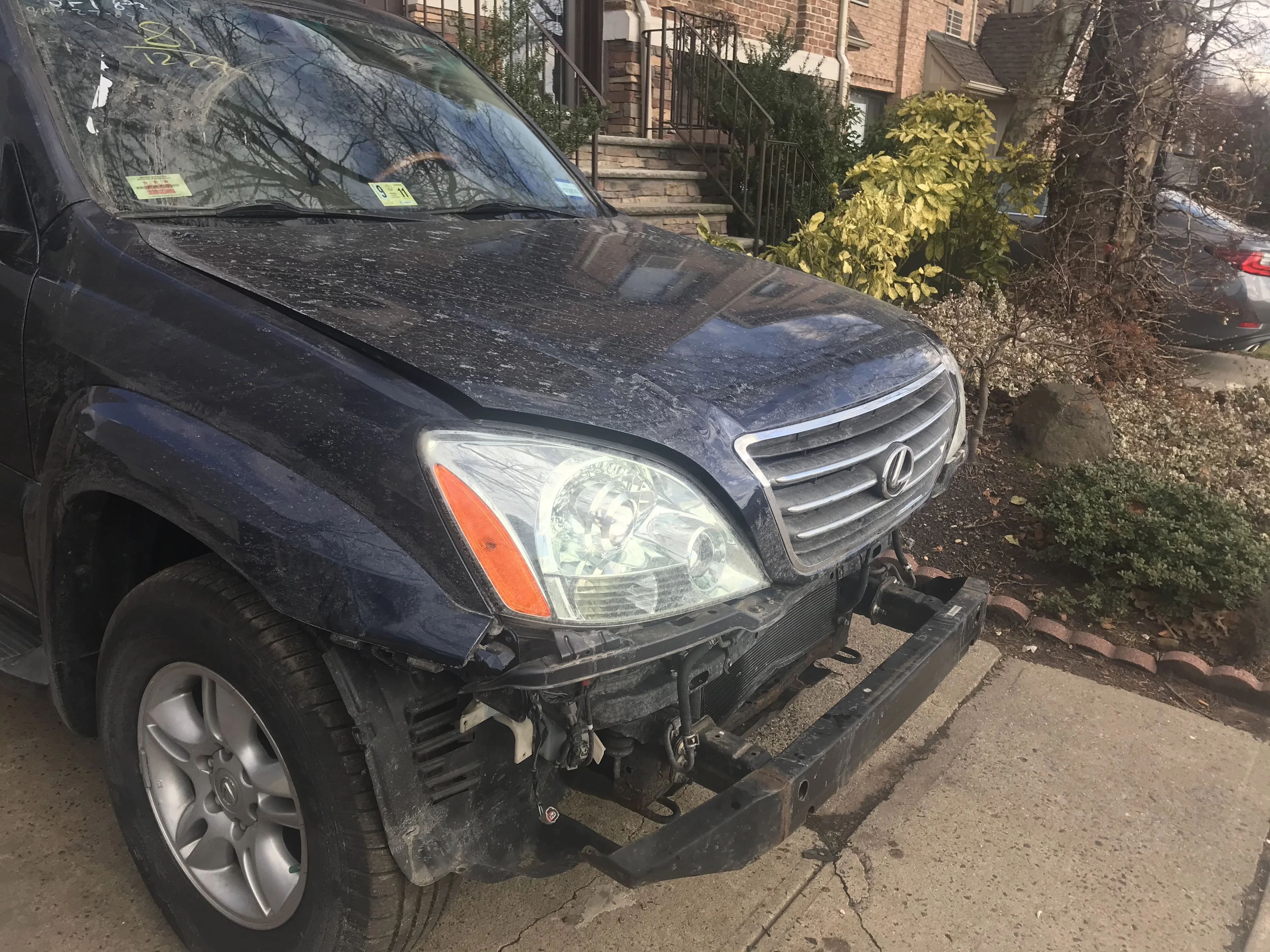

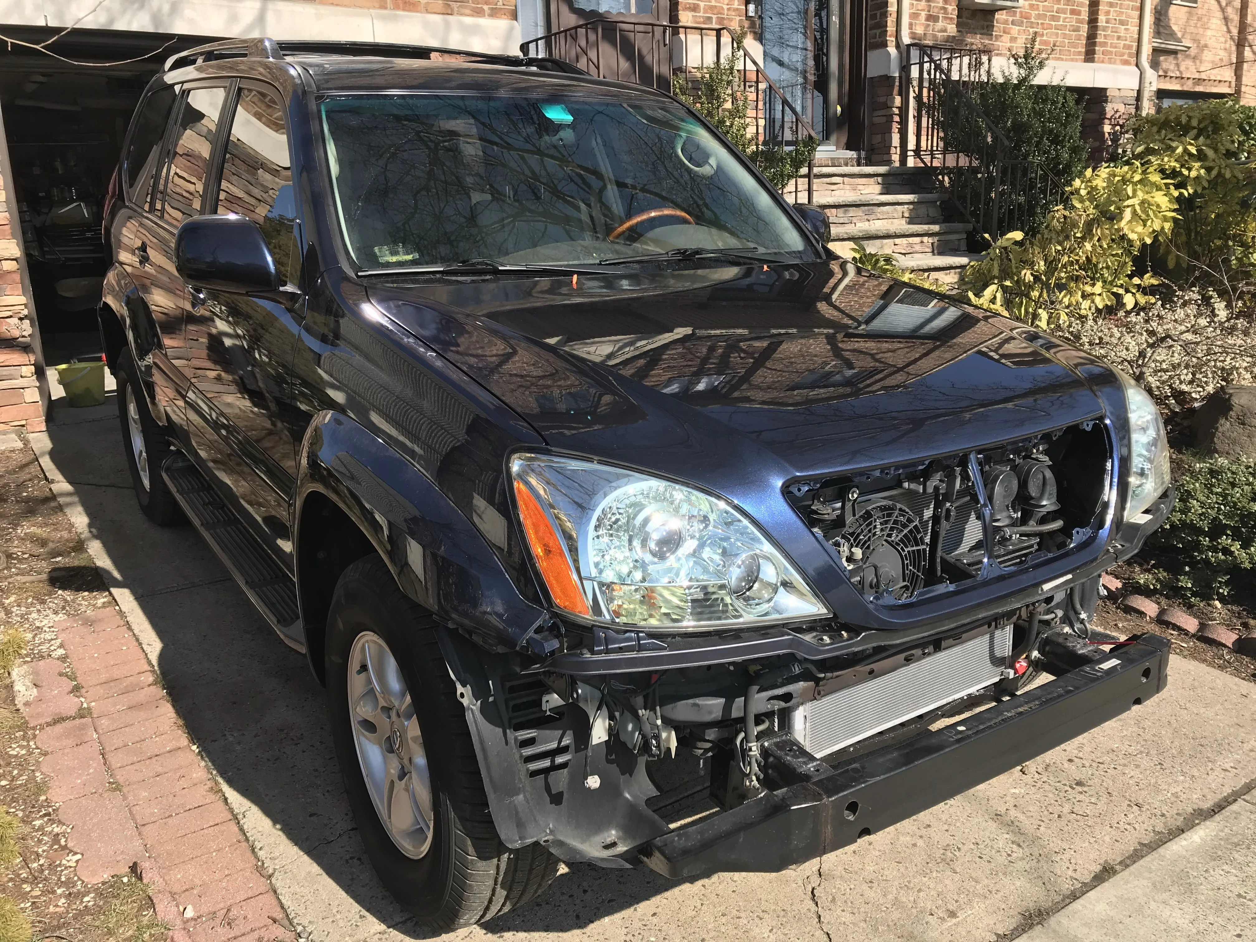

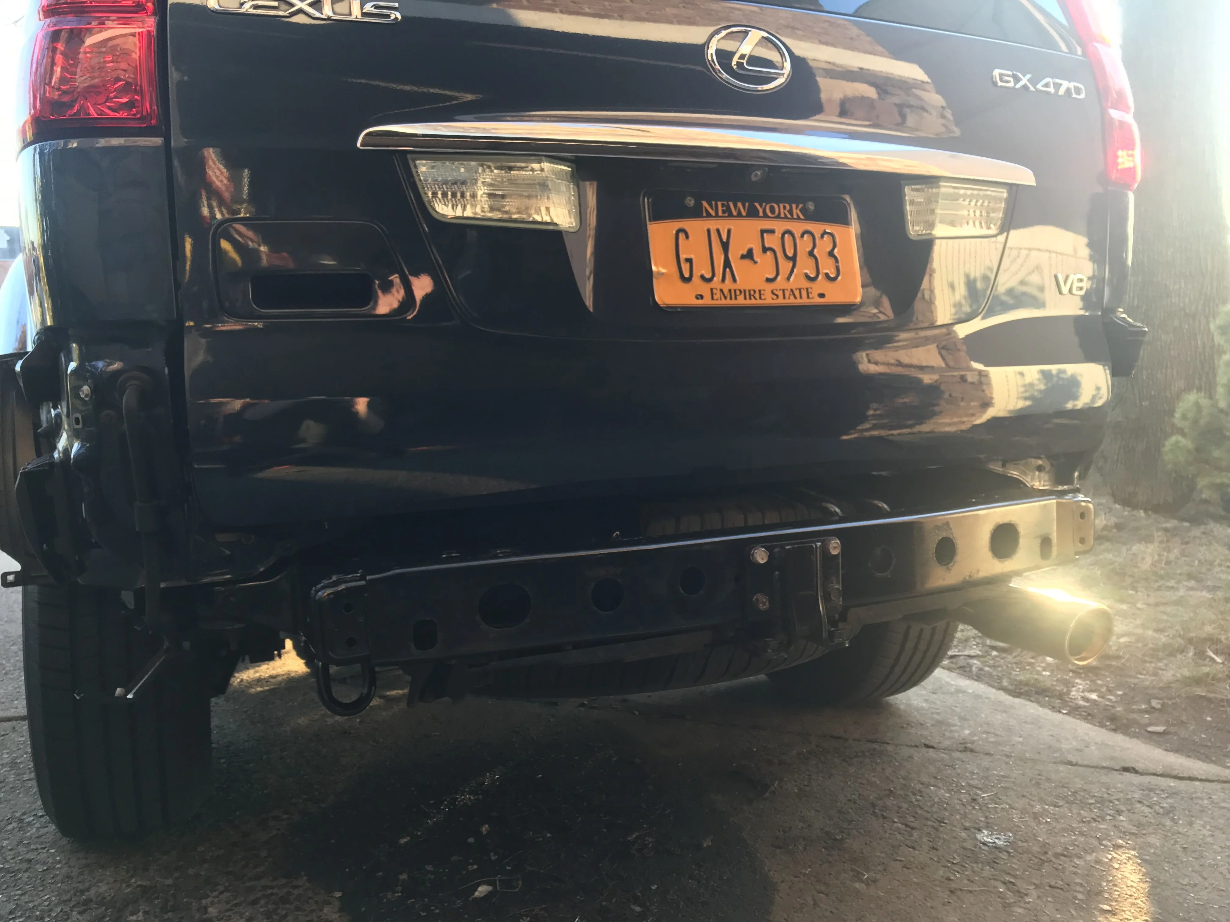

The subject at hand caught my eye while browsing an online salvage write off auction due to having rather low miles for the year, only 67k and being a one owner truck from new. After placing a winning bid the truck arrived at my home via car carrier.
  • 2004 non KDSS, Mark Levinson sound + rear air.

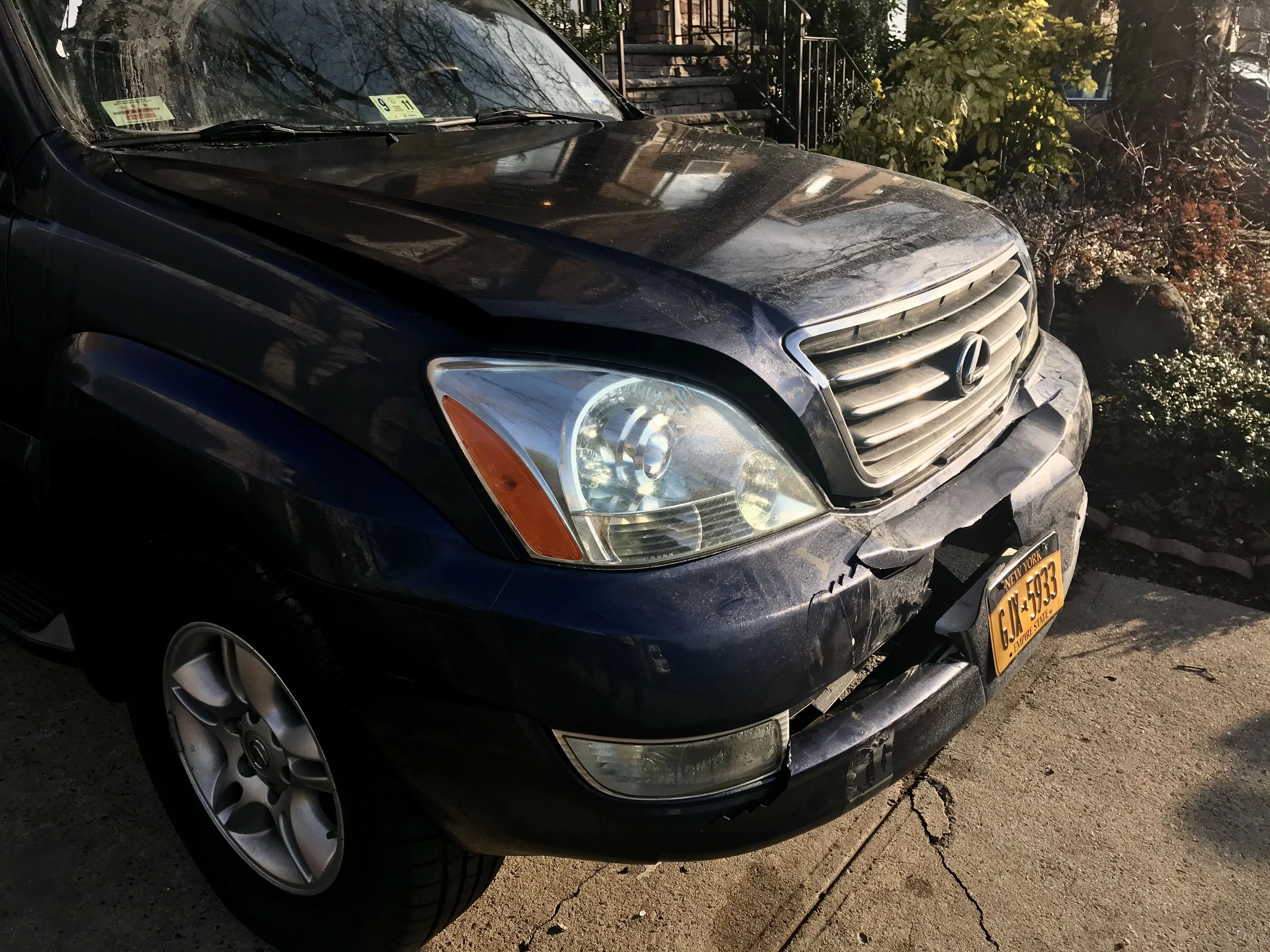

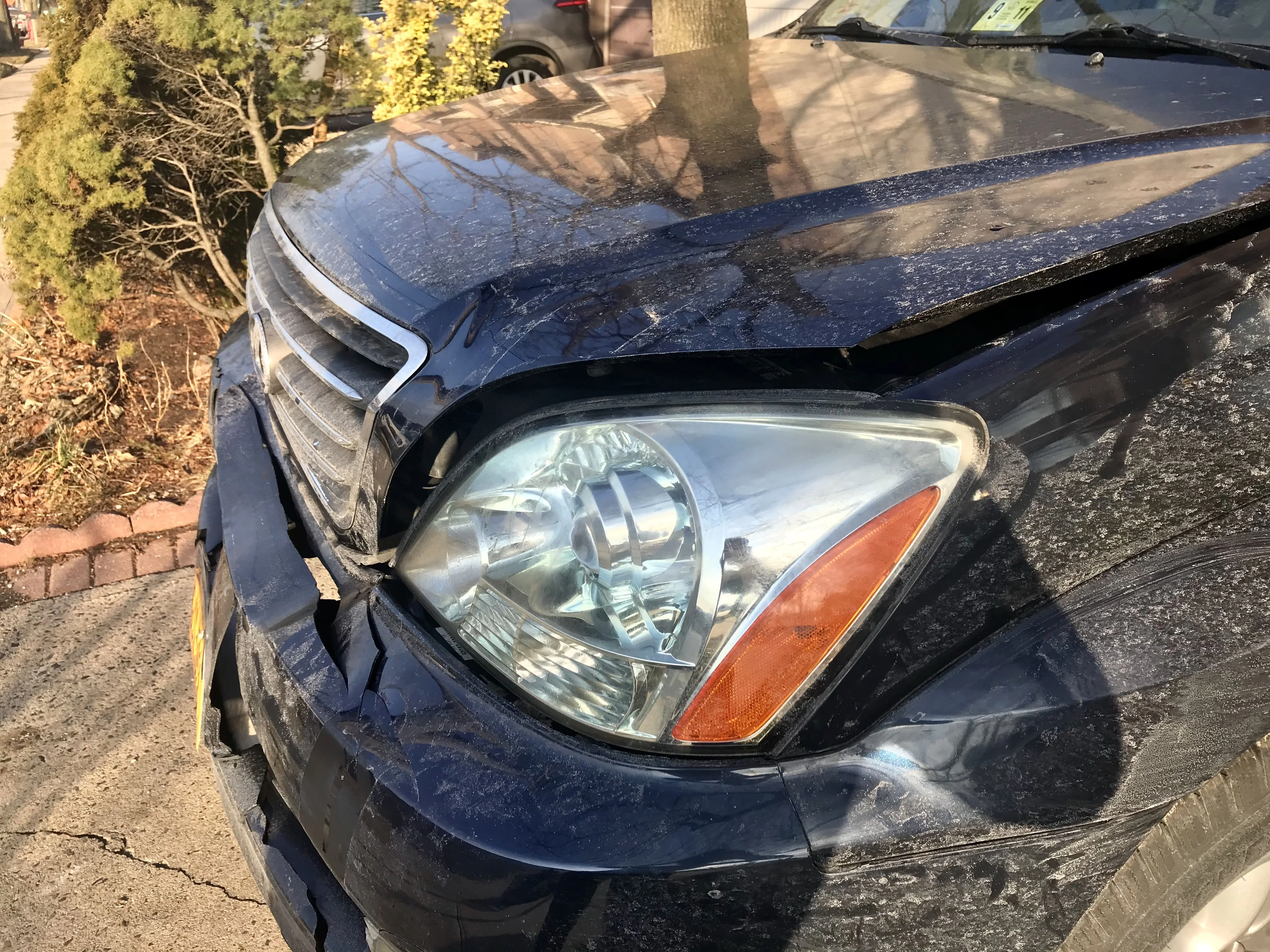

Upon inspection I knew i had some work cut out for me, repairs would include:
  1. Fix/repair hood
  2. Grille cracked
  3. Front bumper cover slated for the trash bin

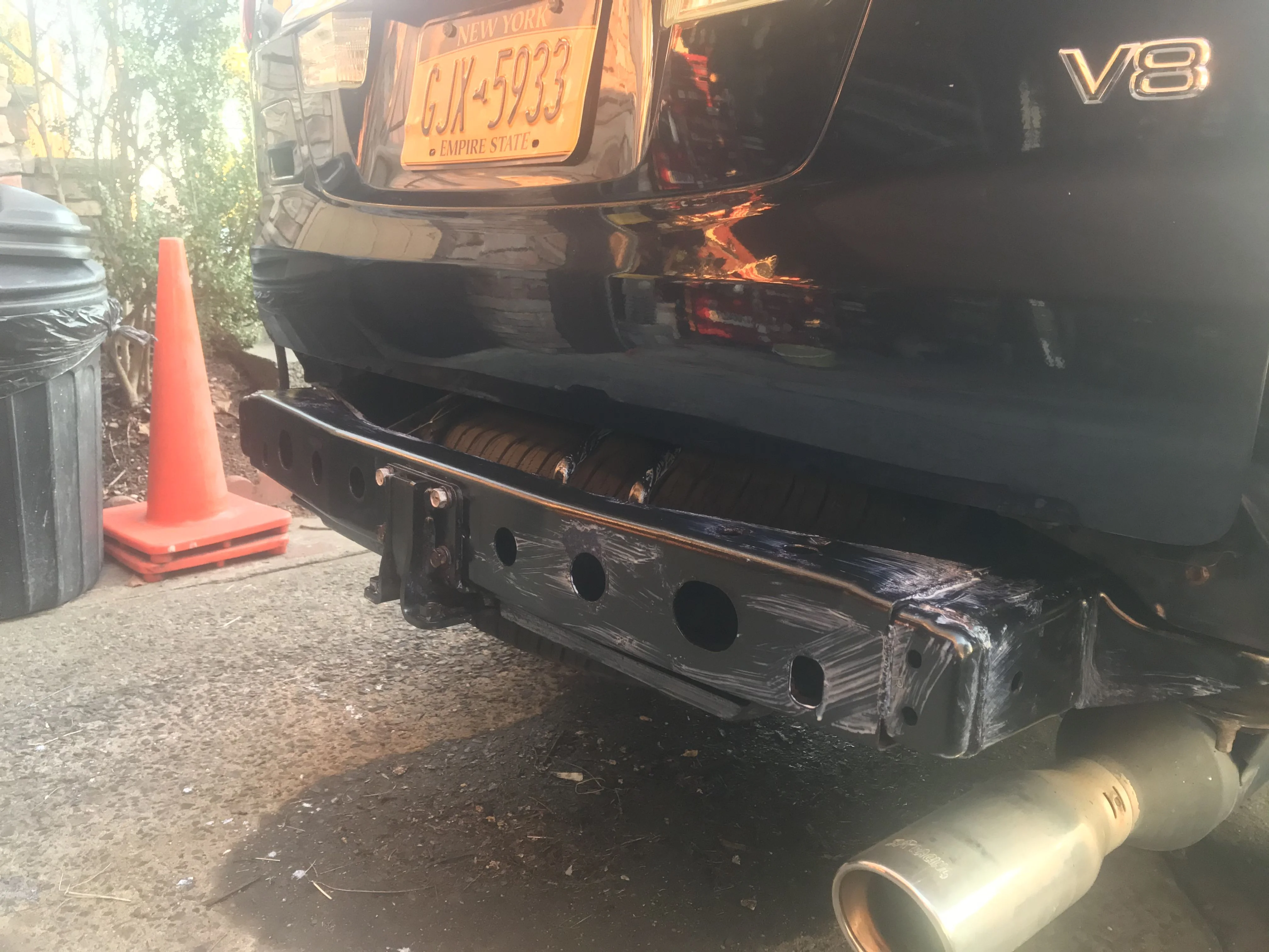

  4. Rear bumper cover damage
  5. Lots of clips/fasteners missing or damaged
  6. Shattered radiator
  7. Bent A/C condenser
  8. Cracked fog lights
  9. Missing left outer CV boot clamp
  10. Airbag light on dash
  11. Only one key
  12. Rotted wiper blades
  13. Cracked digitizer on multifunction display
  14. Failed Mark Levinson Amplifier

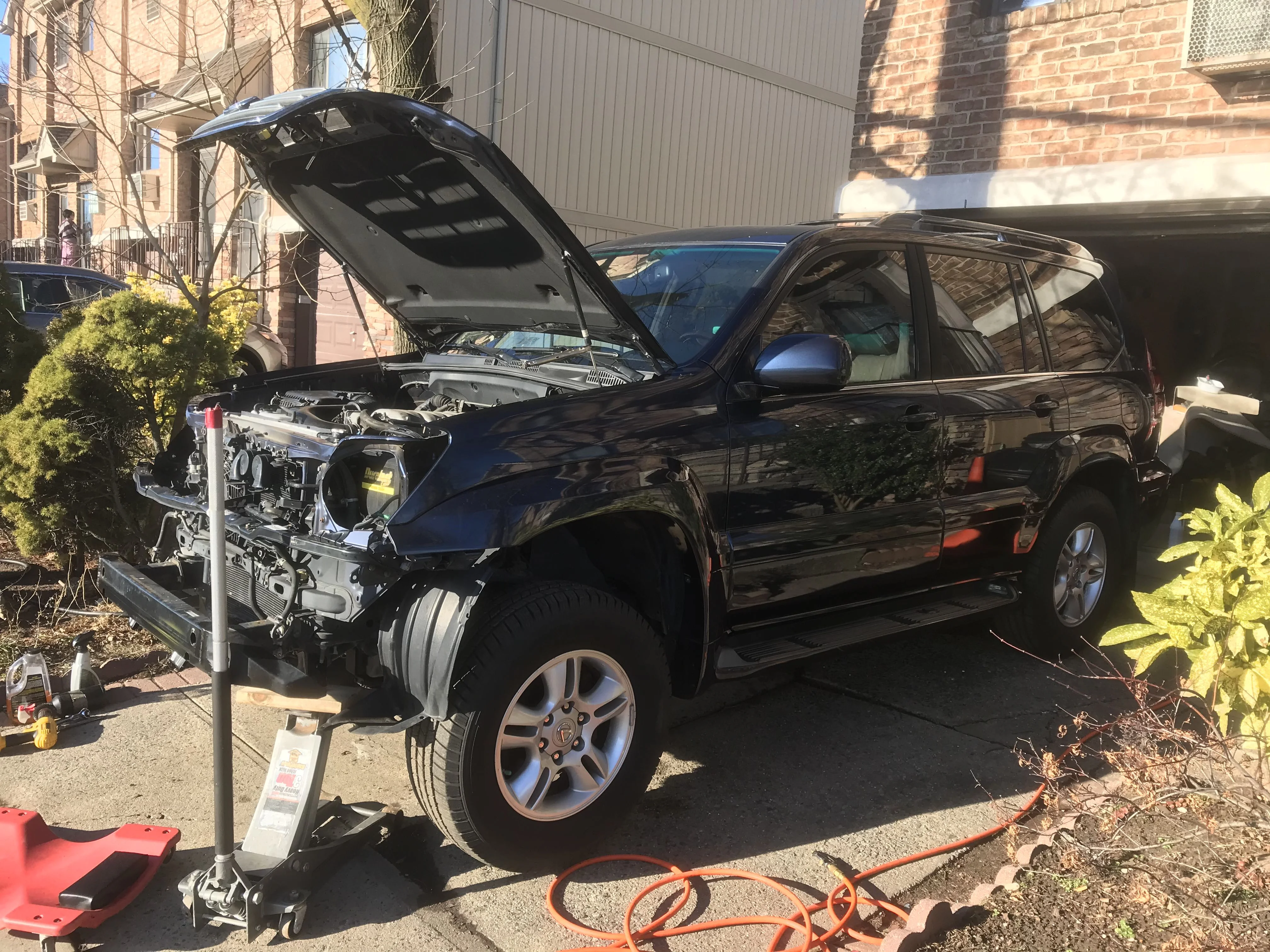

Those were just some of the issues. Armed with lots of enthusiasm I got to work on my free time:
Mostly ordered progress photos below:

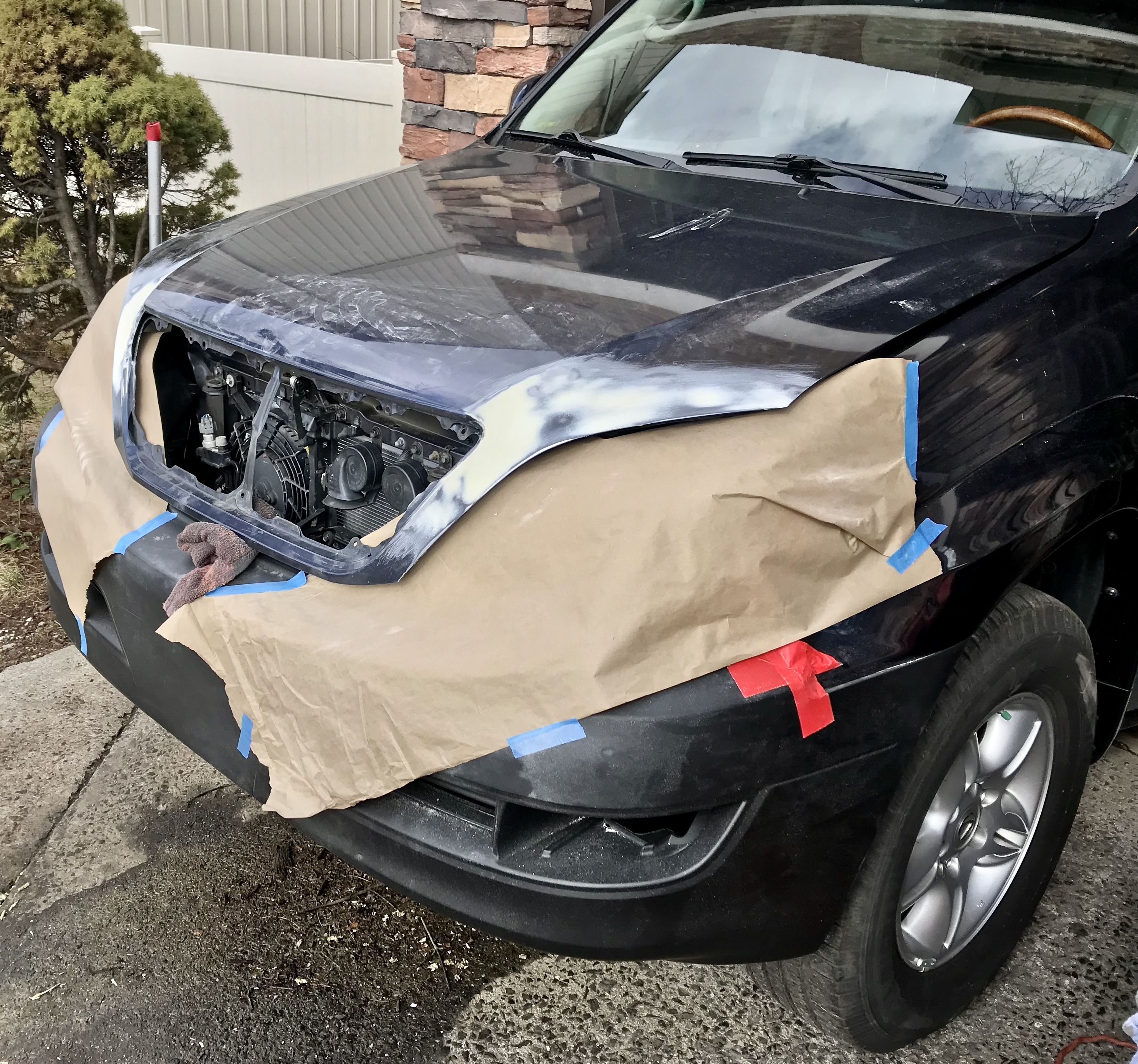

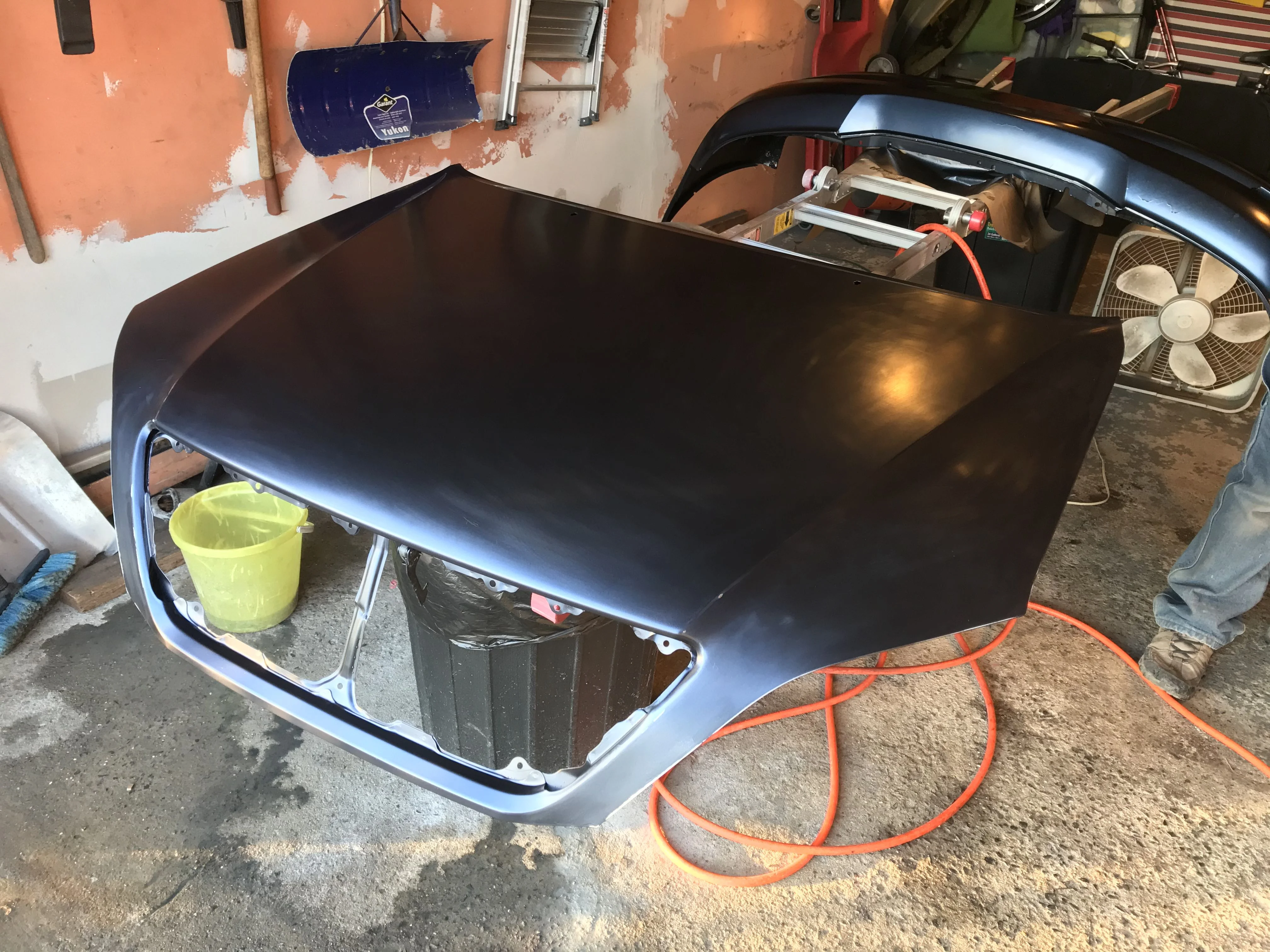

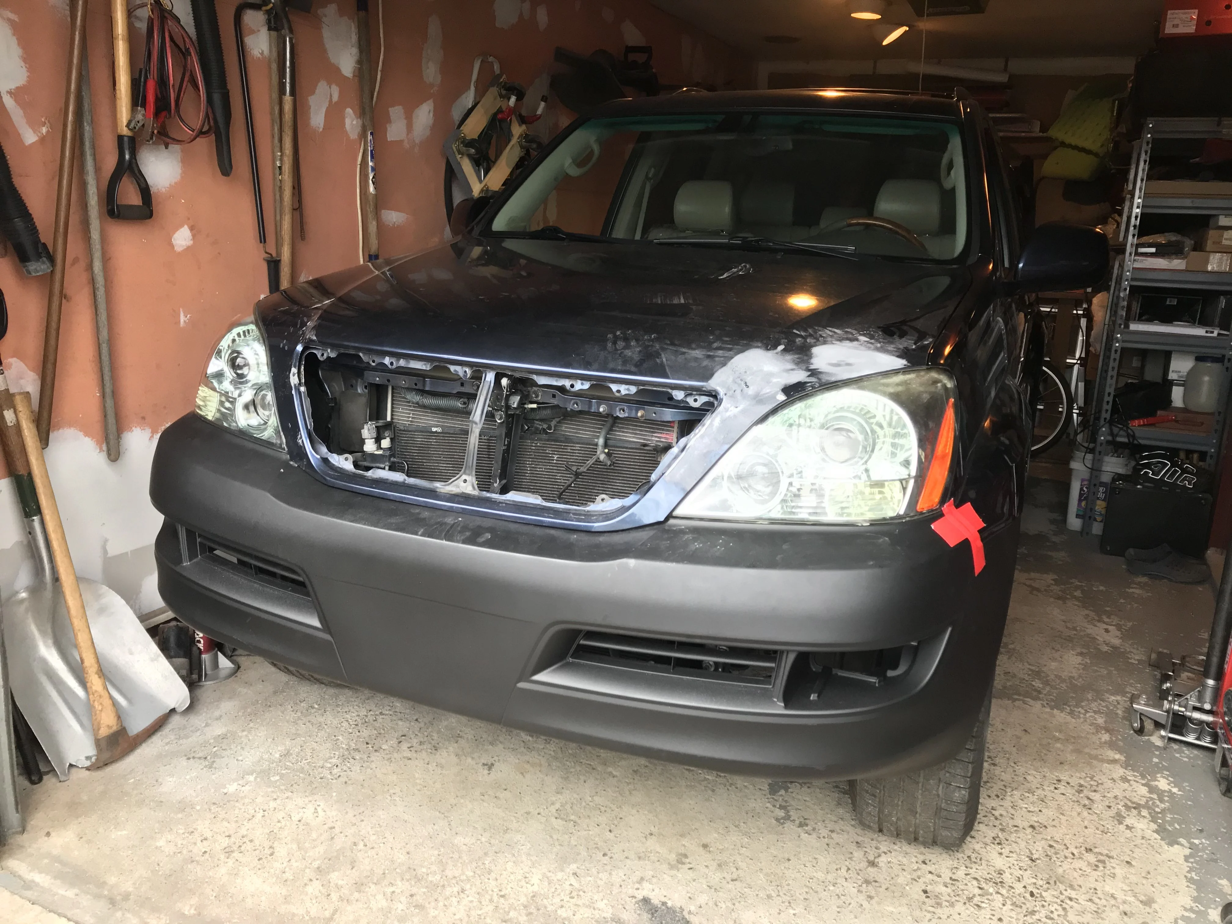

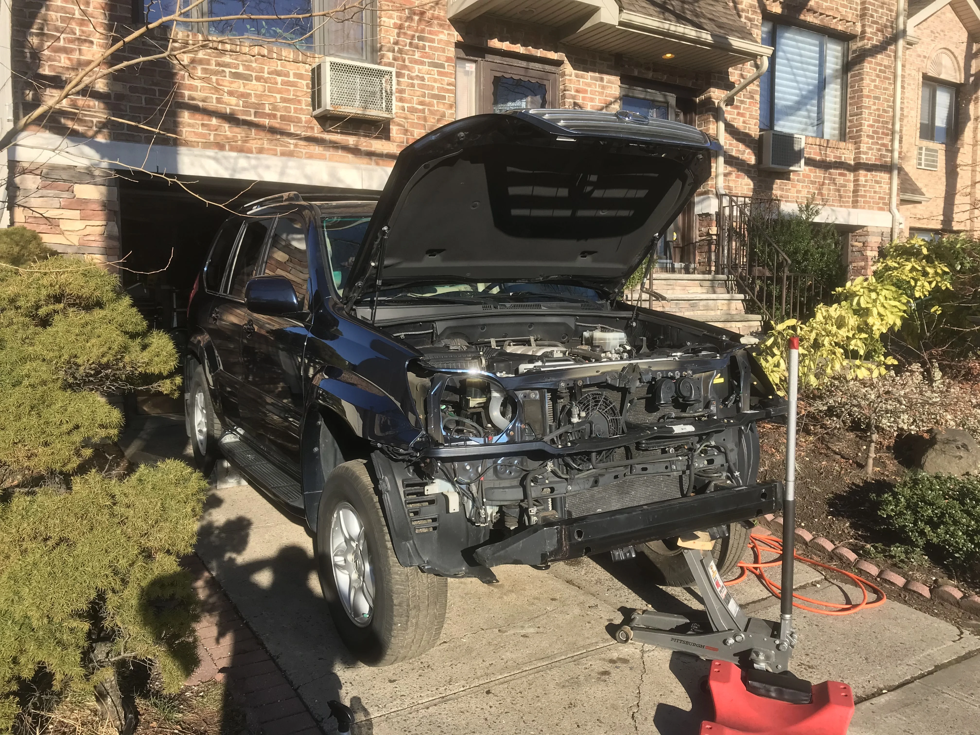

After some tear down I realized that the hood could be saved with some work, and the bent rad support could be coaxed back into shape with a come along and some prying.
The bodywork dragged on as I was doing all of this at home in suboptimal conditions during the conveniently mild northeast winter this year.
Of course while I had the truck apart I took the time to do some rust control/prevention with Corroseal. We'll see how it holds up.
The previous owner did not service this truck at a dealer its whole life, and was apparently not big on cabin air filter maintenance. :-/

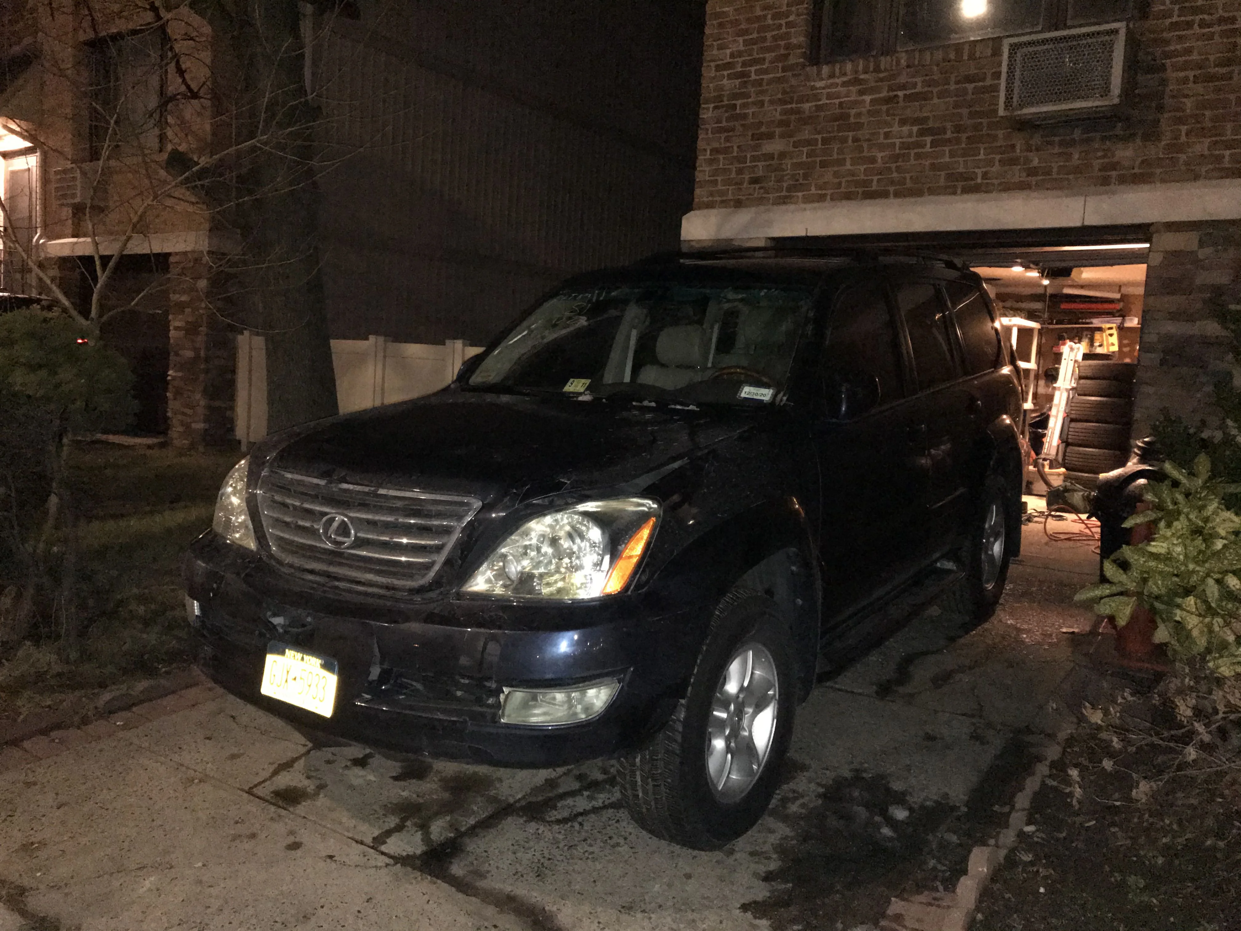

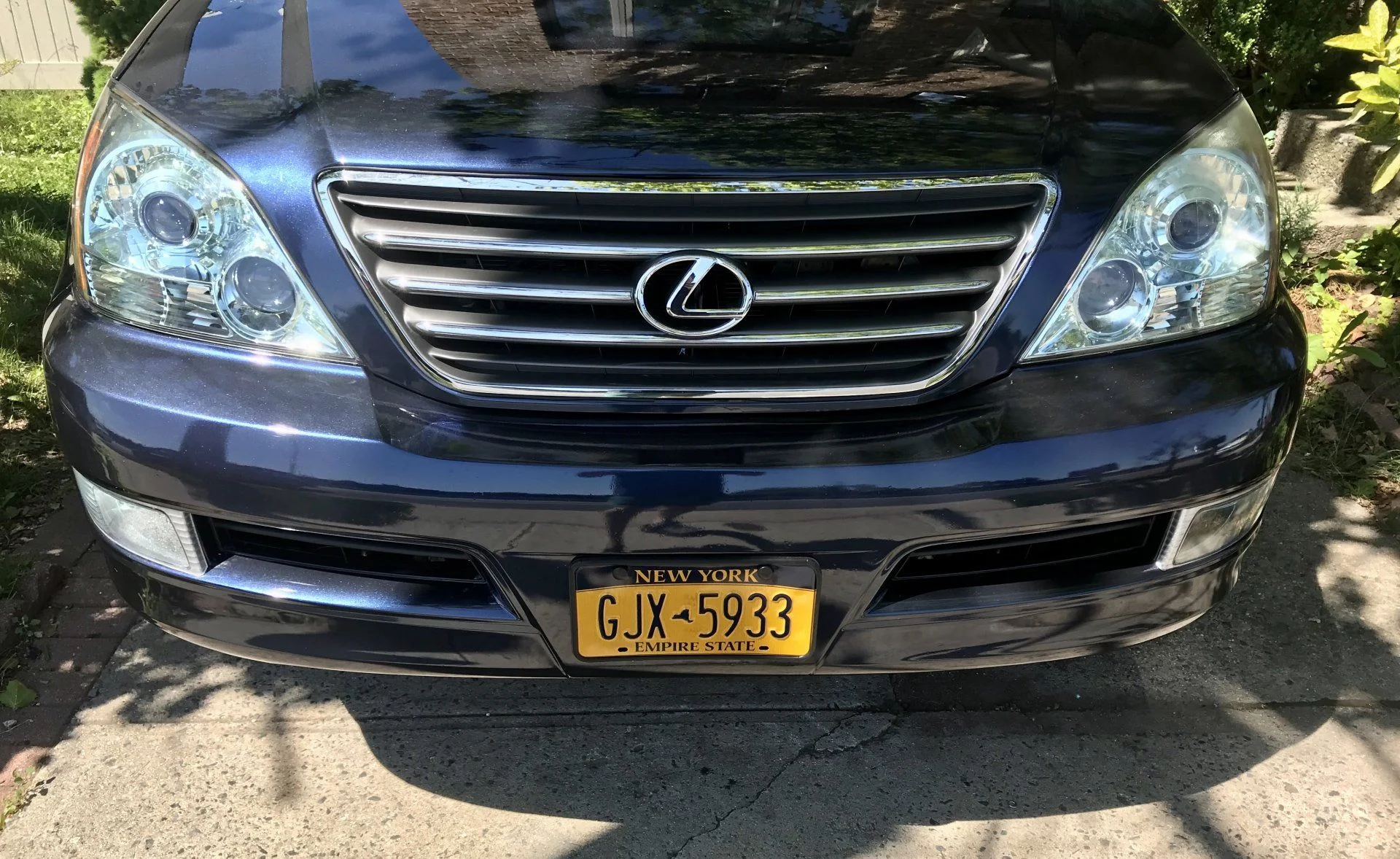

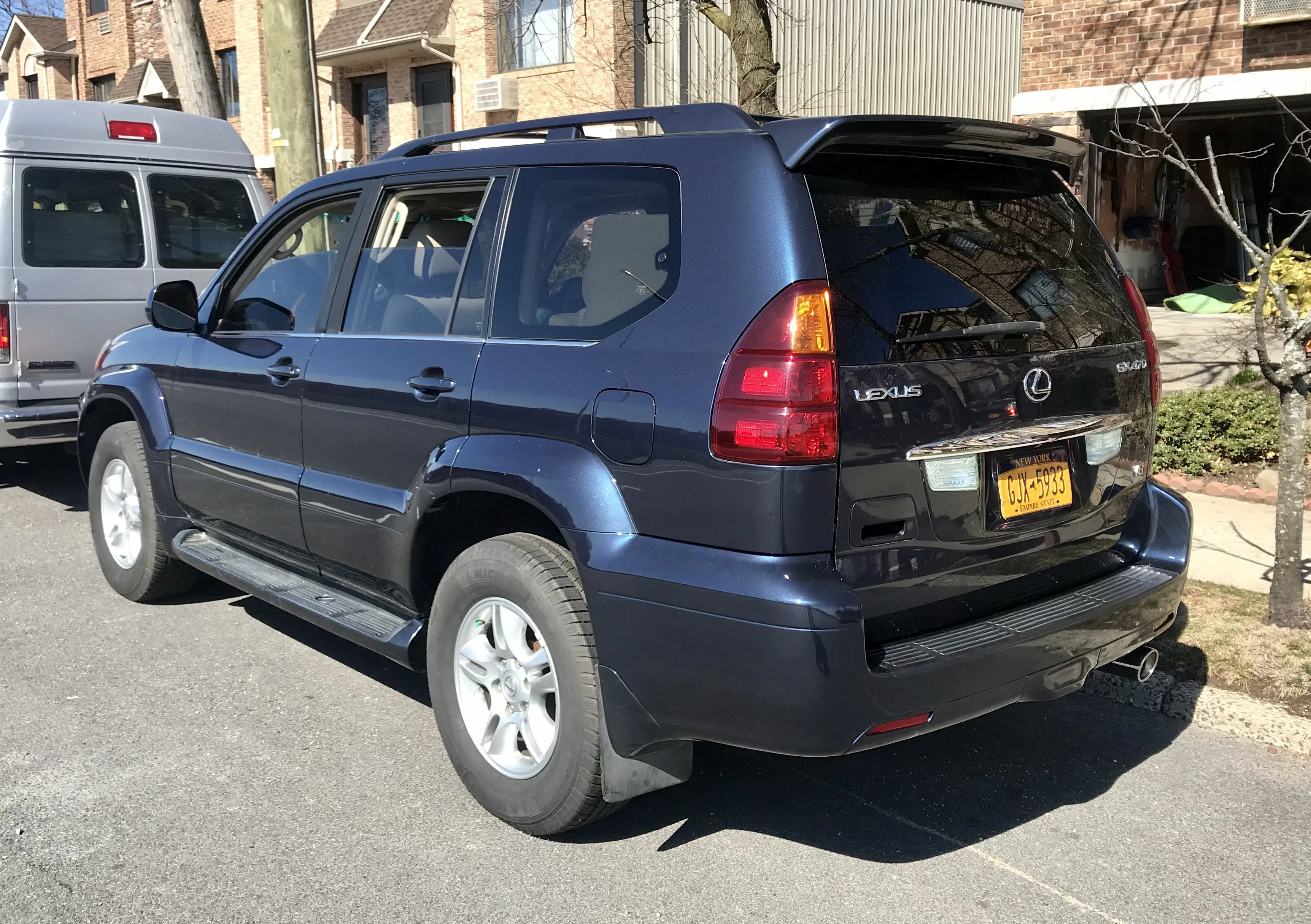

The finished product so far, still needs a few things but is now driveable and presentable compared to its previous sorry state.

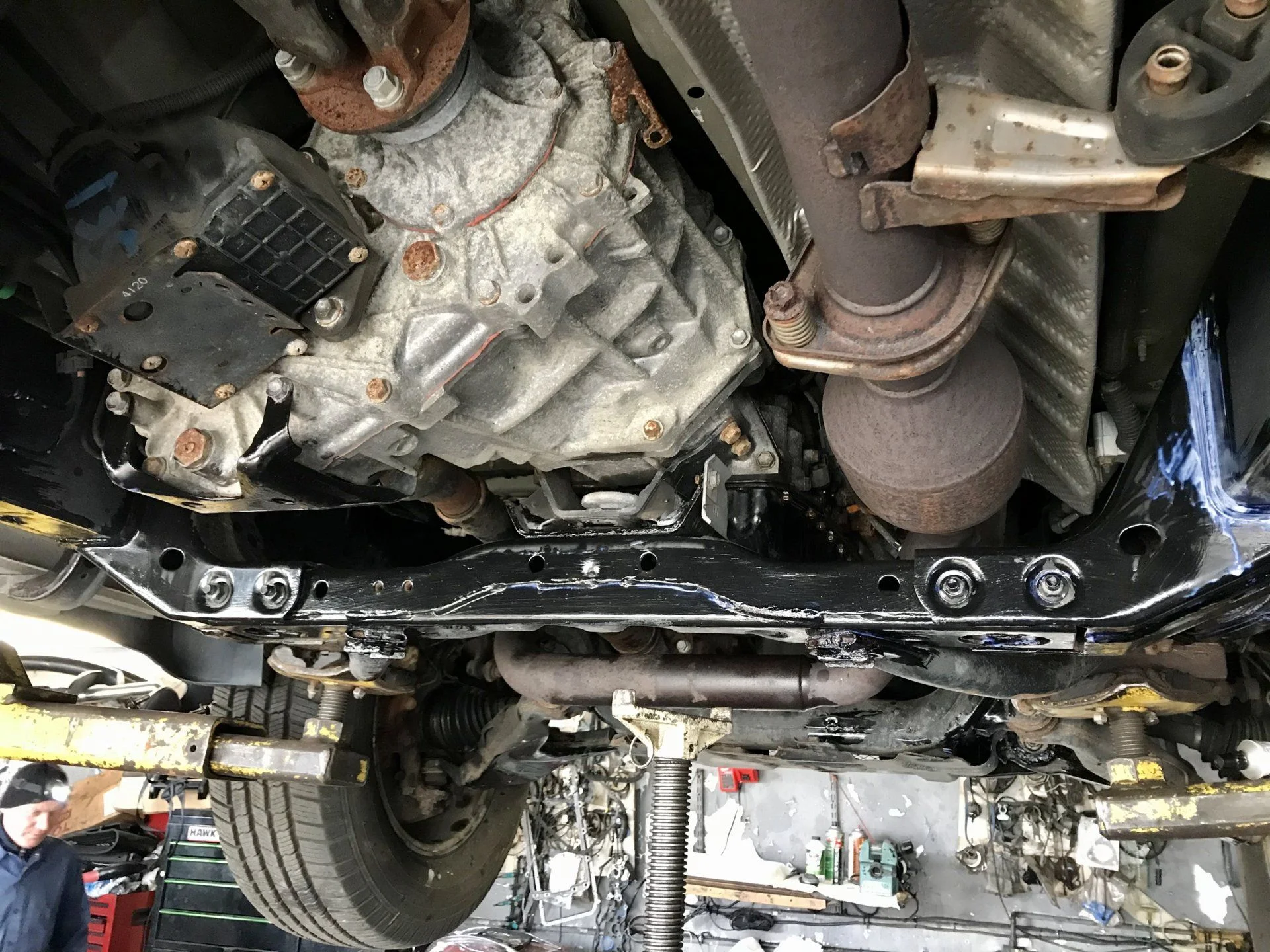

Truck was definitely clean but not completely rust free. Went to grab an oil change and inspection today, also to put in 2 new TPMS sensors. Programmed them with my Techstream running in VirtualBox lickety split, once again all thanks to the information on this here forum! Also spent some time with a wire wheel, wire brush, scrapers, an air hose and some Corroseal to pretty up the underside a little bit. Perhaps maybe slow down any corrosion present on the axle some portions of the frame, time will tell. Fixed the "broken" passenger door light as well, it simply wasn't plugged in :confused: . Also discovered that the rear bags were recently replaced, score!
Some shots of the progress.

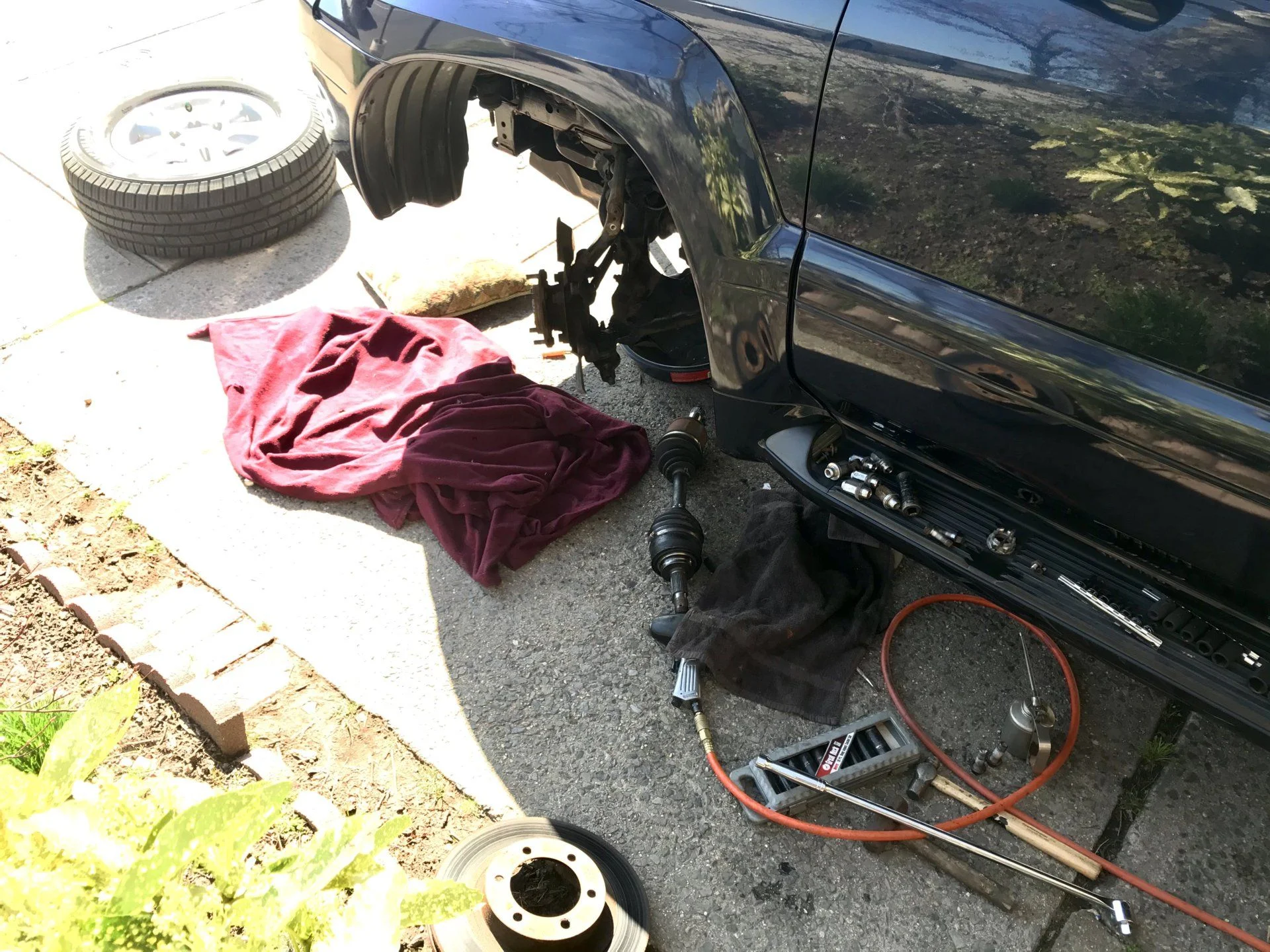

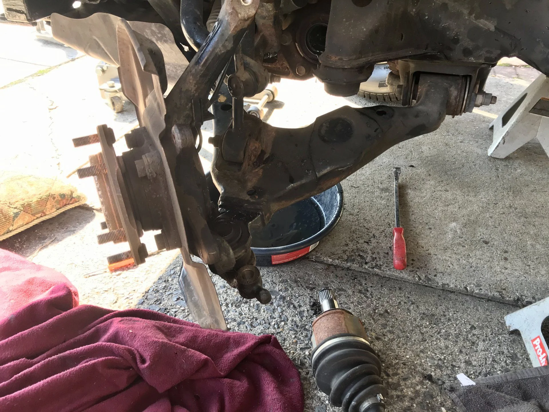

Tackled the outer CV boot this weekend, along with more Corroseal application and changing the front diff fluid while I had the axle popped out.

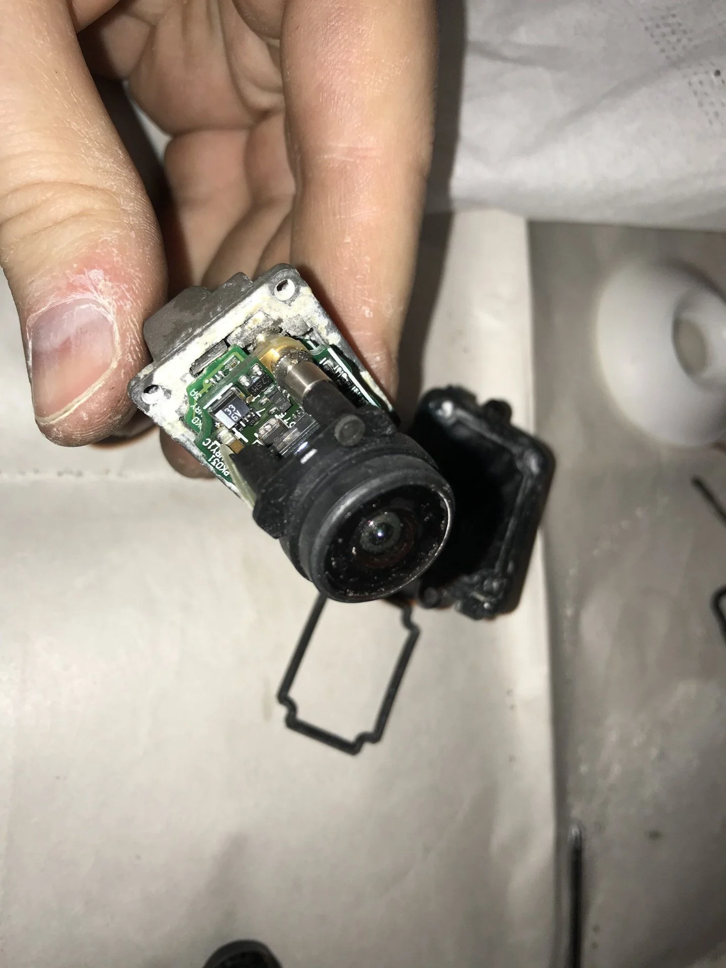

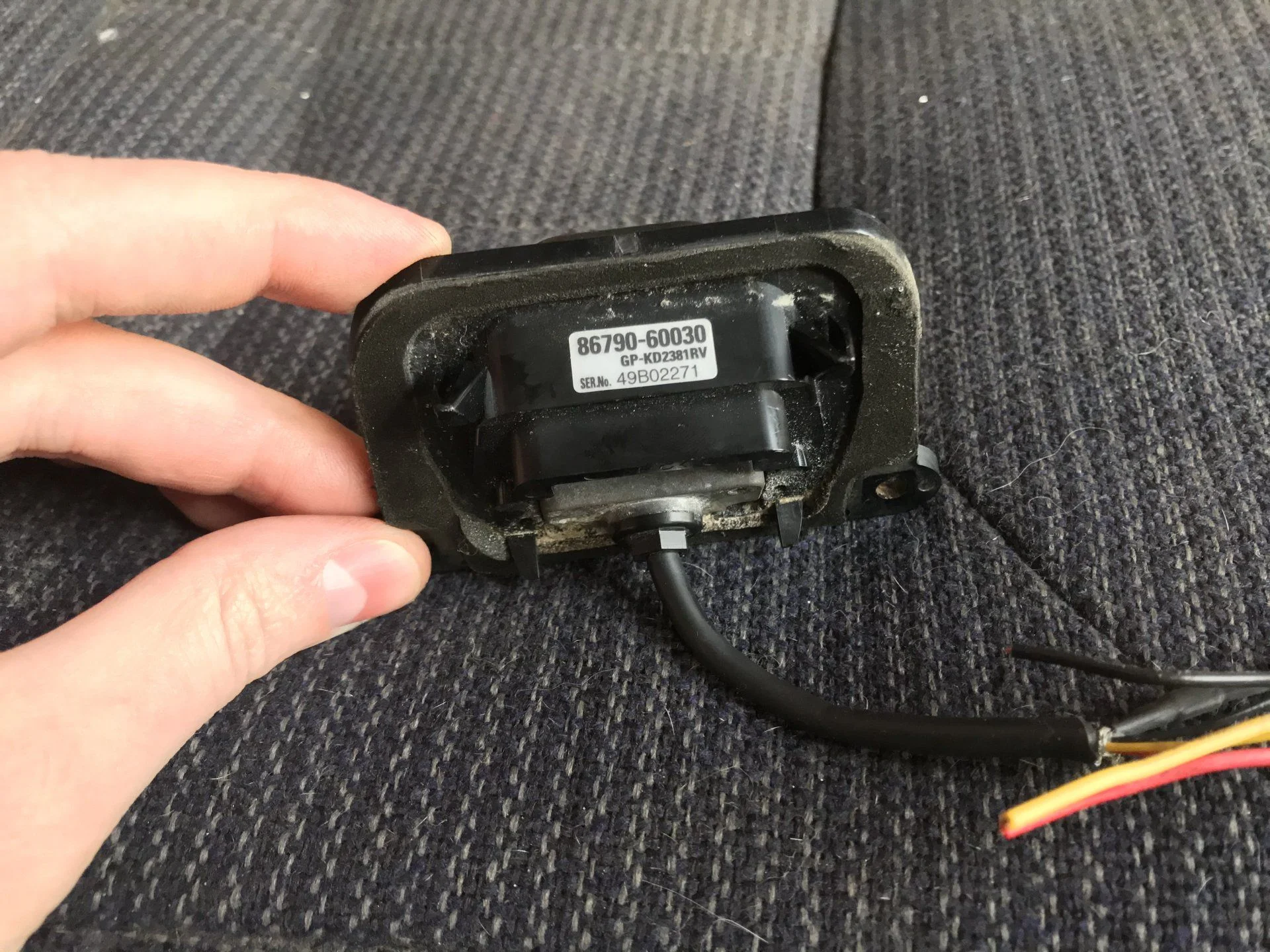

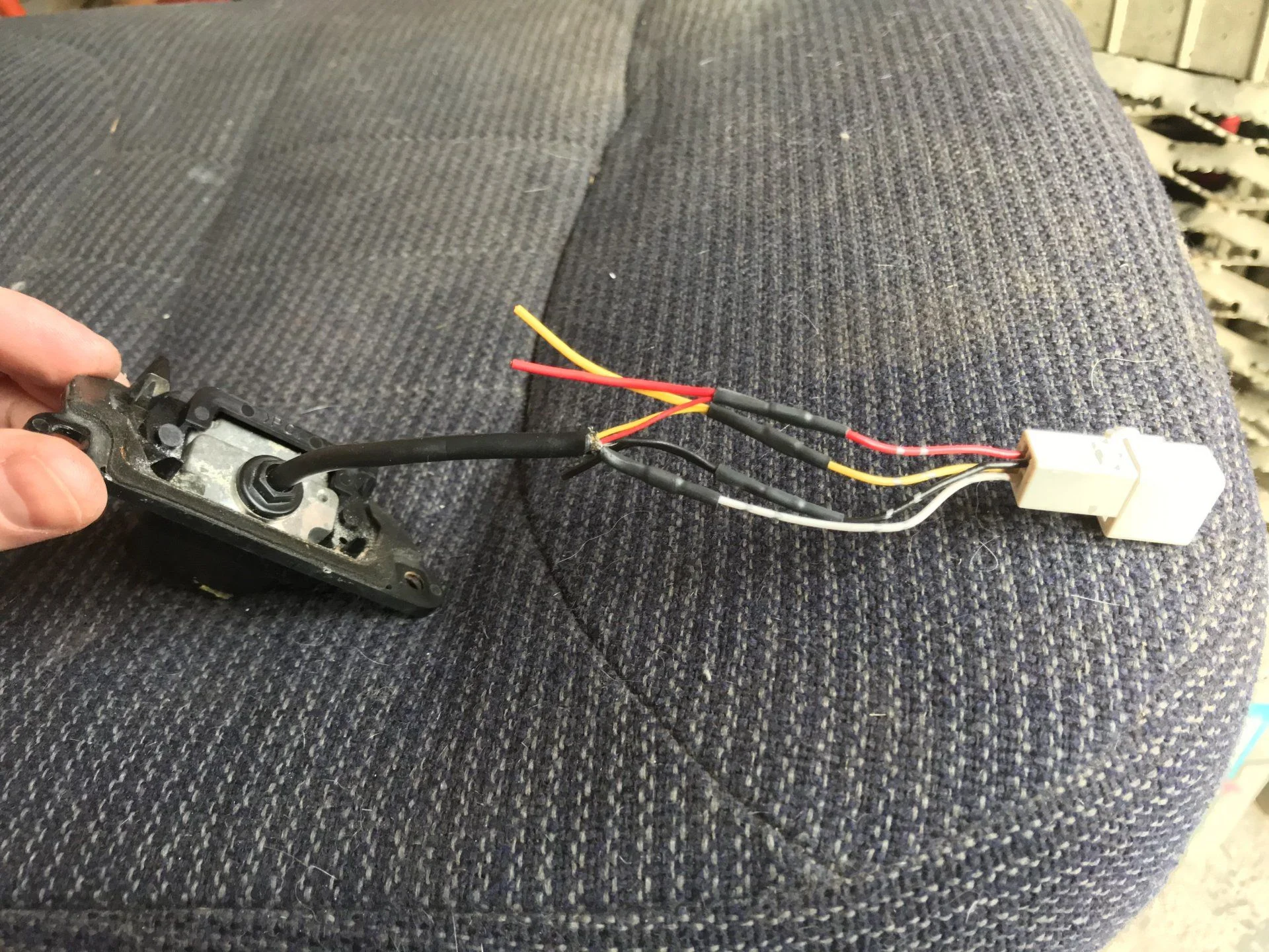

One interesting tidbit I thought I'd share with you guys is the rear view camera repair.
The state of my OEM rear view camera after removing it from the tailgate(a pain in the butt to be frank.) Look at all that oxidation!
Upon discovering what a replacement from Lexus goes for (+$350) I was shocked and quickly went to work researching on how I could fix this cheaply. The internet has lots of information on this subject so it wasn't too difficult to figure out a plan of action. Some helpful links I found below:
Part number for the OEM cam in case anyone is interested:
Once I opened up the wiring I realized that it was a rather simple job, with only 1 gotcha. The factory cam is 6v and not 12v like most back up cameras you can purchase for a few $ online. I had to order one from China which was 6v specific and a little more expensive, it took a little while to get here(about 1 month.) After some soldering/heat shrinking she works perfectly! Furthermore I had to hot glue the new cam in place since it was a weird size/shape and did not fit the stock location without hacking up the old housing, so I opted for the hot glue :)
Shot of the OEM wiring harness below, the new camera(and all backup cams as far as I know) can literally be wired by color.
OEM HARNESS <> AFTERMARKET CAMERA
Red <> Red
Black <> Black
Yellow <> Yellow
White <> White (will likely be a black wire on the aftermarket camera which is paired with the Yellow wire)

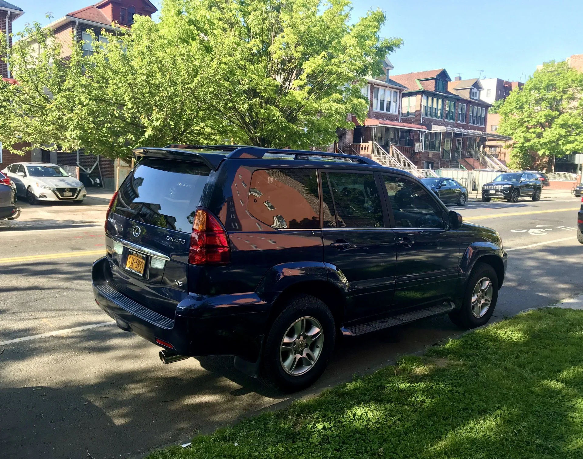

Shot of the truck for fun. Loving it so far.

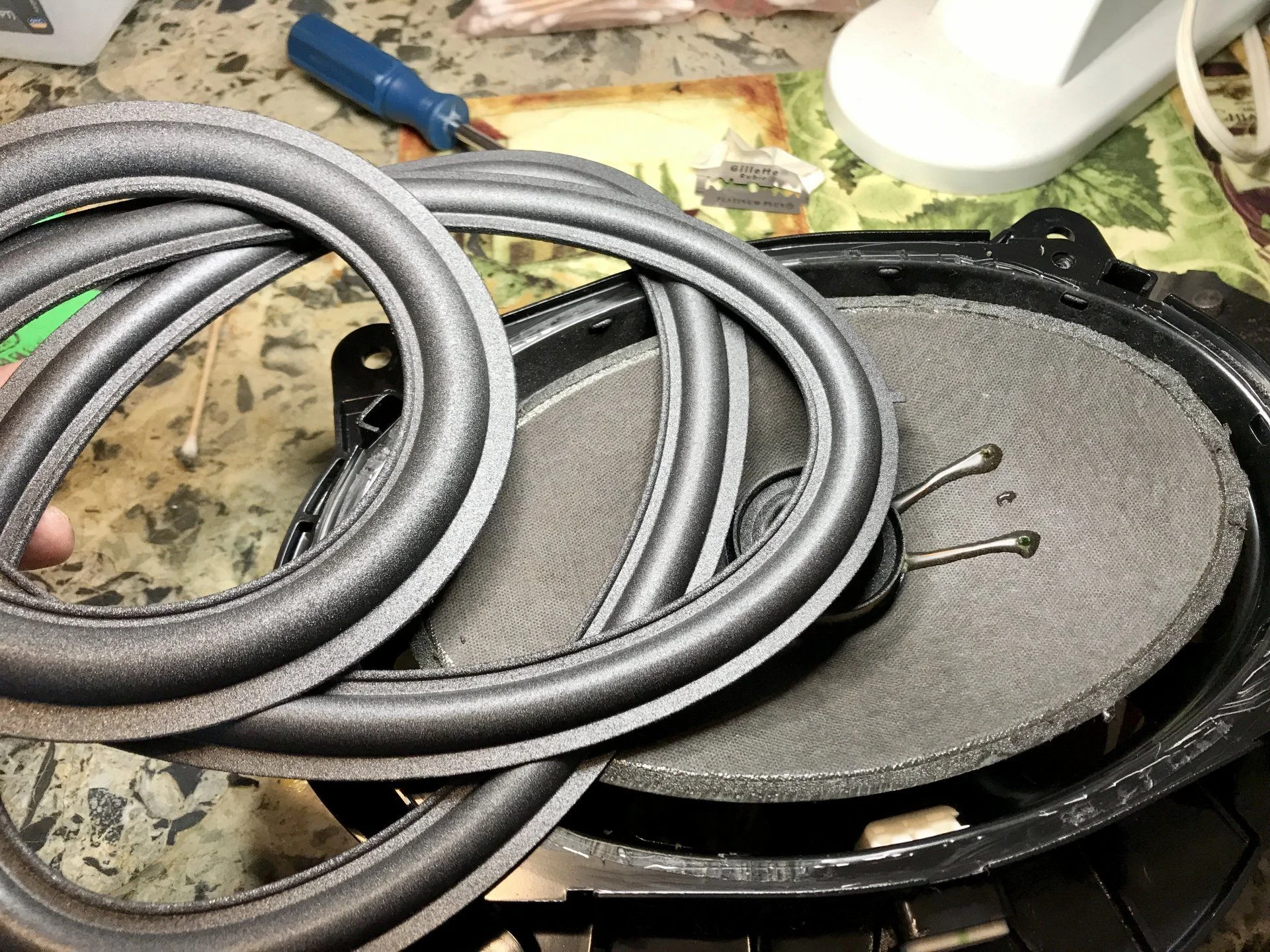

- Re glued the torn front speakers.
- Replaced burned out switch bulbs with green LED's. Does anyone know if the dimmer switch has a replaceable bulb in it? Couldn't figure out how to get to it if there is.
Photos below:

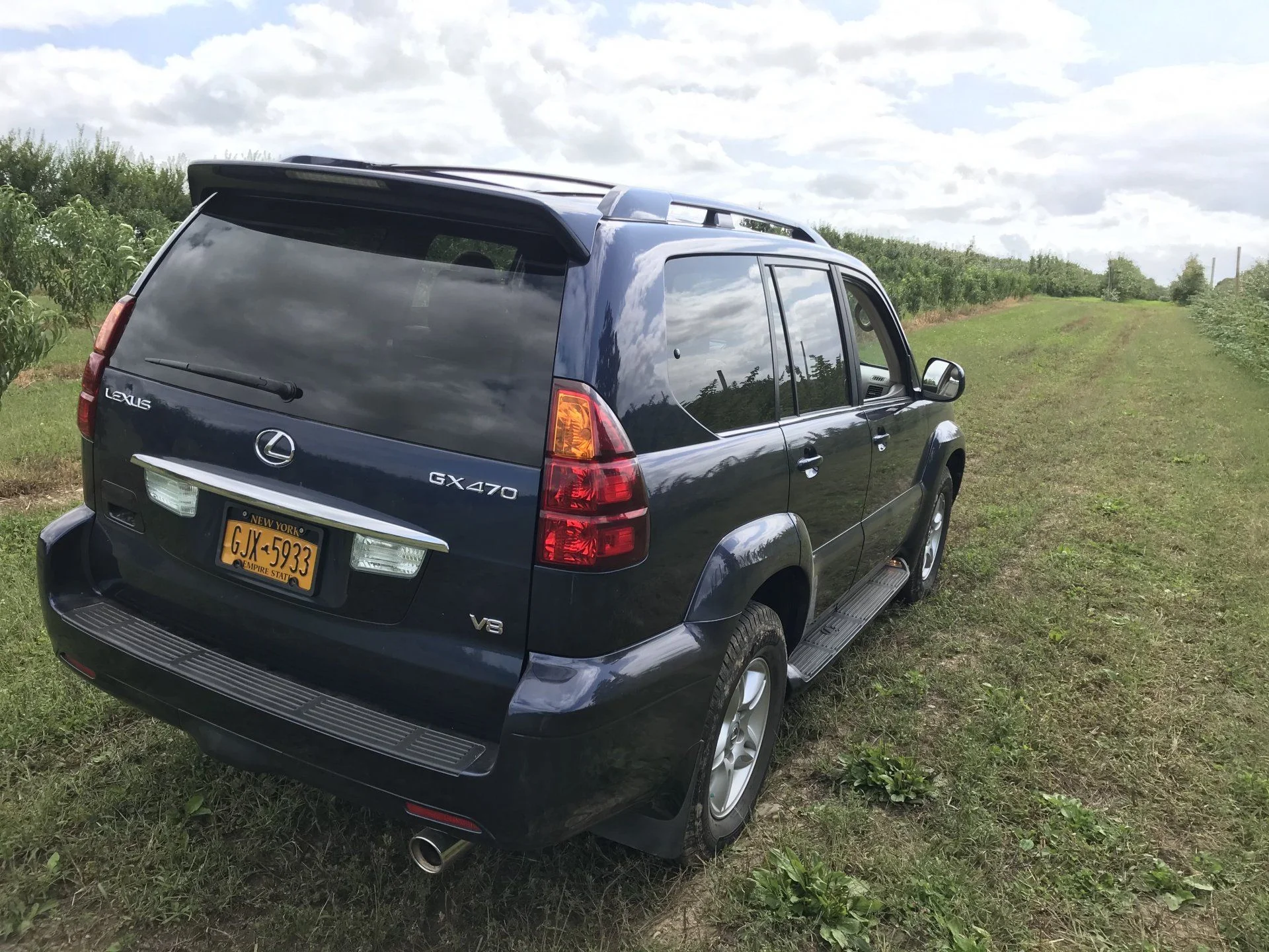

Did some "off roading" this weekend if you could call it that. Got to test the hill descent control + low range over some drainage ditches at the apple picking spot. :cool:

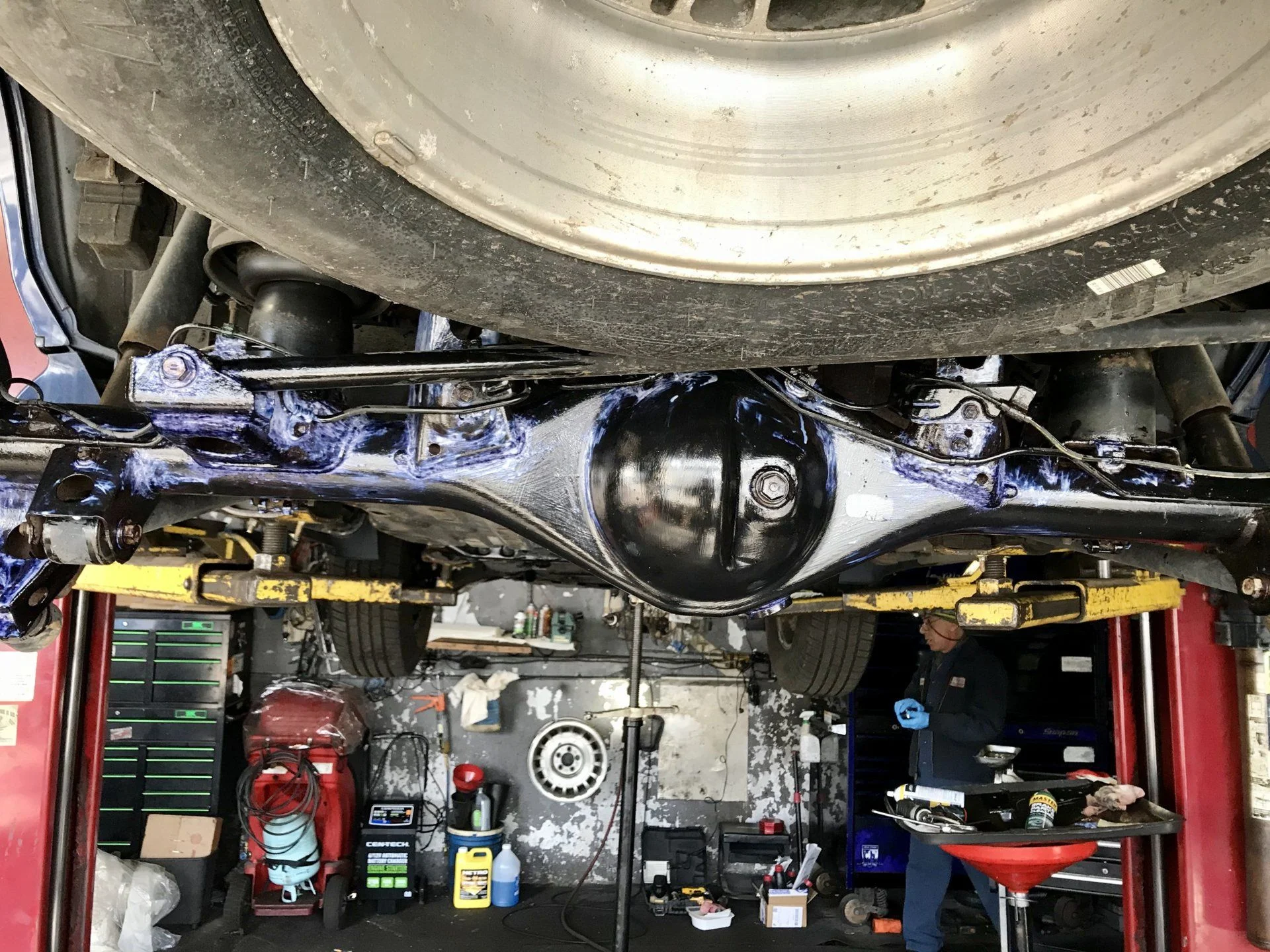

Slowly running out of things to do on the GX, still need to do the t-case and rear diff fluids, perhaps this weekend. Then will drive over to a buddies shop, place it on a lift, and spray the inner frame rails/crossmembers with some fluid film for a nice happy life in the northeast :)
