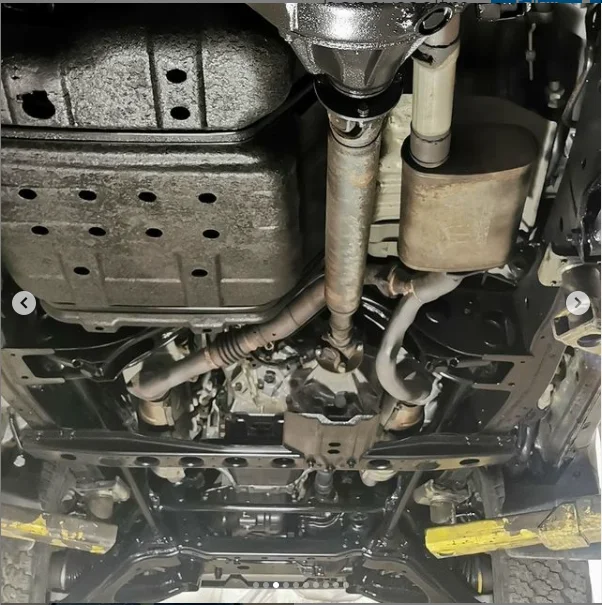

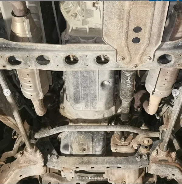

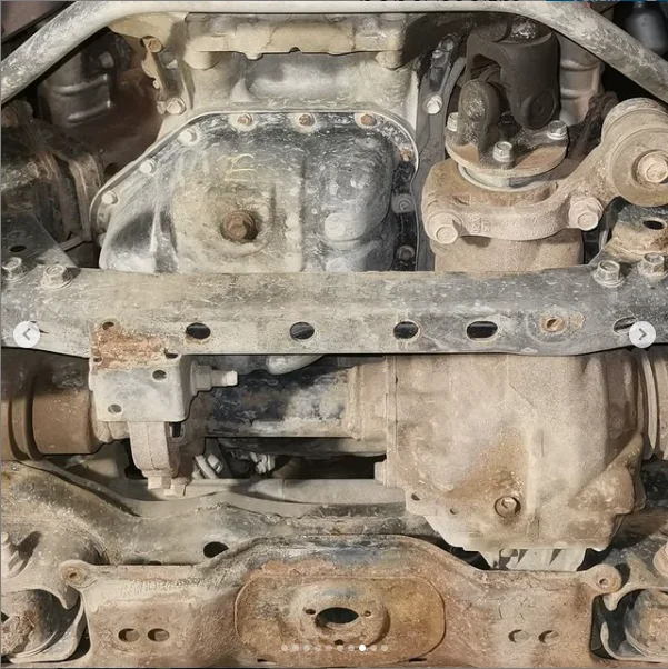

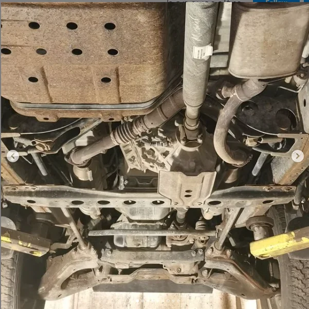

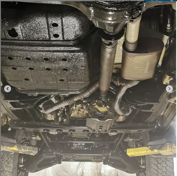

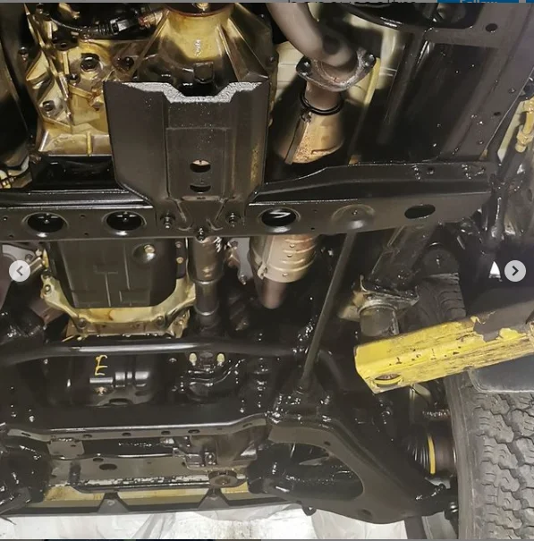

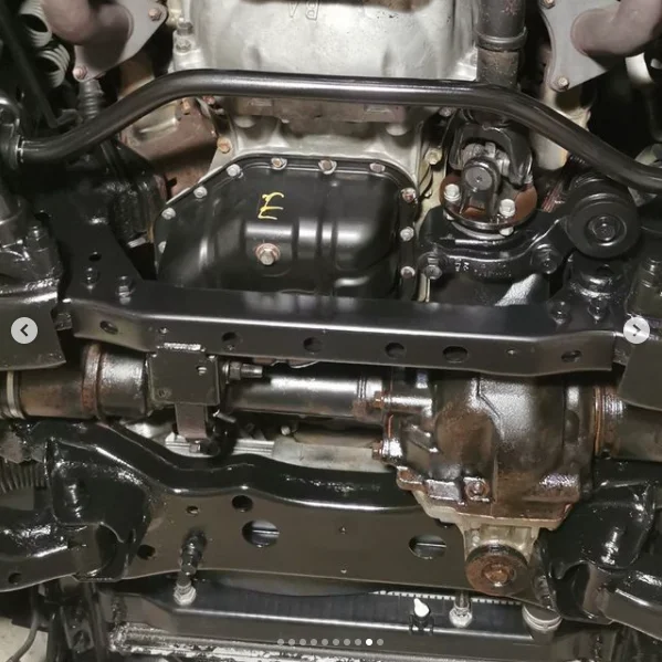

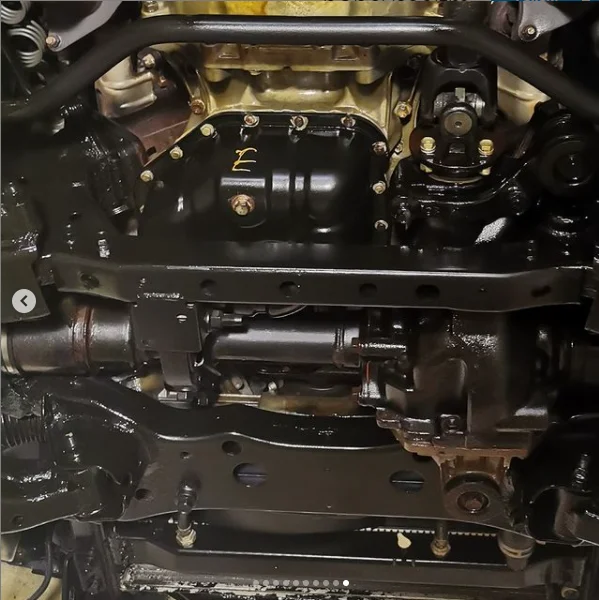

As promised - here's pics:
Work performed by Sublime Surfacing (3hrs north of me in Edmonton, Canada)

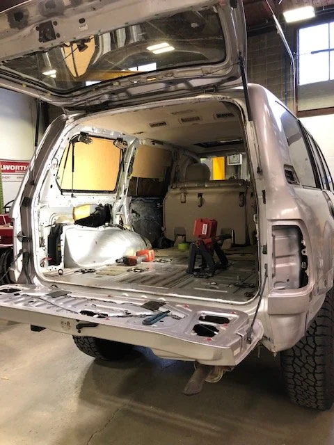

Cost $2300CDN. Undercarriage alone is about $1700, but I also had the front and rear bumpers removed, engine bay cleaned and wheel well liners removed/treated.
Process takes a couple days, and then a couple more to let the product cure. This is a fairly novel business, but I expect to see dry ice/vapor honing to increase in popularity given how busy Sublime Surfacing is.
A friend of mine bought the equip ($100k+) to do this process locally in Calgary, but he mainly focuses on aircooled porsches (dry ice blasting is especially effective at removing Cosmoline from undercarriages).

I would tend to agree - especially with a conventional rubberized coating, what you describe is a reality. I also think the only way to start completely fresh is pulling the cab off the frame, removing all components and doing an acid dip or equivalent process followed by fresh paint etc - but this process, especially if you're not doing it yourself, could easily exceed $10-15k.
I'm happy to guinea pig this product/process, which is quite a bit different than just spraying a tar-based undercoat product on the undercarriage. Our roads are treated with brine and salt throughout the winter, it should be apparent within a year or two whether the treatment was worth it and holds up. If I can mitigate further corrosion and add 10yrs to the service life of the vehicle by slowing a rust death, I think it's worth it.
