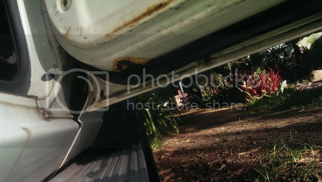

About two weeks after getting back from the holiday I noticed a little brown stain at the bottom of the driver and passenger side front doors, in the quarter panel in the gap adjacent to the bonnet, and a few other places. Awesome. I noted to myself that I should get to that as soon as possible.
Two weeks later (sooner than possible), the rust was literally bubbling through the paint.

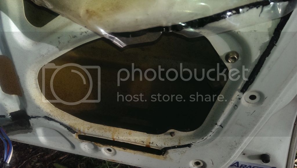

What I found when inspecting the bubbles
So, the door cards had to come off, and I was expecting to see that all the Tectyl had degraded and flaked off the panels, I was wrong.

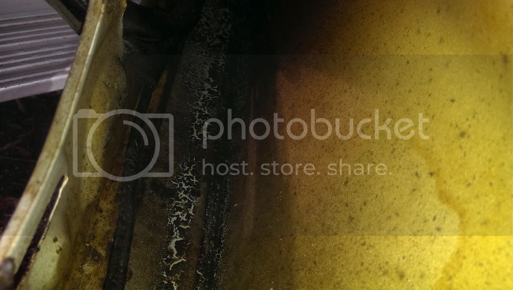

The Tectyl at first inspection looked fine and still had good adhesion to the paint, but...
...this is what happens when it is exposed to sitting water for more than a day or so. We all know that water will get inside the doors past the wiper seals/felts. I clean these areas thoroughly and also use a wand to wash inside the doors to get the salt out.
I have also observed that with new seals, the seal actually obstructs the drain holes (except the forward most hole) and prevents water from coming out unless you open the door. Consequently, water can get in and get stuck in the door cavity - especially if you park on a hill and the water backs up behind the forward most hole.
The rust bubble shown in the first pic in this post appears to have started in one of the holes where the door seal plug pushes through. The rust bubble was so flakey that I could pull the seal plug out with little force and could push a screwdriver handle through it. I can't say for sure, but when looking at the other plugs and the coating that was still on them, I think the Tectyl just flaked off and the plug wore a hole in the paint.
Now, I have no proof of the following but is my best guess at what has happened. At various times I had pulled the door cards off and inspected inside the doors. I have also done inspections in other areas. At times the Tectyl had dried and cracks had started to appear, but it seemed to still be stuck down to the paint. When this happened, I'd spray the area with alcohol and park the car in the sun to make sure there was no moisture in the cracks and then reapply Tectyl to the affected zone while still warm - as recommended by Valvolene. The alcohol was sprayed over all of the area in the image above, and you can see that only the product at the bottom has been affected, so I don't believe the alcohol has caused the issue. I am wondering if the added layers/thickness of Tectyl has caused shrinkage and caused it to crack and peel off the paint. Regardless its annoying.
After inspecting further, and particularly in the quarter panel to see why the rust bubbled up there, I have found that the Tectyl has failed in the same way at the very top of the panels. To be clear, I have not driven the cruiser through 4' deep water, and parked it there, so there is no way that water has pooled in these areas. All I can assume is that condensation has caused the same issue to occur. I am also conscious that the tops of the quarter panels go through significant thermal cycling in our climate. Anyway, the Tectyl failed here also, and I hadn't put any additional product up in these areas as I had in the doors. Due to the location, I am also not sure that my preparation process was as thorough in these areas.

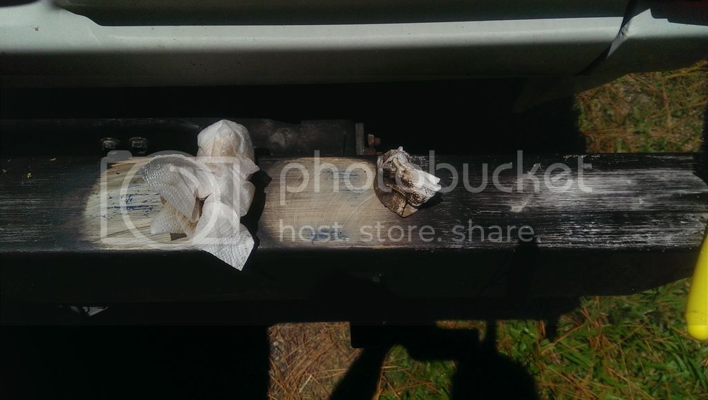

The reason for my decision was that I have been using the chassis black on my rear bar for the last 3 years, and while it rubs off and degrades in UV, there has been no rust on the bar at all where it is covered in chassis black. The other thing is that because it is bituminous it is easily removed, or simply reapplied over the last coat. See image below.
Right hand side: chassis black removed from using bar as a step (twice a week for 15 months).
Middle: chassis black rubbed off with Mineral Turpentine and paper towel (took about 1 minute).
Left hand side: chassis black removed with unleaded petrol (took about 20 seconds).
Note: you can see how thin the product goes on, there is 3-5 coats on this bar, depending on the location.
