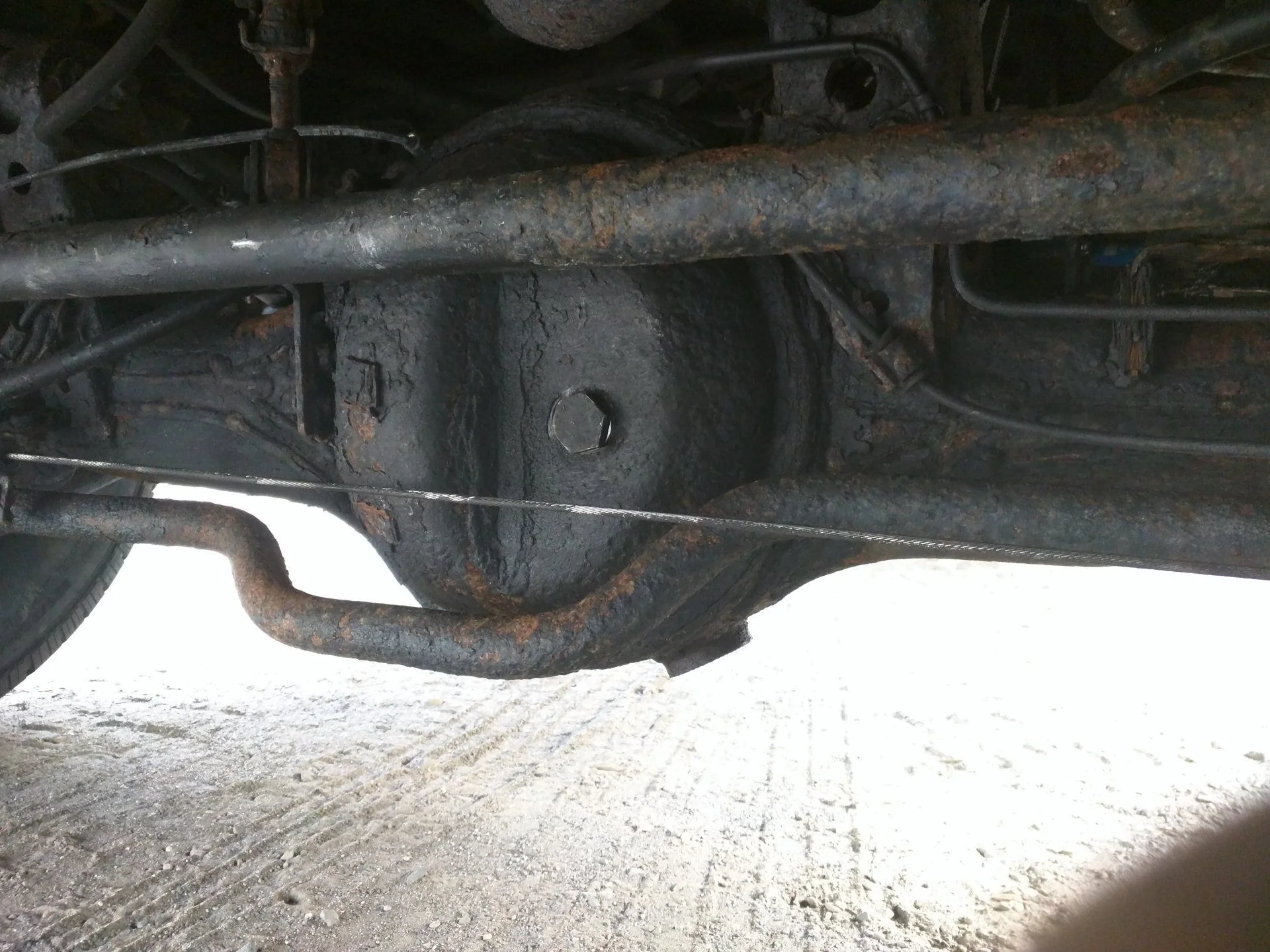

I couldn't get the hitch off. I ended up grinding the whole rear end down and just painting it. I had already wheeled off a ton of rust, so I just kept going and got that whole rear section ready for the Fluid Film.
Took the front bumper off too and repainted it. The truck looks great now from the rockers up.

OK, another update. I got the running boards off this weekend and also removed the front bumper and hit it with a decent looking rattle can job. This is what the rest of the truck looks like as of now. Still more rust to tackle on the under carriage and a couple of items like a front axle job, but I think it's starting to come together.

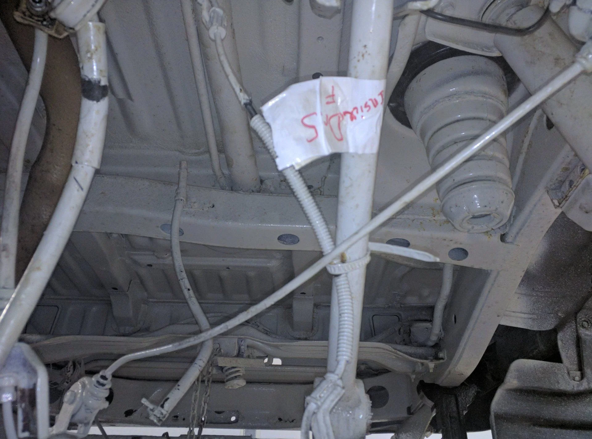

Too bad you can't sandblast the entire belly and slap some paint on it!

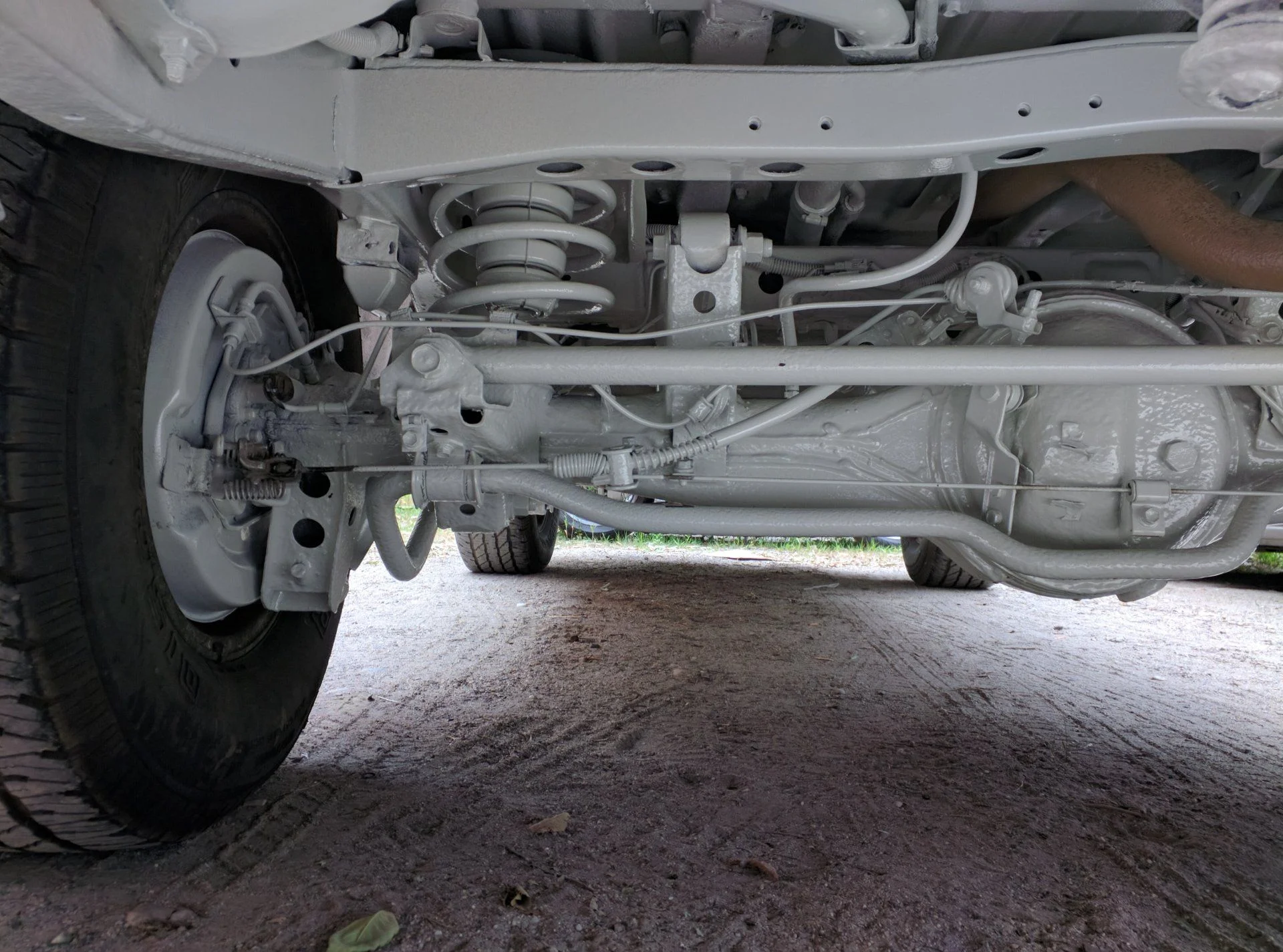

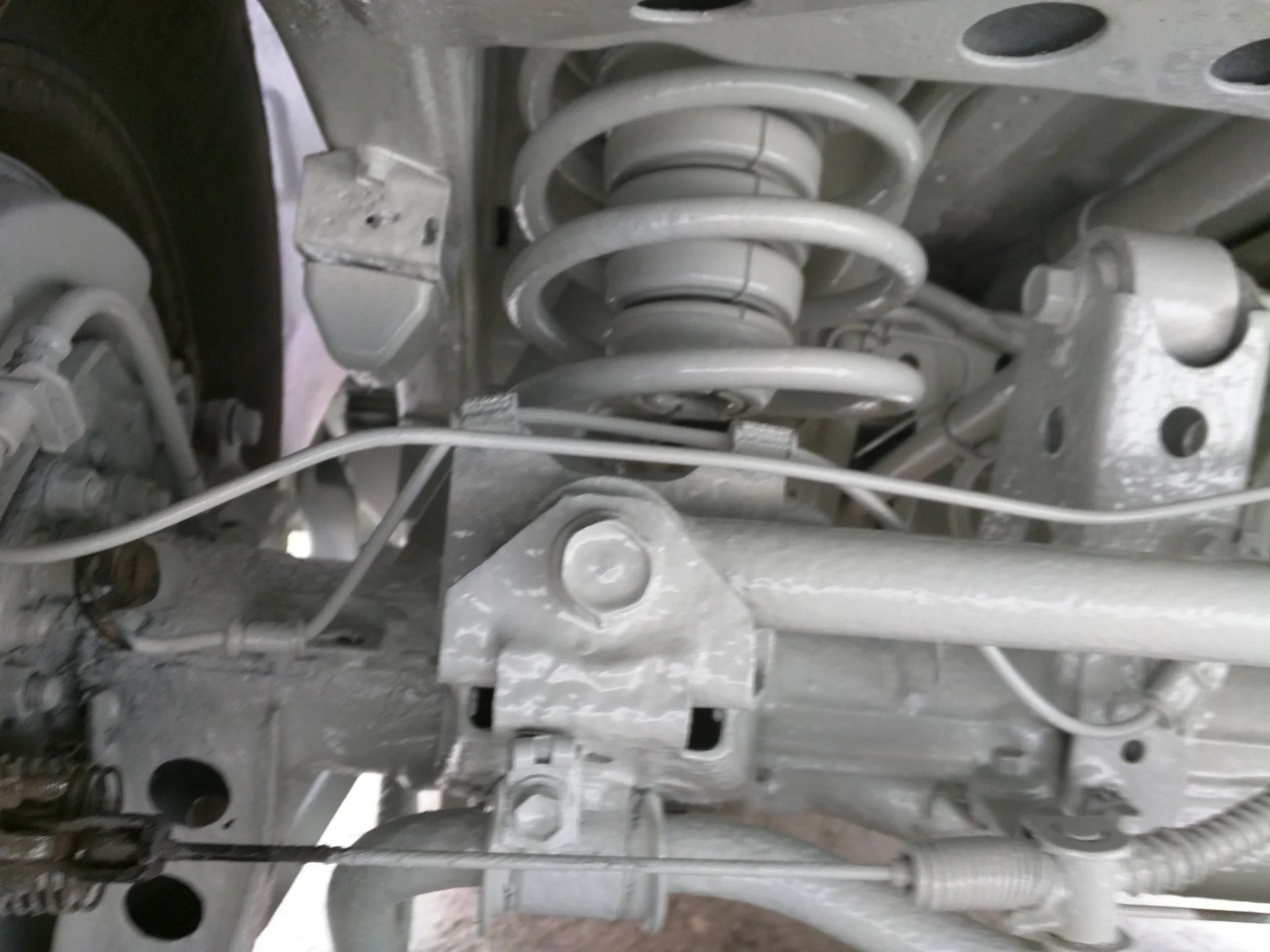

That's what I did. Still need to post pics but that is exactly what I did. Had a guy use Starburst sand, epoxy primer and poly top coat. Came out well; we'll see how it does in the winter but for now she's really good.
Awesome! I'm curious as to how well it holds up too. Always thought this was an option for crusty rusty rigs!
I had him paint it white so I could see any trouble spots materialize, as well as leaks and fluids and what not; its actually way easier to see under there now since light penetrates the nooks and crannies. It was 600 bucks; if it holds up, well worth it.
pictures!
Here ya go!

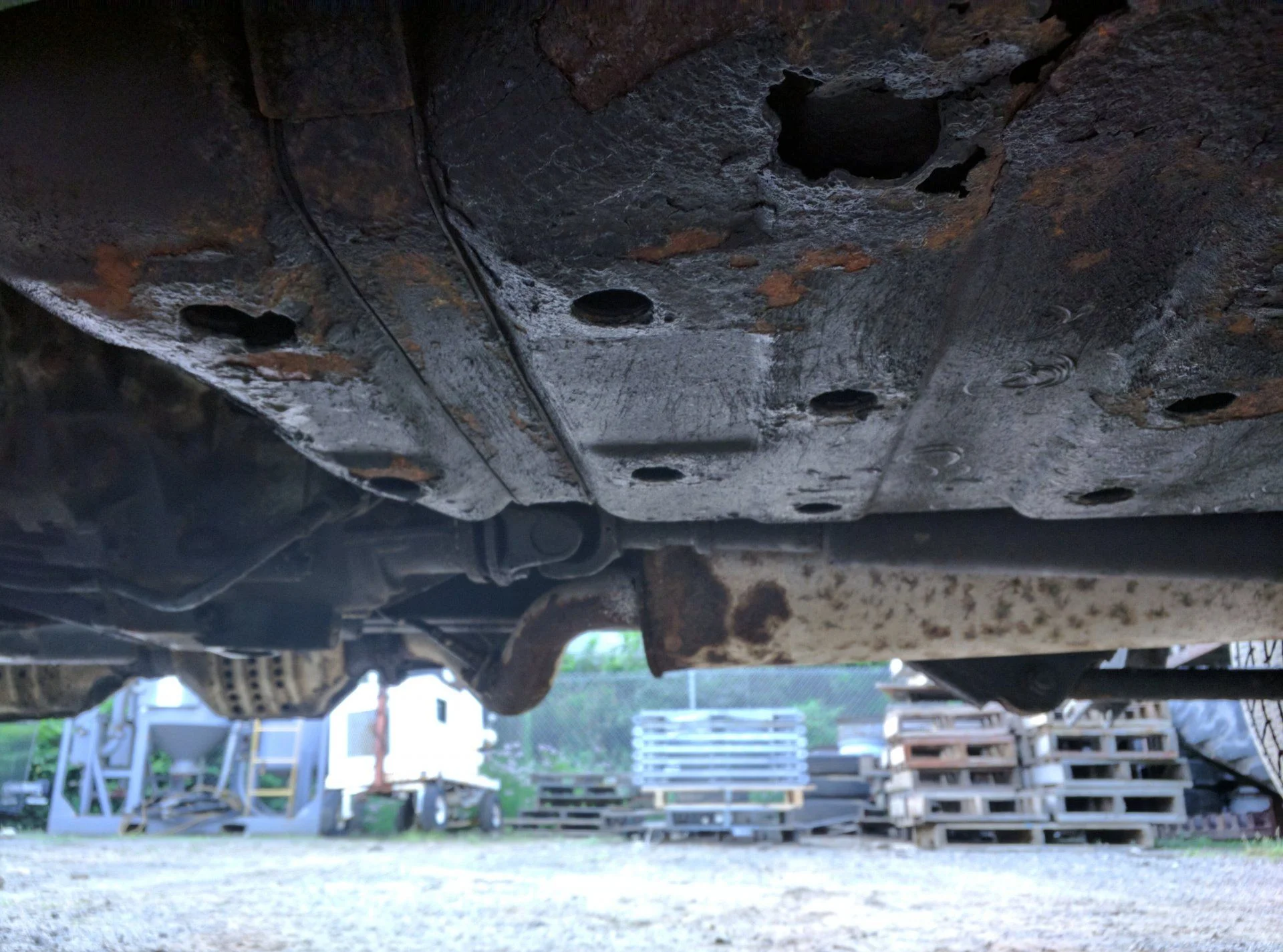

How it was before...
How it was after...

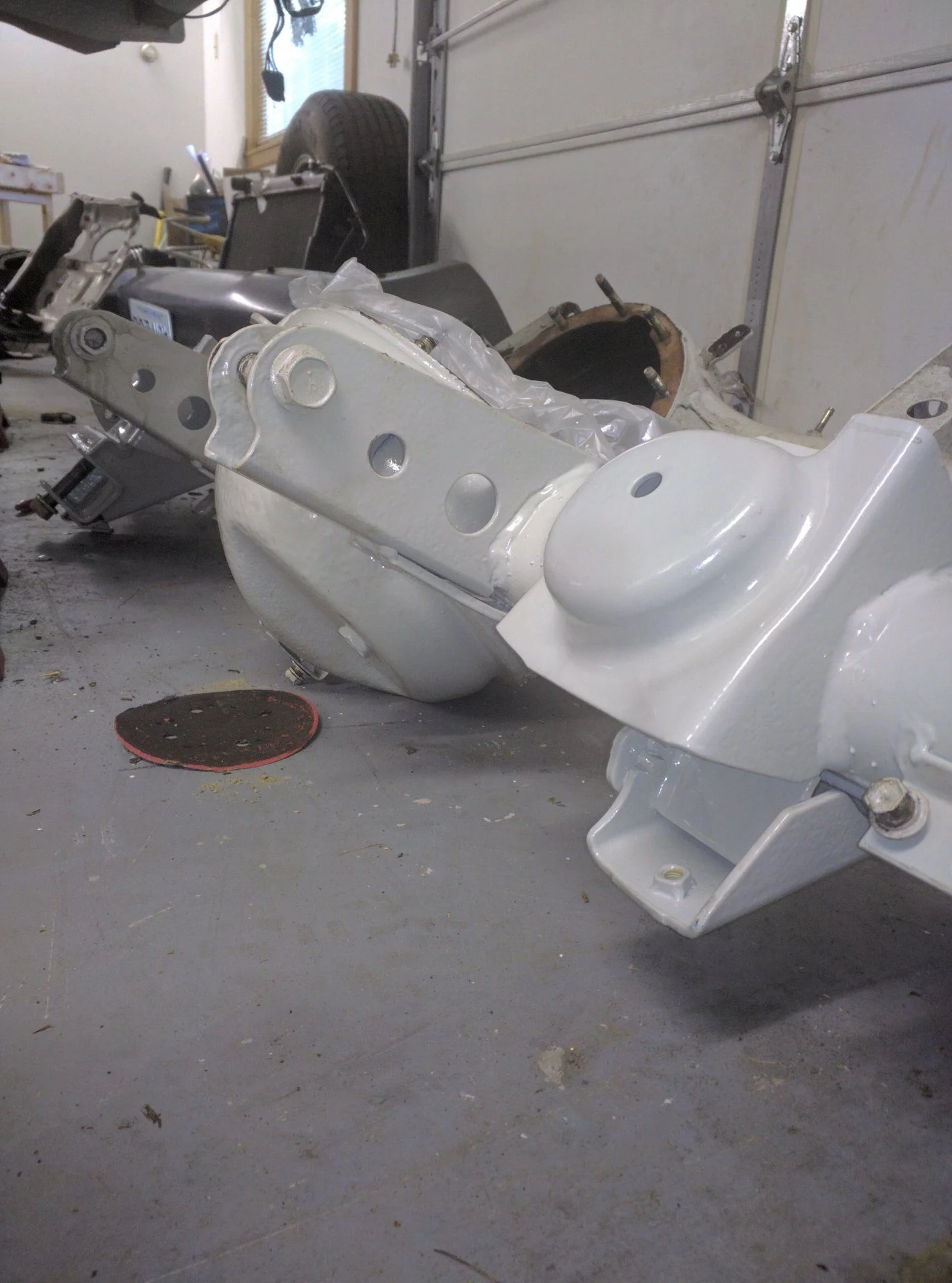

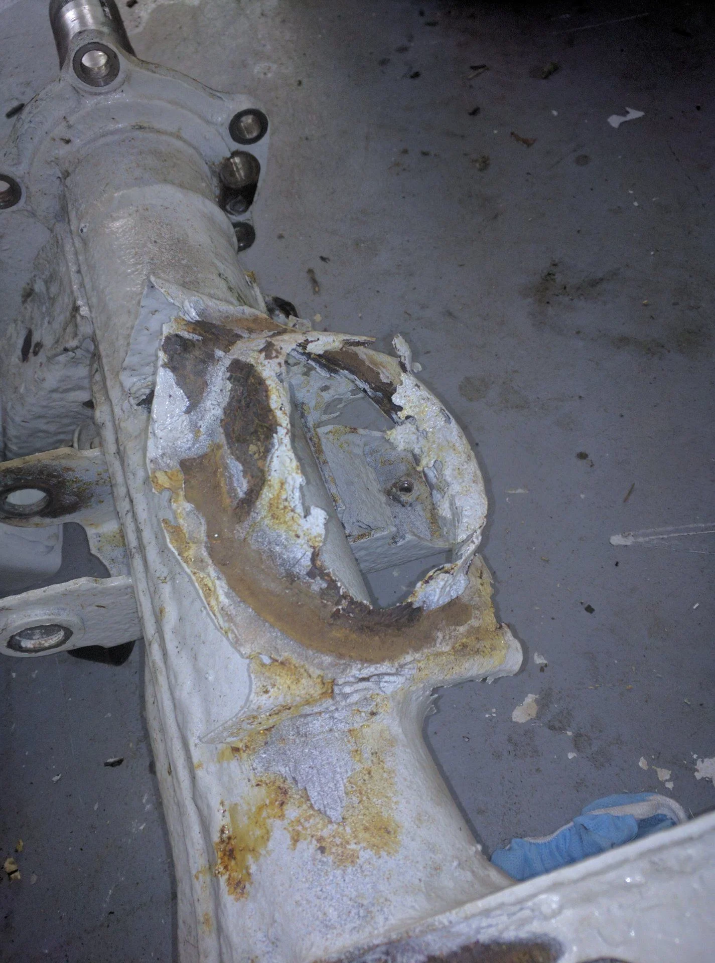

Still, the rear axle housing was just too far gone...
So I got a used one and blasted that too!
I'll be doing fluid film out the whaazoo to try and keep her good. This plan could fail miserably but another mud guy gave the tip to go to this same dude and his truck is holding up well after two year and no fluid film so I'm fairly confident. :bounce::bounce::cheers:
Edit: The post tagged old rear is actually the front axle; wasn't looking close enough when labeling
