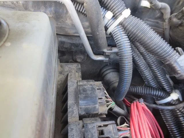

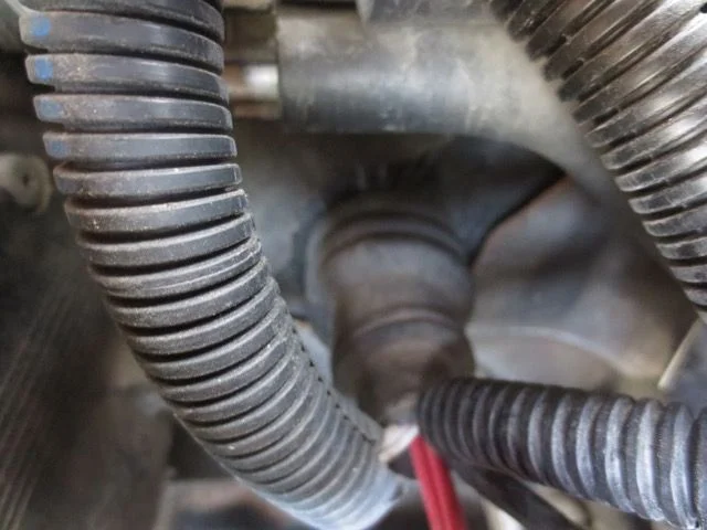

Ramathorn15 - I ran mine thru the DS firewall using a step bit, and rubber wire grommets purchased on Amazon. If you want more details, let me know and I'll snap some photos for you and look up the parts that I purchased.
I definitely would be interested. I actually already bought this:
https://www.amazon.com/Daystar-KU20040BK-Black-Universal-Firewall/dp/B004K2285E?tag=ihco-20
I'm hoping I can make it through the driver side. A photo of where you cut would be super helpful.
@Ramathorn15 I expect detailed, step by steps instructions for all of this in clear and concise manner written up and posted to your build thread. Bonus points for a parts list with associated links. :)
I used the same Daystar firewall boot that you purchased and attached a link to. Where I drilled thru, was an area where there was bare metal, cylindrical area, with none of that insulation type material covering it. Be careful however on the backside (inside the cab) there is a threaded post square in the middle. Stick your head up under the dash with a flashlight and you'l see it. When I drilled my hole, that post wasn't in the center and I had to pry it out with some plyers, was a bit of a PITA.
Crap, I just took 2 photos and keep getting an error message when I tried to upload them. WTF? I'll keep trying and see if I can them to upload.
Trying again to upload the 2 photos. I keep getting a message that says, "The following error occurred. There was a problem uploading your file" (well, no sh**). Anyhow, I can email them to you if you want. My email address is Waagman@sidedoorstudio.com
Photos courtesy of @Brian Waag
Thanks for the photos! These and your description should definitely help!
