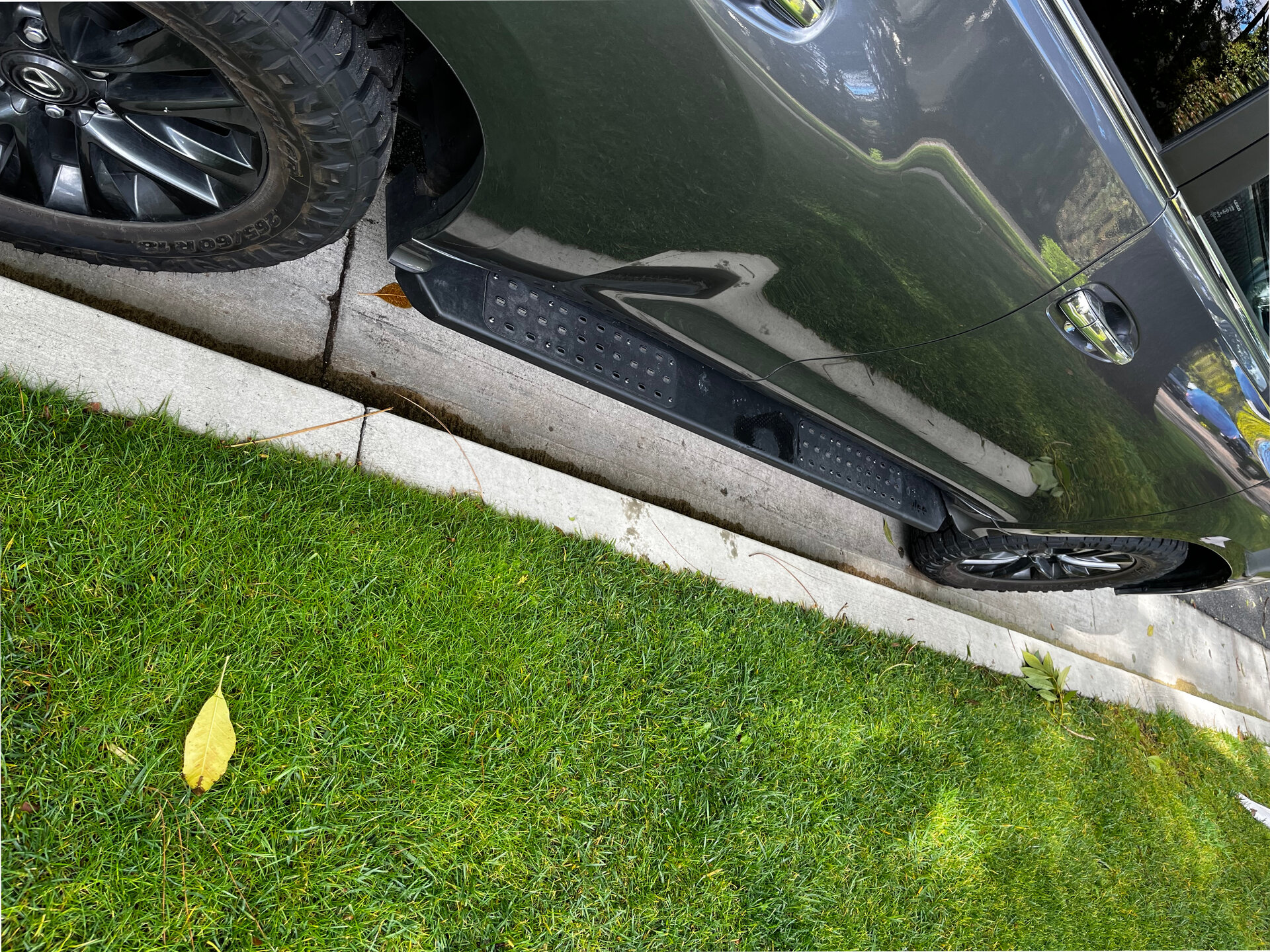

I'll throw out another option that I have on my 470 (required some mods to fit but should bolt up to a 460):
$864.03 shipped and only around ~45# per side. Fit and finish is pretty good. Mine have been great for making the GX look good and serve as a good step for my wife and kids, and me when putting a bike on top of the GX. I have yet to whack a rock with them but they are very sturdy.

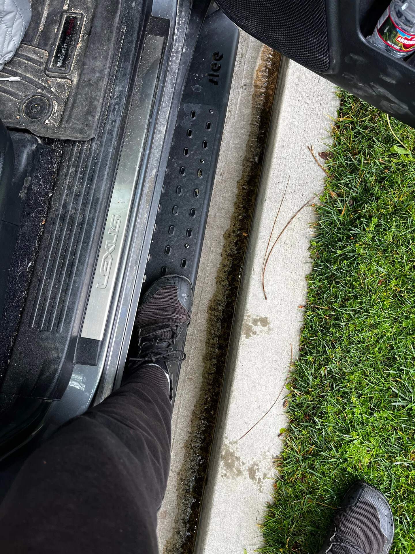

These are what I went with when I had to replace my MetalTech sliders from an accident.
Been very pleased so far, including the width of the step. I use it all the the time for opening and closing the RTT.
