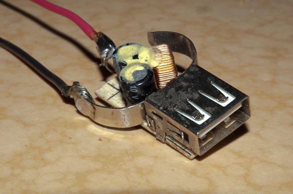

There's probably hot power at the dome light. The inside of a cheap usb cigarette lighter adapter looks like this once you bust it open:
Dome light will always have power, so not a good choice if you want the USB adapter and camera only running when the car is running. It's not a cruiser, so I can't help you with a specific circuit to get switched 12V from. Likely you can tap into the cig lighter outlet if it is only hot when ignition is on.
