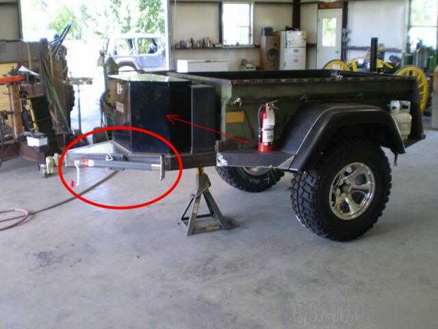

I finished up my trailer back just prior to Jamboree this year. I used almost the exact jack for the front of mine. I do have one question fer ya tho... Is that box on the front removable? Otherwise that crank handle on the jack might bein' a bit hard to work? Just wonderin':hillbilly:
Nice to have you hangin' 'round again sir. :cool:
How's the lovely girlfriend doin'? :grinpimp:
Nope ... and it won't work at all. :lol::lol:
First thang I noticed when I saw the trailer. :cheers:
Damn jack's really too short anyways with the 35's. Bought me a square drop-leg unit to replace it with. Gonna have to re-do the tongue anyhow.
Jonathan did an excellent job of followin' the lines of the toolbox but those angles make the tongue too short. Gonna have to have another angle break right in front of the toolbox and stretch it on out some. Then we'll insert the new jack into the horizontal plate in front of the toolbox.
I'll be home again this weekend and I'll back the jeeper up to 'er and cypher out how much longer she's gotta be. :hhmm:
I'm really excited 'bout this project. The quality of Jonathan's craftsmanship is simply superb. :beer:

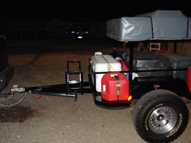

I think one thing that is different about your jack vs. mine is the location of the mount. I think mine is only about 5" below the top and has 15" of travel. Granted I am only runnin' 32s on my trailer, I typically just throw a block under the leg if I am in a situation that requires it for leveling of the trailer for set up.
Like this one..

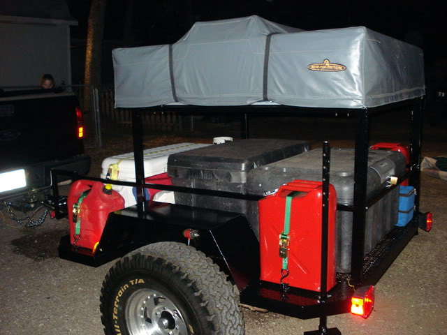

One other question I do have is one thing that came up when I did mine, do you plan on putting anything on the rear of the trailer for leveling/stabilizing the trailer while set up for camp? Originally I had thought of adding 2 additional jacks to the rear, but ended up just adding some pipe sleeves and pipe extensions for stabilizing legs. Are you going to add anything like that? Here is a photo of mine..
Just food for thought.:grinpimp:
