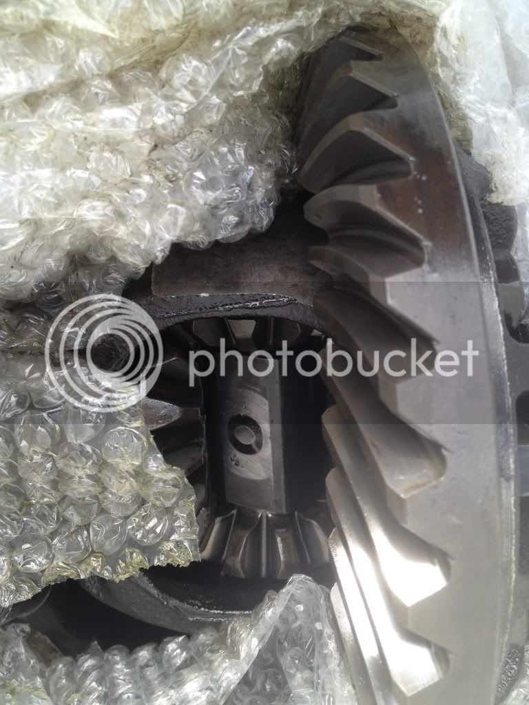

BUT, I have a question: do some unlocked rear diffs have an extra part in them (by year maybe) that newer ones don't? This one has a center "sleeve" that's flat on opposite sides and the center cross shaft pin runs through the center of it. My old one definitely didn't have that part. Anyone?
Almost looks like someone previously had a locker in this rear and took out the locker, leaving this part behind. See the marks on it? Thinking just pull the cross shaft pin and yank that part out.
That is odd... can the cross pin be removed? I haven't seen anything like that.
Pinhead is right, that diff was out of a semi float axle not a full float that is the reason for the block there. But, it won't matter because once you pull the cross pin out the block will come out too.

Ah, I swapped my SF for a FF and never cracked that puppy open. Explains why I didn't know what it was. True that it doesn't matter the chunk is the same.
So out of curiosity, if I'd left it in, and reinstalled in my FF as-is, would it have worked? Or would it have caused an issue if it did initially work?

Oh, and on the install without removal, probably would have been fine. Since the SF has c-clips it is probably for locating the shaft ends to minimize slop. Basically keeps the shaft from moving in further than needed to seat the c-clip and holds slight pressure on them once installed to keep them from sliding in and out while driving.
