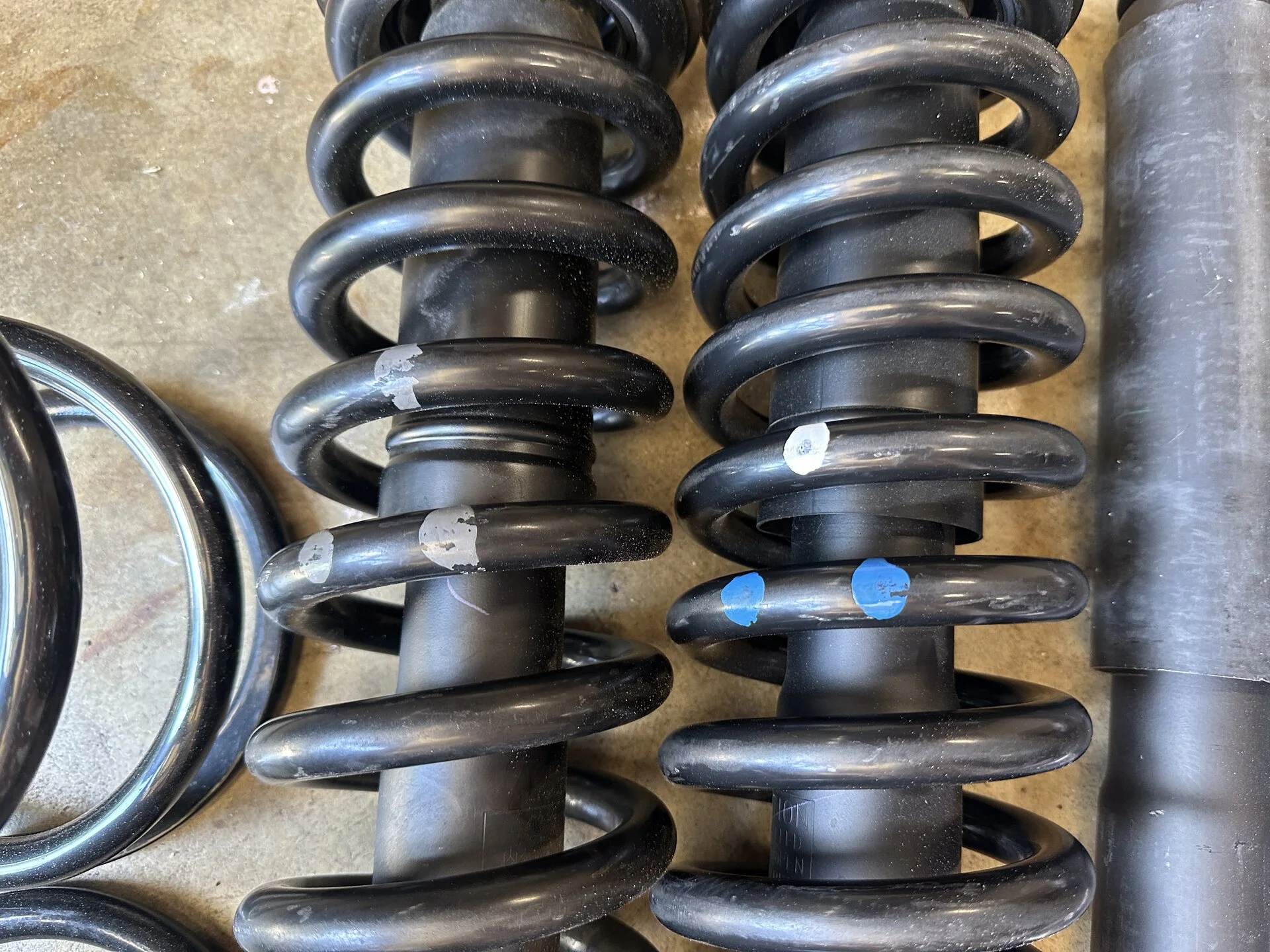

Hello all,
I'm putting some stock take-off suspension onto my 2013 but don't know which side the front springs go on. One spring has three gray dots, the other has one white two blues.
Alternately, one of these part numbers was carried over from 2010-2015, so if someone with stock suspension could check the paint code of their right front spring, that could work too.
The base model rears are more obvious with one spring being much longer than the other.. but if possible can you confirm? I'm attaching pictures of what I have, these are off a 20 or 21 base model.
In a little bit of a time crunch as the rig is going into the air and I only now realized I didn't do this research.
Thanks for any help!
I found this thread, but the paint colors don't match what I have.. plus the part numbers did change with one front spring swapping sides from 15-16. So I'd like to get more confirmation from a 16+ after the part number change. Thanks!

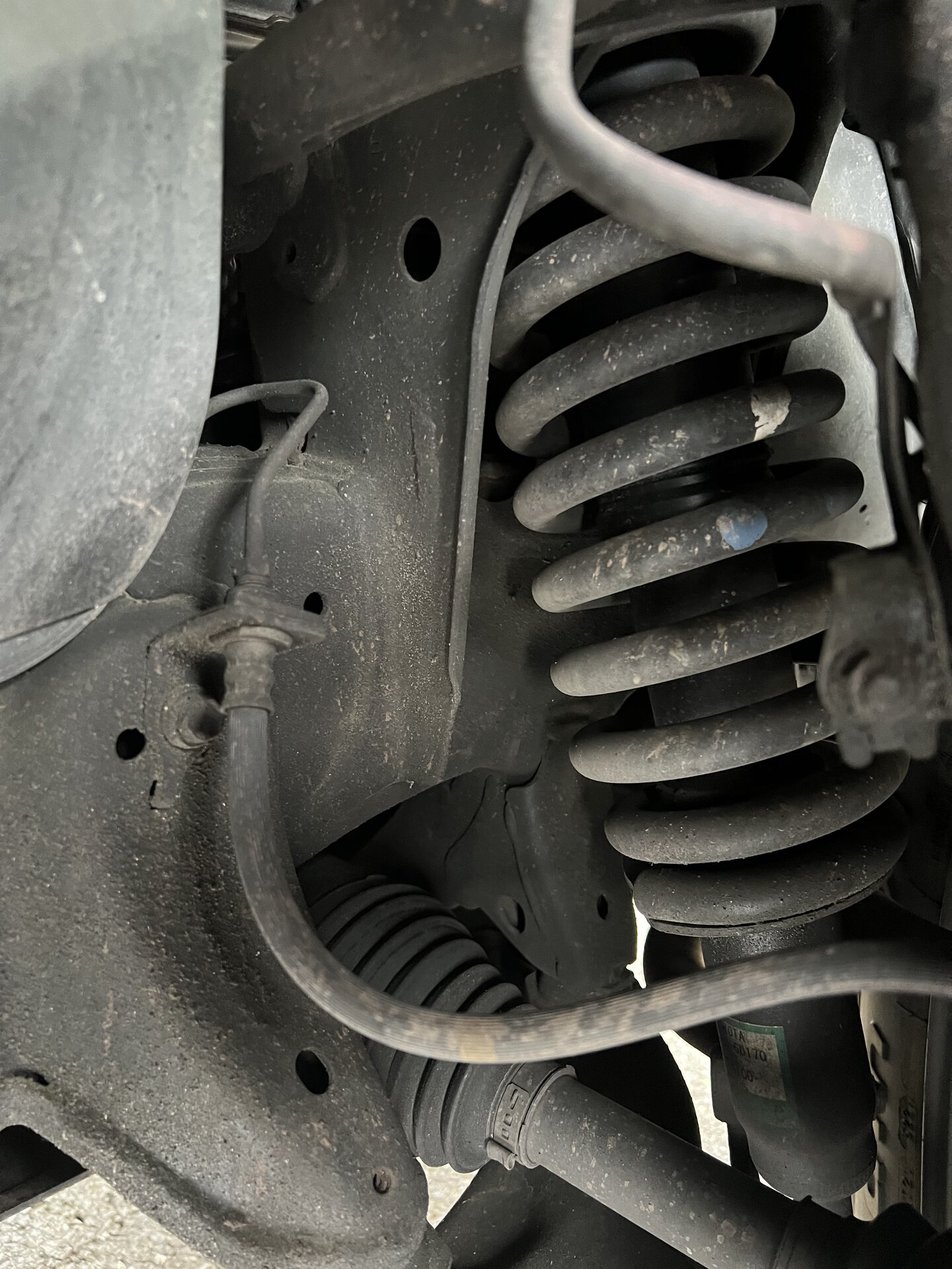

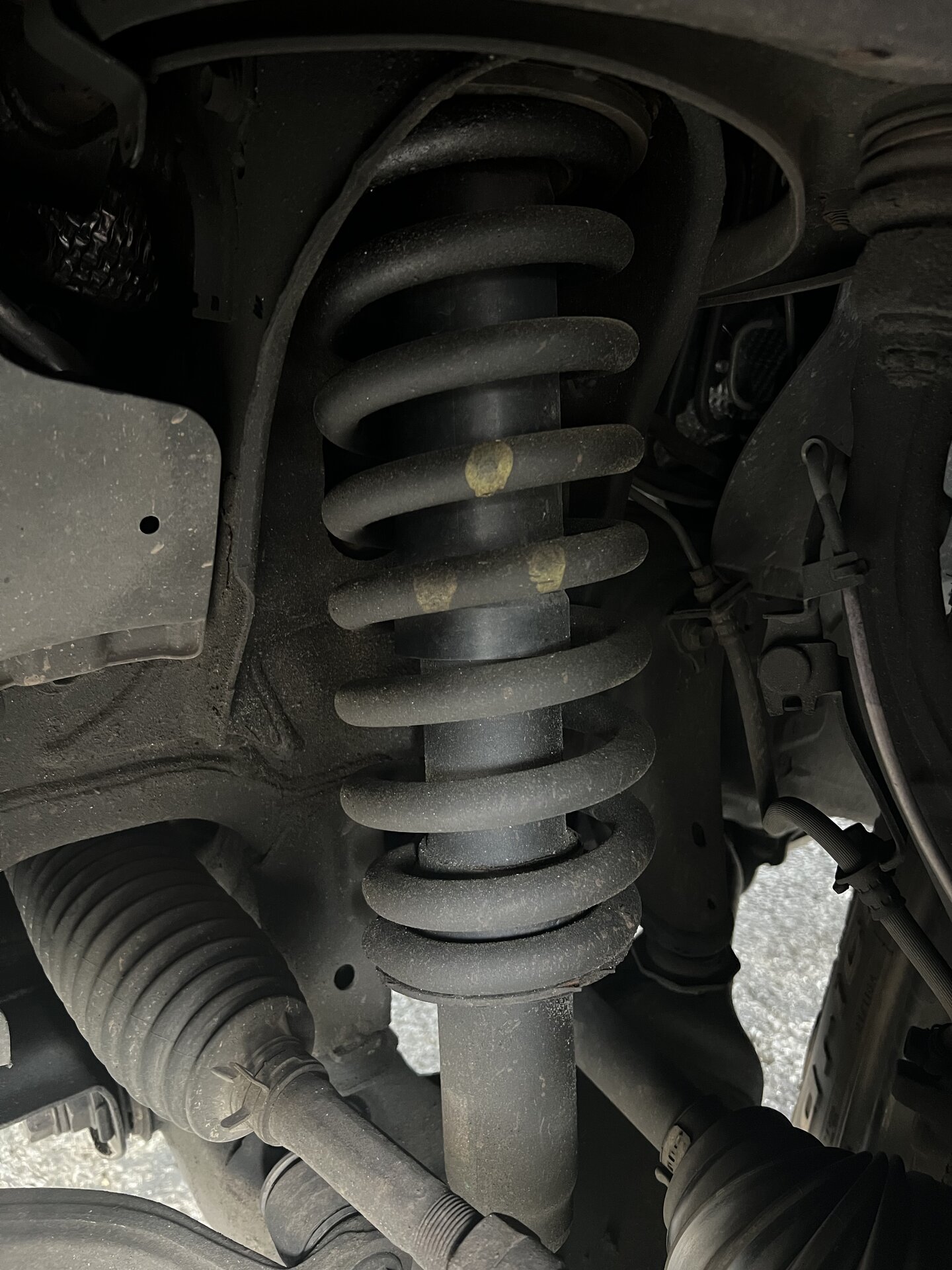

not exactly what you asked for (my 2014 stock lc). front drivers side (3 yellow dots); front passenger side (blue and white dots).
Thank you! That helps me figure things out.
On 2010-2015 the Right front (blue/white) was PN 48131-60D21
In 2016 that number moved to the front left.
Just to complete the information.. your yellow dot left side would be 48131-60C81
The 2016+ right side is 48131-60D40 with three gray dots

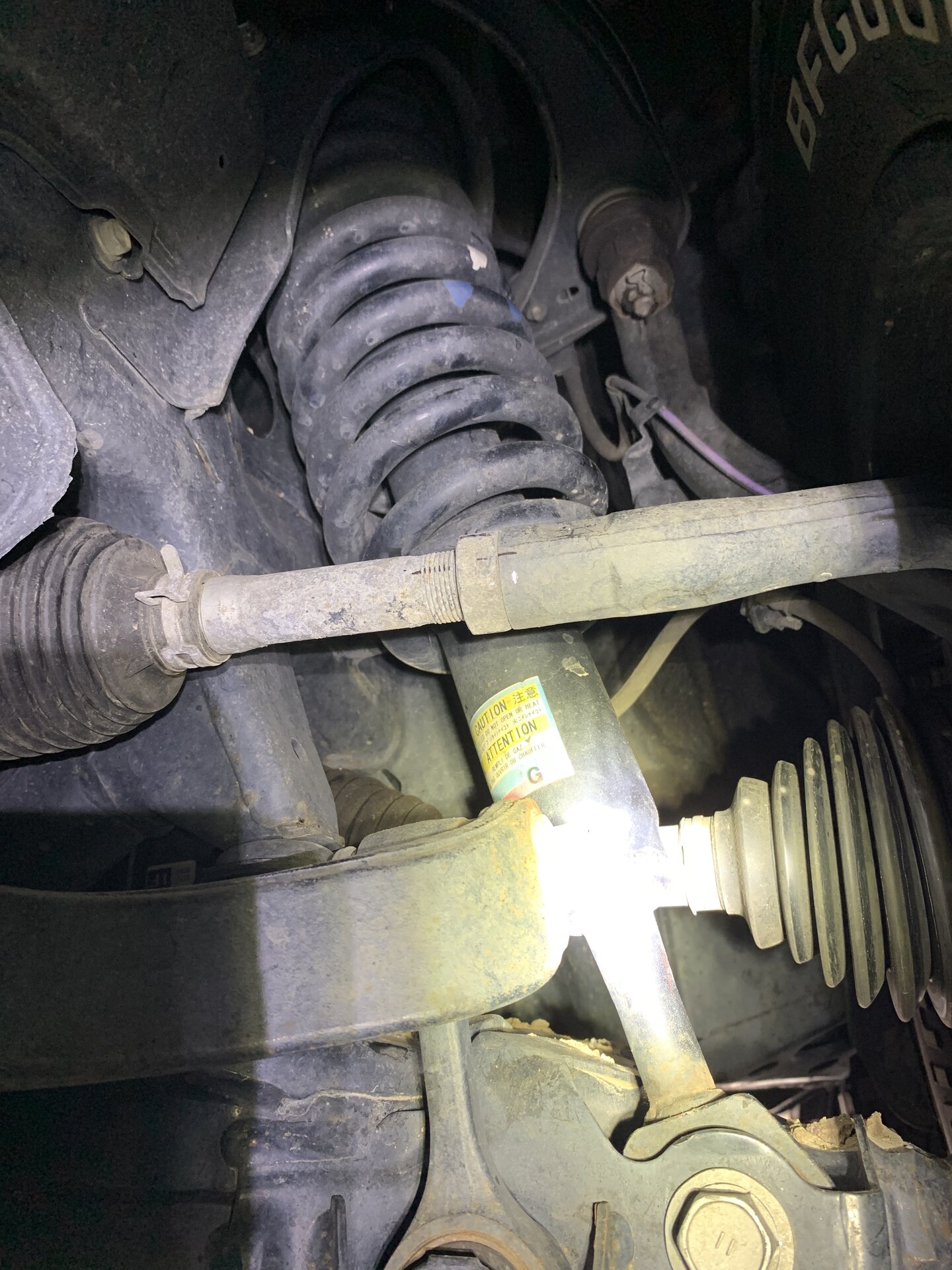

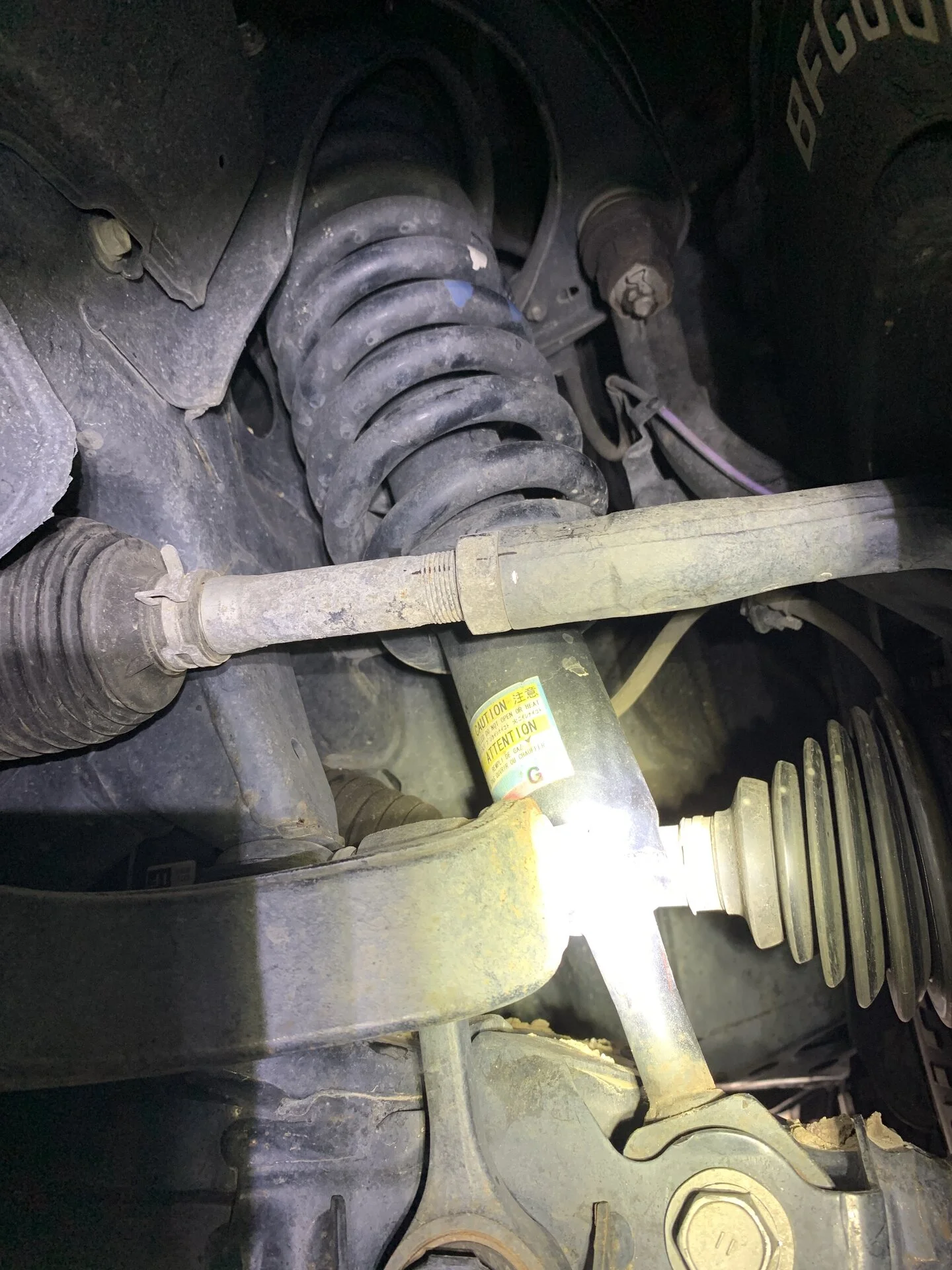

this is my 2018 driver side, 2 blue and 1 white. sounds like you’re on the right track
