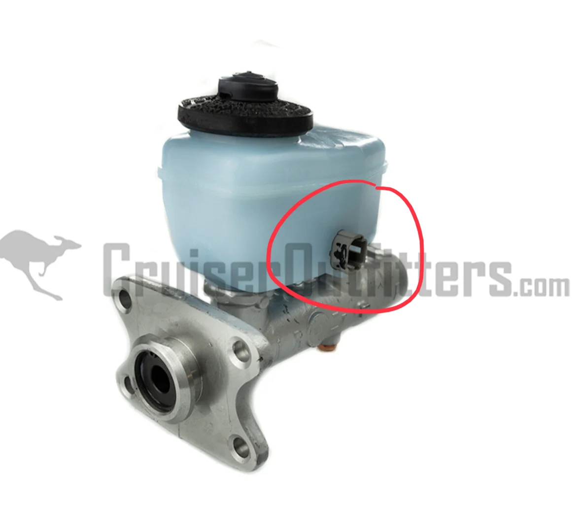

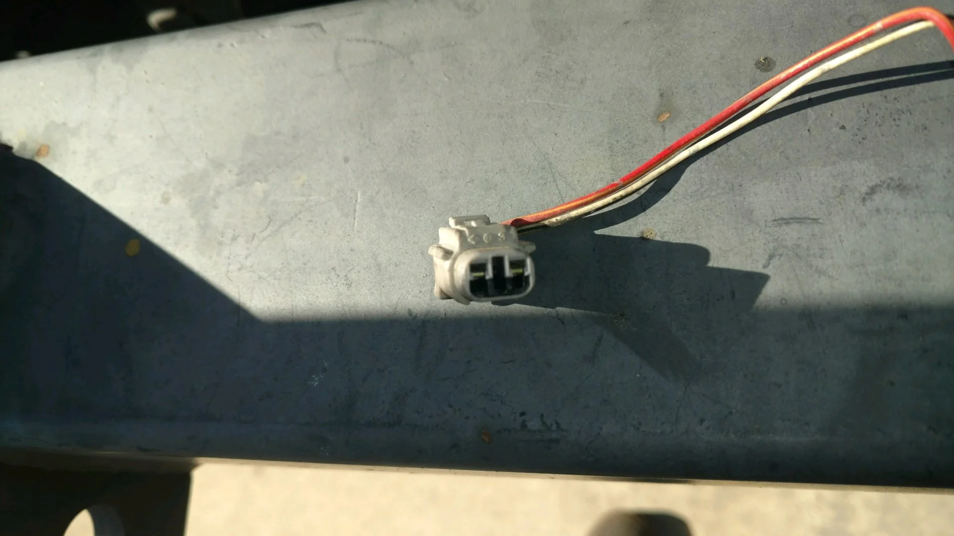

The 47201-60540/550/570, etc Brake Master Cylinders use a fluid level sensor connector on the side of the housing. I’m not in the shop today but I’ve been crawling through the connector manual and can’t find the housing. Anyone recall this connector housing part number?

Looks like 90980–11207 to me

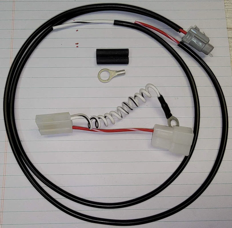

So this needed Master Cylinder harness side female connector in-put-plug topic has been well mapped out by everyone's favorite vintage toyota re-production wire harness sub-assy. maker & Oracle @Coolerman ....
i have posted the links to his electrical parts store main page and also the plug-kit-form-kit page you need as outlined above ....
he keeps good stock of these particular rascals and a great many other thingy's and stuff related to wires , terminals & housings ,,,,
he works best Via Email in his store contact page ......fyi
i hope my most recent skunk-worx parts-
arc made it into your office stacked front and center . .....?
hope this help you and others who see my info i posted
matt
Part# 80MS-SW
note ; all tech pics below from @coolermans online parts store ...fyi

Perfect @ToyotaMatt, I'll forward them to @Coolerman as he has a solution ready. Thanks!
