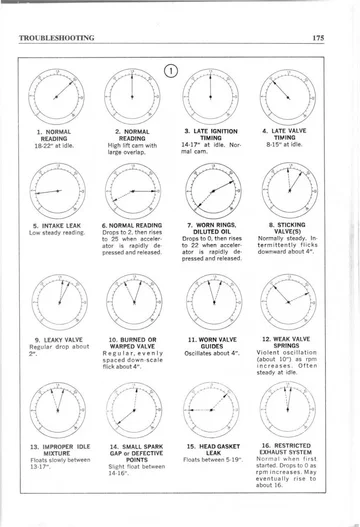

slow left: That is a great little chart.
vsz, I would think that your exhaust sucking exhaust back in is not good.
Older engines require more frequent valve lash adjustment, follow the link above and check your clearances.
Yeah it's a neat little chart; helps at least give you an idea what you're up against... I poached it from a post I ran across a while back.

Thanks for posting that diagram - yours is a more complete troubleshooting guide then the one I was referring looking at.
According to your guide, #11 seems to describe my vac readings the best. It violently oscillates about 4" centered around 16". It doesn't appear to be a "regular evenly spaced down tick" like #10. It simply oscillates back and forth about 4" at a very rapid speed. When cold, the oscillation is more like 8-10".
When I coast/decel downhill in gear the behavior changes to steady at around 22". As soon as i hit the gas I get the oscillation again. Oscillation happens at idle too.
