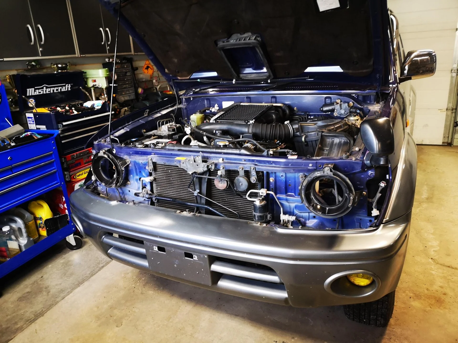

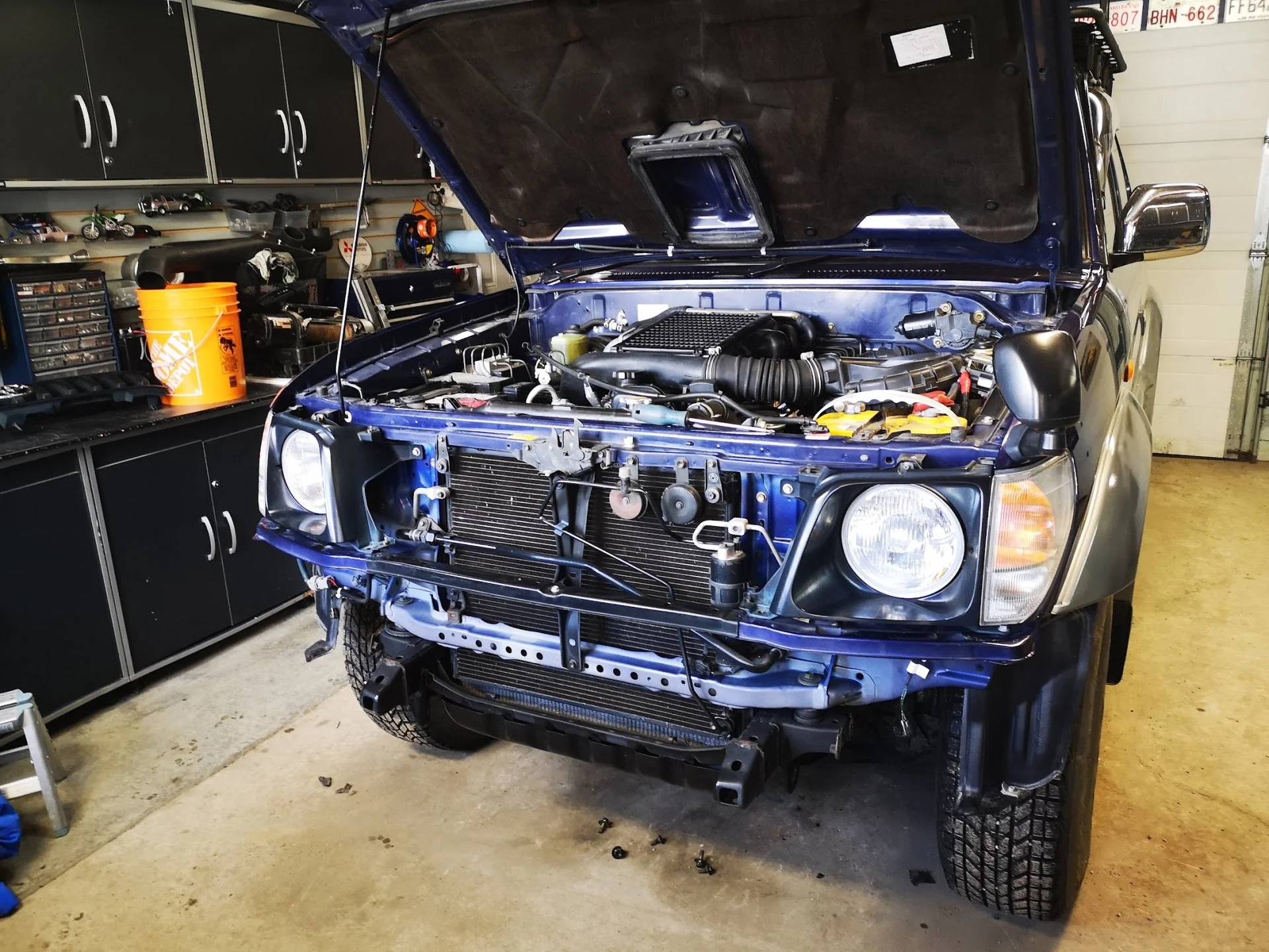

So obviously mine came from the factory with 7" rounds lights. This seemed to be a 2 door 90 series standard until around 2000 or so, when they all switched to flush lights, like the 4 door 95's had from their inception.

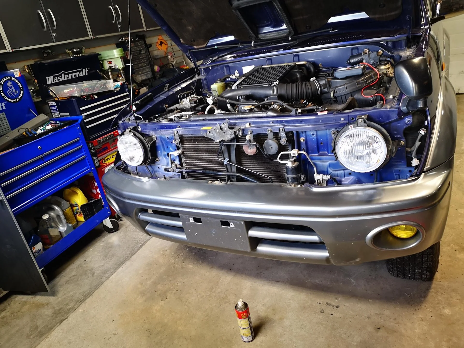

The lights themselves are standard 7 inchers, no special part numbers there. I switched my JDM RHD lights to LHD hella's, and the light was much better for our roads.

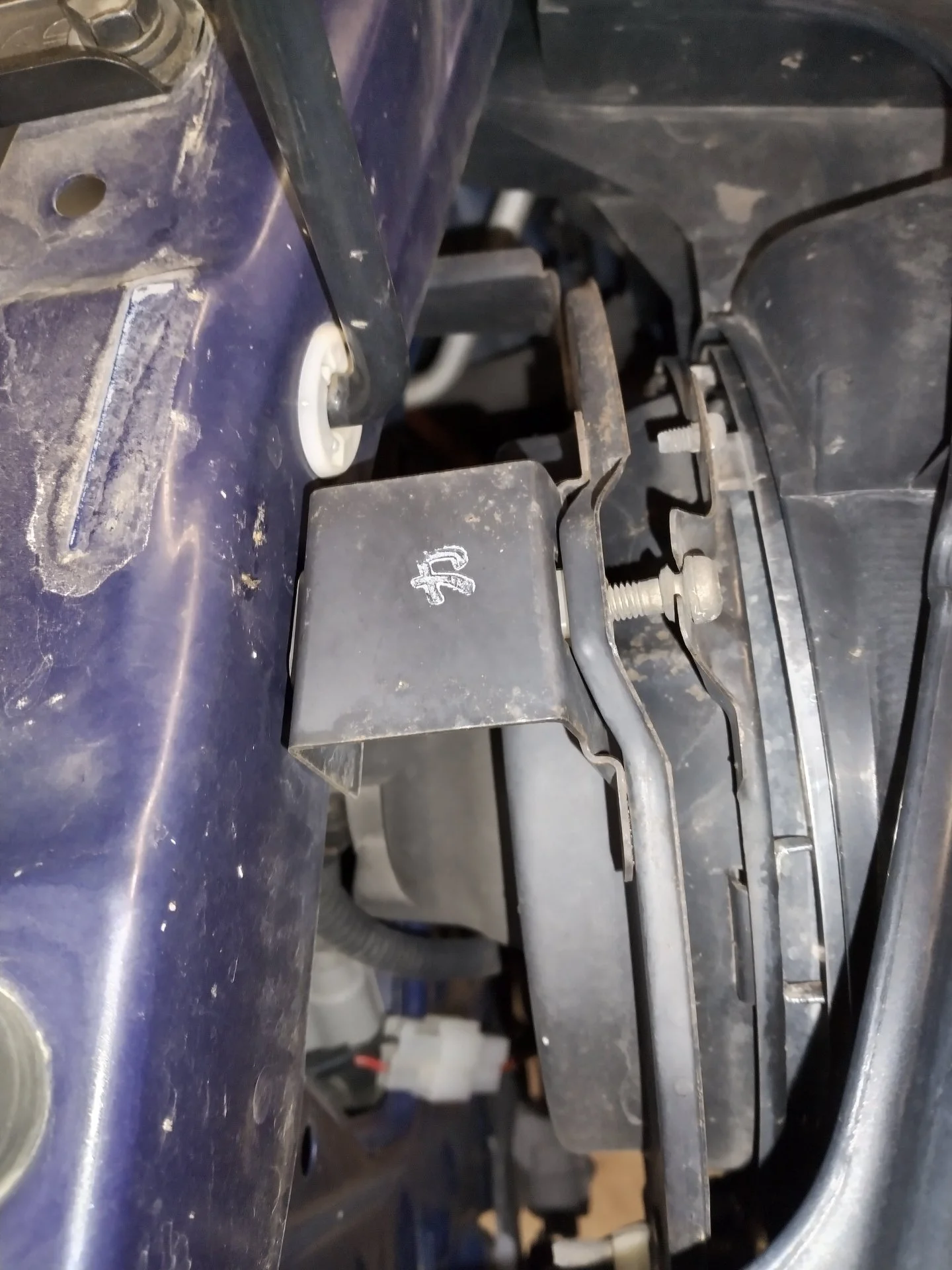

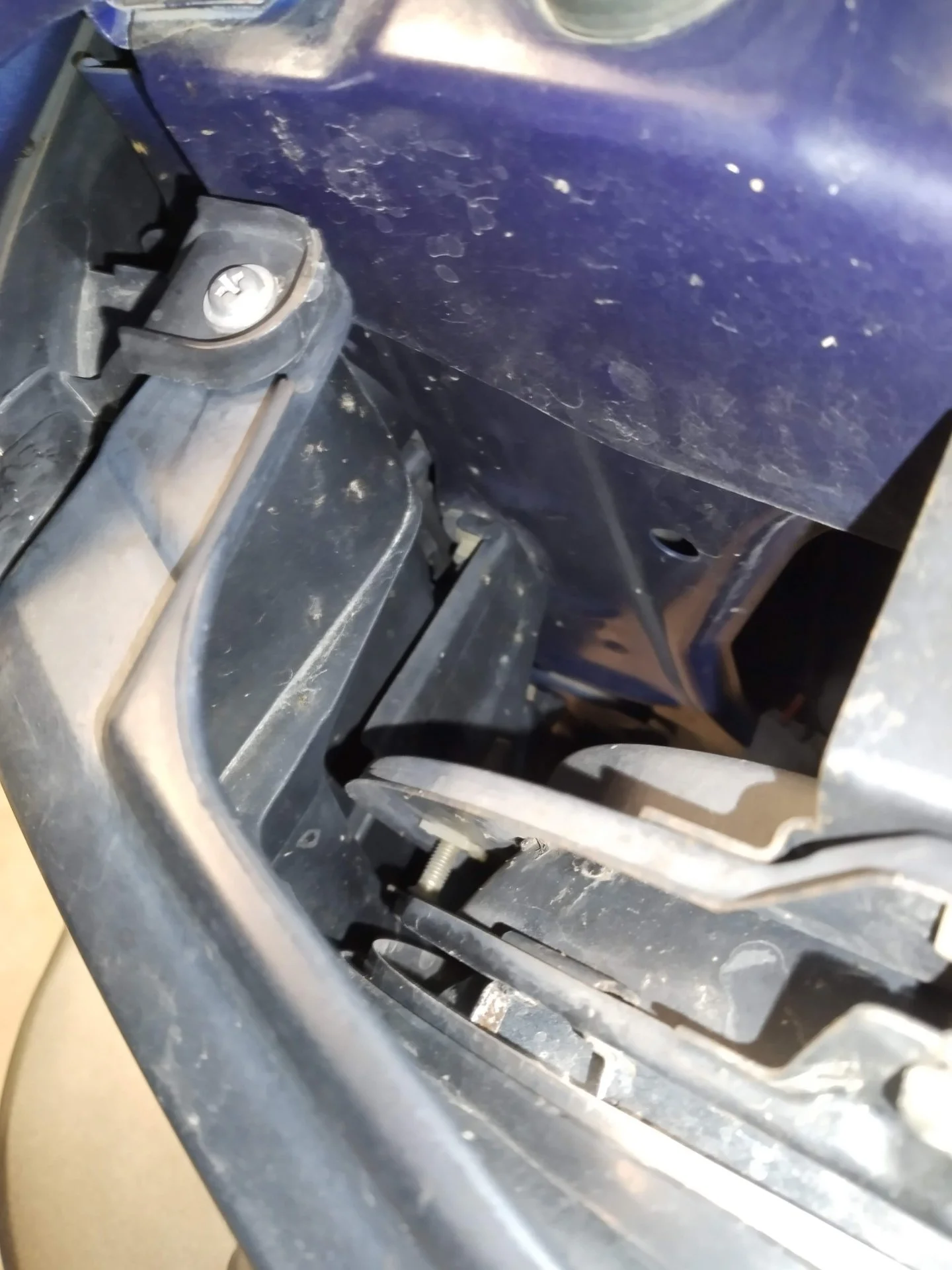

So, here are some closer pics of the lights, and the buckets, etc. Getting the factory parts to do the switch seems to be pricey or maybe not even possible anymore due to availability, but there are some factory repro's now, that might fit the bill? Others can speak to this better than I...
The ring that holds the light into the bucket seems to be standard stuff, avail from any jeep/vw, etc. But the bucket behind it is where the aiming happens, etc...
Here are a few "naked" pics from when I swapped out the RHD lights. Pretty sure these are safe for work though...
Others will have to chime in with retrofit parts, but hopefully this will help anyone who is interested in the factory differences, and they can go from there...
