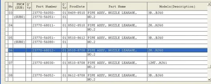

It would be easy to tell if vacuum in the tank starves your cruiser. After a long drive you can pull the fuel line feed to the feed pump and you'll hear a 'whoosh' if it is starved. This is what happened to me this morning when I couldn't draw fuel from the tank.
Just looked up the Toyota EPC and it seems the 2H in the HJ60 didn't run the injector bleed line back to the fuel tank till September 1987.
This is what the EPC shows for an HJ60 pre Sept 1987:
So as far as I can see a 1987 could be have the fuel return line run either way depending on build month.

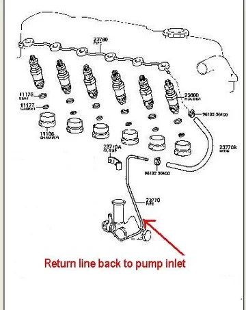

Thanks Kim. Your post here made me think again about what I just said in my last post. The epc page I looked at then was this one:
It shows the August 87 cutoff date. So I just assumed from that date onwards the line went back to the tank (and it is silly to assume anything when reading the EPC).
So I looked up Sept 87 onwards just now and found this:
The bleed line still goes back to the fuel pump inlet through to Jan 1990 on the HJ60!
