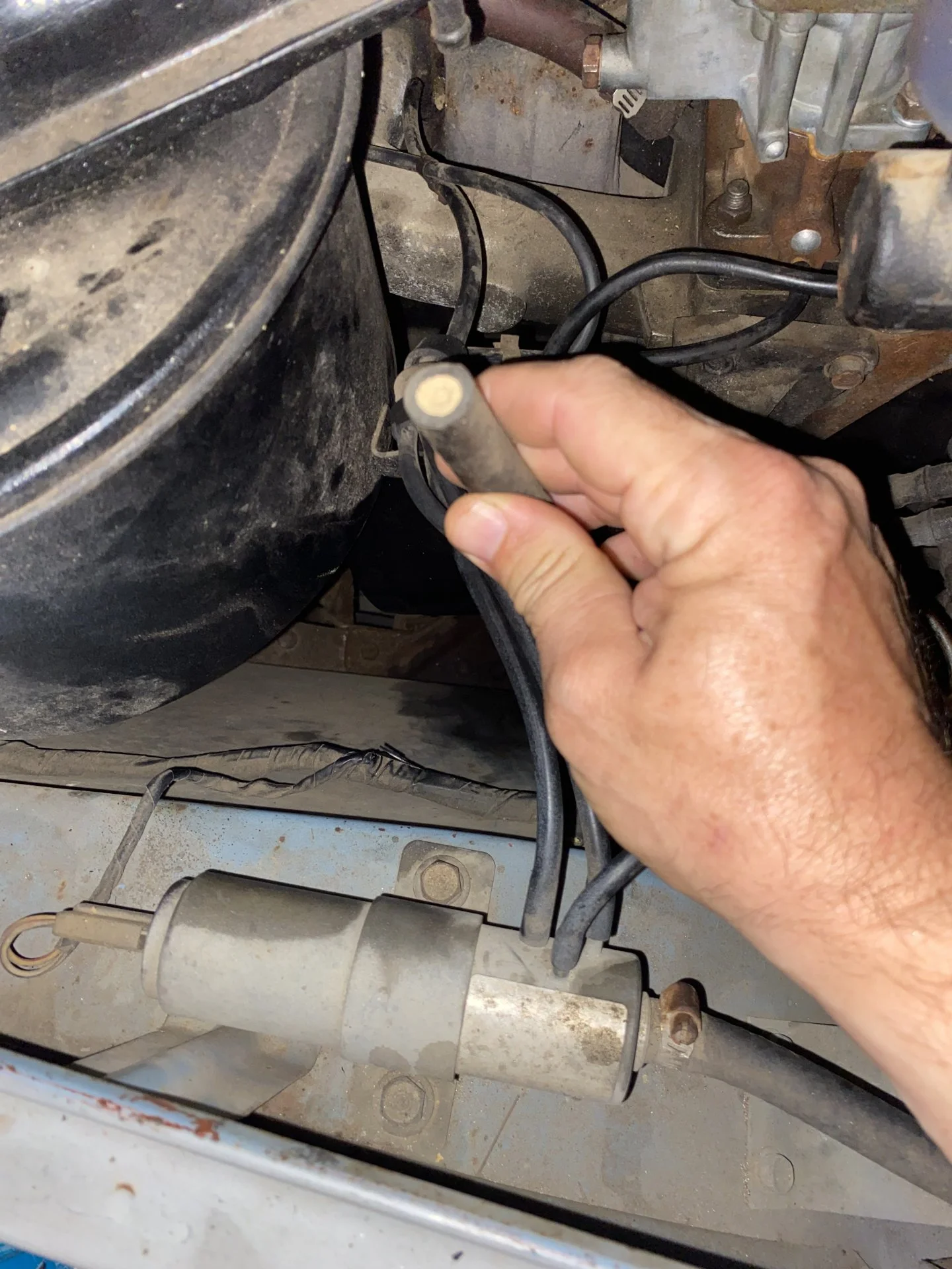

Looks like a dirt dauber had other plans for the vac supply line. I’ll let y’all know tomorrow…
