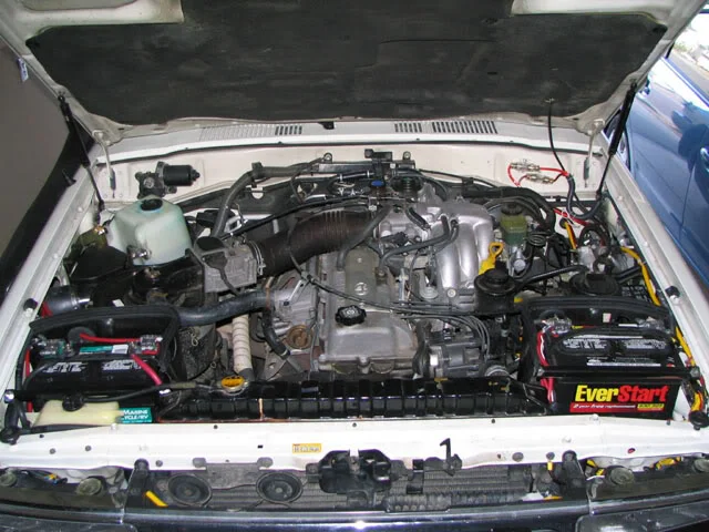

My dual battery set-up. This has been covered a million times but my setup is very basic using only a 120 amp isolator...I used this set-up on every dual system I have run and never had trouble...

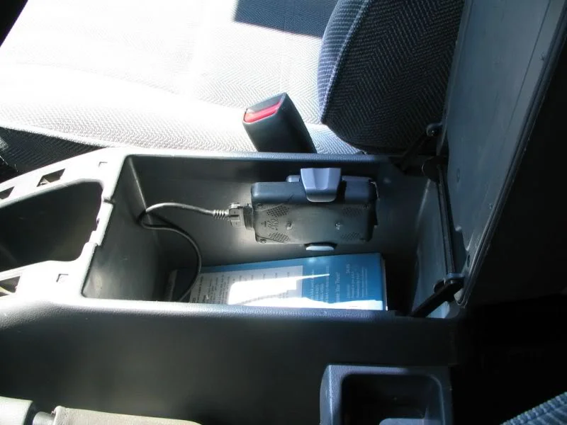

Ipod mounting bracket in center console...

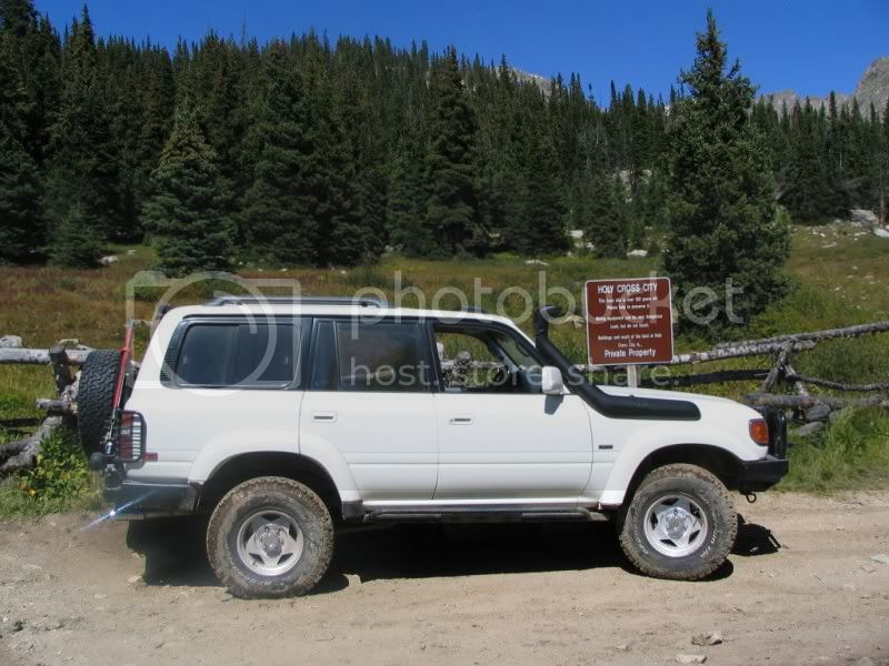

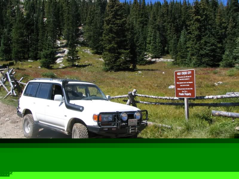

Fresh from this weekend:
posing....
some action shots...

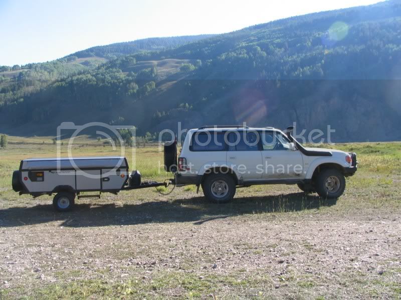

and my new toy to keep the :princess: happy...

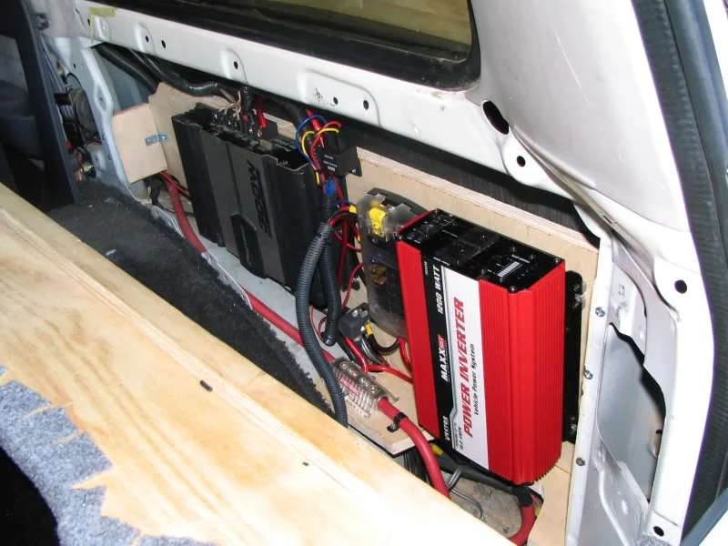

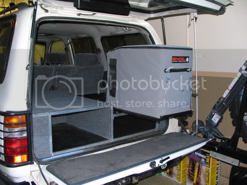

Link to my rear storage/subwoofer unit with amp and inverter install..
Storage unit (yeah another) with Subwoofers - https://forum.ih8mud.com/80-series-tech/187777-storage-unit-yeah-another-subwoofers.html
With mods to mount Engel fridge and slider.
Power inverter and amp install

Very nice, I really like the little camper.
Thx I'm really please with it. Sleeps 6, has a stove, a sink and a furnace (got cold enough this weekend for a hard frost..we were toasty warm) It only weighs about 1300LBs and tows up the passes at 50-55.:D As soon as it starts snowing I'll be doing a small lift and tire/wheel upgrade so I can get it just a bit farther back into the forest.
taccruiser97 said:
On the next to last picture where you are coming through the rocks, was that taken at French Creek? It looks like it but seems kind of dry compared to the last time I was up there.
Yes it is coming down at French Creek this weekend...tends to get low this time of the year.

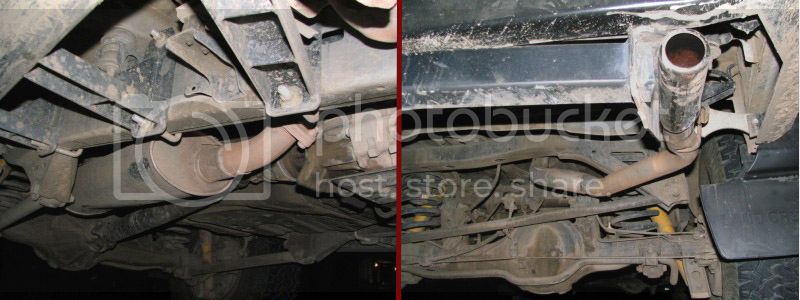

could you post pics of the cat-back exaust?

I will try to take some pics of the exhaust tonight (although it got a little beat up this weekend :crybaby: )
here you go...

Nice ... tell me more about that camper. How does it pull up over 70 at the tunnel?
It is a Fleetwood Cobalt, perfect for my family of three.
I was very hesitant to get a trailer because of the issues getting up to Eisenhower but this little trailer is great. I was able to do 48-50 indicated mph (stock gears, no speedo correction for the 33s so 52-55 actual mph +-) in the steepest areas and 55-60 everywhere else. It only weighs around 1300lbs loaded, hardly even feel it back there. I would recommend it highly.:D

Yeah it feels better going up the mountain passes and even better I no longer hear the whoosing whistle of the stock system under heavy loads :D.
This is a 24" magnaflow, and the sound levels are very tolerable, it has a deeper richer exhaust note without being loud. A smaller version would give better clearance but would be louder than what I wanted.
Cool - I've been considering one also, but with the same concerns. 50 to 55 is about all I do up there anyway. Guess I'll start looking a little harder. Where'd you pick it up?
