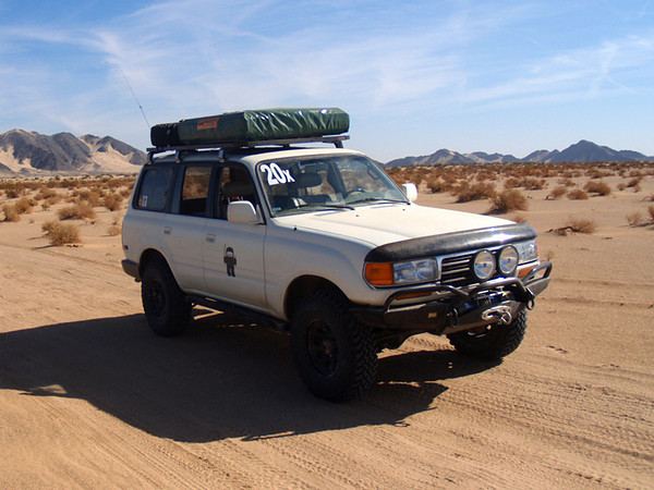

nice rig, do u have pics of the front end with the shortbus with
the hellas on, looking to get this bumper but wondering how and where to mount the lights.
and what rims r those, they stock size steel, or differnet offsets etc
it comes with tabs on the center hoop...
edit: forgot the rim info, the rims are Pro Comp 7"x 16" with 4" offset. i needed to go narrower
to run the 255s. the track width from inside rim to inside rim remains the same but the overall
track width narrows about an inch and a half which is part of the reason for going flareless.
What did you do about the holes left behind by the flares? Almost looks like white tape in the last photo (Baja 10 days pic)
white plastic plugs. i drilled out the square and small holes so i used just one size....
...one of the perks of a white truck.
I'm curious how you like those 255's as well. What's your MPG with all the mods? Great looking ride and well built for what you do with it.
