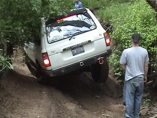

Nice truck, I like the classic white color.
Is you spare tire in the back?

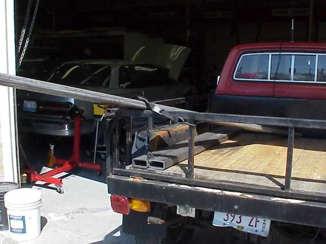

I would also like to see the mounting area of your sliders. Maybe a pic or two with them off the truck (when you were building them)?
I put the spare in back during trips or while wheeling. Around town I just don't carry one.
I don't think I have any pics while building.
Except this one...

Great rig Gumby!
I especially like the sliders and how well they work at kicking the truck out of the way of danger! Using it to purposely pivot the truck indicates both an amazingly strong design as well as an amazingly dedicated driver!
The rear bumper is beautiful even with flaking filler! I love that you told us the specs on the steel stock; that filled my little mind with all sorts of thoughts! The mounting method is extremely impressive. I'm having a hard time visualizing the hitch mounting method though, just wondering whether you would want to snap some shots specifically of that from the reverse side?
