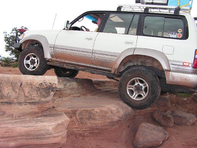

“El Diablo”
1997 LX450
From Cruiser Outfitters:
OME 860 Rear, 850J Front coil springs. Castor Correction and Steering Dampener.
ARB Bull Bar
ARB Rear Locker
ARB Fridge/Freezer
From Slee Offroad:
Washer Bottle Relocate Kit
Rear Swaybar drop down bracket
Stainless Steel Extended Brake Lines
From 4 Wheel Parts:
Piaa Driving Lights
High Lift Jack
Optima Yellow Top Second Battery
Bull Dog Gutter Mount Clamps
From Hellroaring:
Battery Isolator
Currently running 33” Cooper Discoverer STT's
Warn 8000lb winch from Ebay. Thanks again Romer for picking it up 2 years ago.
Custom “George's” Designed Sliders
John Curnett Aluminum Blocks for front swaybar
Custom “J Moose” Aluminum Roof Rack

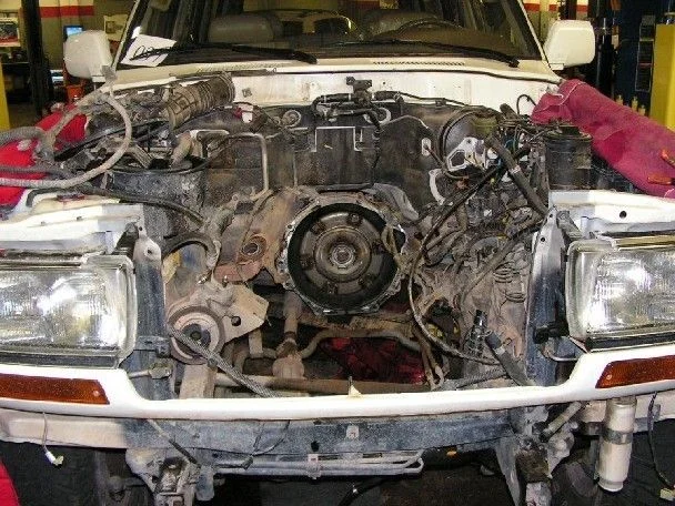

I took it down to a machine shop and they machined it. Our club gets a pretty good discount with a local toyota dealership on parts and I had them hook me up with everything I needed as far as parts go. Scott put it all back together for me and it runs great now. And most importantly it's quiet. With the quiet, I also have a lot of piece of mind. When he had the engine apart I had him replace everything that is easier to replace while it was apart. New hoses, belts, pumps, etc..
Looking back. One of the options floated for me was going with a new “short block”. Not wanting to appear stupid, I never bothered to clarify what a “short block” was. I assumed it was some how inferior to a “long block” and figured a long block was what I had. I later learned that a short block refers to the bottom end of the engine. You can buy a new short block from the factory with our discount for around $2600. That would be toyota factory stuff. I think I may have saved a little by going my route with the rebuild, but maybe not too much. If I had it to do over again, I think I would go with the new short block. I know Scott has told me he wouldn't agree to do it for the price he charged again as taking out the engine and putting it back in was quite labor intensive. In the end, with parts, labor and machine work, it all cost me around $5,000 for the new engine. It would have been cheaper if I could have done some of the work myself I'm sure. I didn't do any of the work. And there in is maybe some of the piece of mind. If I had done some of the work I'd worry every time I turned the key. So, I sold “Live Rust” on ebay for $6,800. It paid for the overhaul and had some money left to pay some other bills. I miss the FJ40 but have thoroughly enjoyed the Lexus. It's ideally suited for long multi day expedition trips, like my Transalp, but I can take my family with in the lexus!

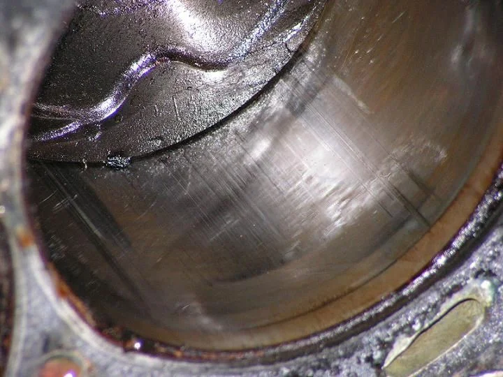

here are a few shots of the engine parts for those interested.

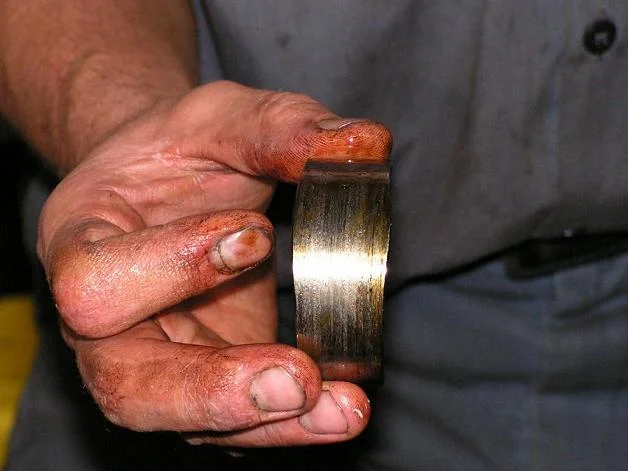

last of the engine stuff. It's depressing!

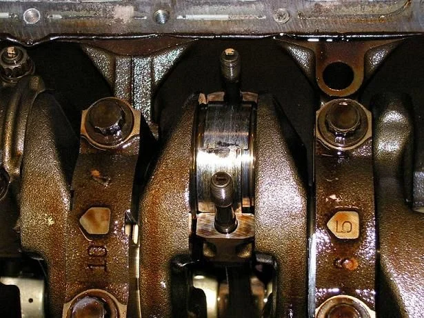

Nice ;) Pic post# 6 lots of rod bearings metal inside the oil pan. Or maybe not too much, it just mixed with oil pan silicone gasket. Wonder how many miles when you dropped and rebuild the motor.
that's mostly metal. Some were huge chunks. hard to believe that stuff was circulating through the system.
Engine had about 170,000 at the time of the rebuild.

Did the mechanic do a post-mortem on the bearing failure? Poor oil change history by the PO? Prior overheat?
-B-
Great write-up and a sweet rig.
So what, actually, failed on the engine. Did the autopsy say "crank bearing", or was it something else?
-B-
well
The original owner evidently took the lexus in to the lexus dealership faithfully so they have nice records. At 90,000 miles there was a head gasket failure and overheating. I need to call Lexus and check again but I believe they said there was some top end engine work at that time as a result of the overheating. Warped head? Anyway, it was fixed at that point and the original owner kept it for another 30,000 miles and sold it to the next owner. I'm the third owner. The second owner didn't take it back to Lexus so I have no records past 120,000 miles. I have always wondered if the noise was present since the 90,000 head gasket failure and they didn't do a good/ complete job on the repair at that point.
When Scott took off the head to rebuild it, the replacement headgasket was looking great!
I heard Scott use the term, "spun bearing" to describe the engine problem.
