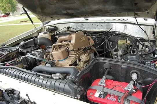

So, I went to work making it mine. Did a front end re-built, bearings, seals, new 100 series pads, and rotors all the way around cuz they were warped from sitting at Proffitt's so long. Put a new, bigger 1HC turbo on, cuz the bearings crapped out on the one that was on it. Tweaked the timing, re-adjusted the valves and whe runs great, loud, but great.

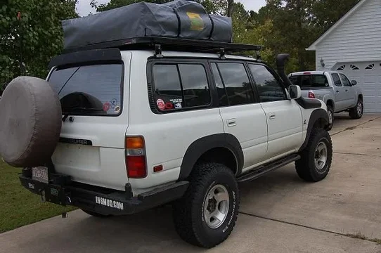

Since I have the Tacoma as the DD and the 40 is in the garage torn apart, I decided to use the 80 and my camping truck. So, I started off with getting a rack and RTT from Camping lab while Fernando had his pre-order deal going with free shipping on the rack and RTT. Sits nice, easy to open and isn't too bad on the CG, but I'll see next time I take it to Uwharrie:grinpimp:

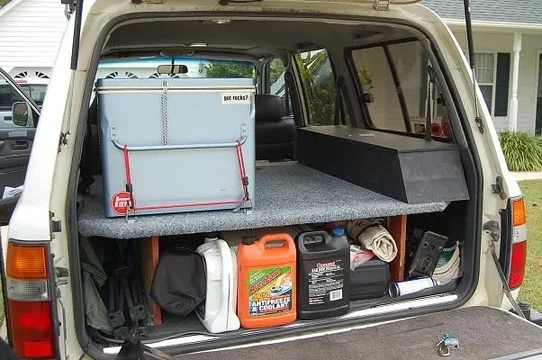

The rear shelf system that Brandon put in is real nice fot stashing all my crap. So, I could fit 2 tool boxes, the CO2 tank, misc fluids, HiLift, lawn chairs, and other misc goodies. I put the ARB 63qt Fridge I got from Reffug up on top of it, likda slim on room but I'l eventually going to shorten up the lecs of the shelf and add a fridge slide to make it a little more accessable.

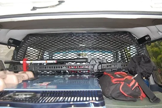

Continuing along with the Mods. I have added 1973Guppie's rack and barrier system to the 80. Brandon's wood shelf system got de-constructed and the rack went in.

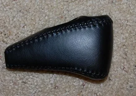

I have ordered a set of Aatlas1x's seather seat covers, steering wheel, leather shifter, and from CDan I have a new seat cushion, and new switch bezels to clean everything up and make it lookie nice:p
New steering wheel came in the mail via the FedEx guy this afternoon
Shifter in the same box too

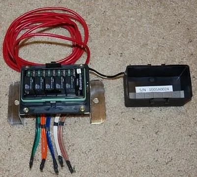

I also bought the fuse and relay box from slcfj62, now I can get the lights and fridge all running.

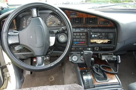

plz take a before and after pic of your dash. I am jealous. I want to do the same thing with a new wood grain or possibly carbon fiber dash kit.
I am actually replacing some of the old wood grain stuff back to the OEM grey and black:grinpimp:
I'm replacing all 4 door switch bezels and the console area where the shifter is, the wood grain stuff that is on there is pretty beat and faded and won't peel off. So, new plastic is going on
